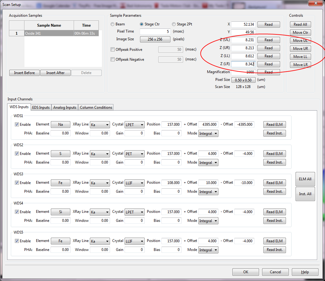

The latest Probe Image (v. 1.1.0.1867) now has an improved acquisition interface to compensate for tilted samples:
Check it out:
Contact Probe Software if you need the download and/or unzip passwords.
