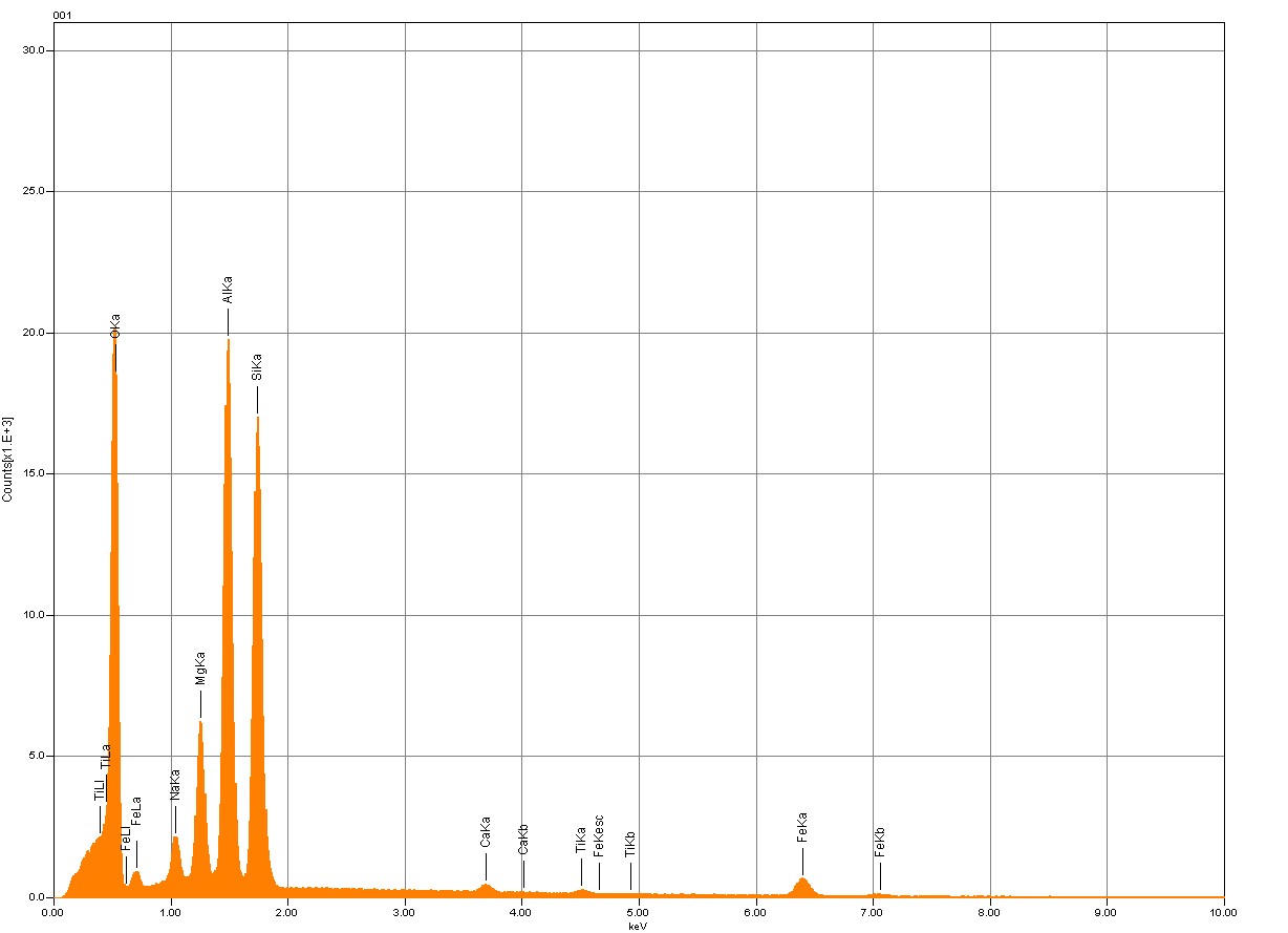

Hi Deon,
What about optical properties?  Is it uniaxial negative, length fast?  What about the ED spectrum?  Tourmaline can vary greatly in composition, but here is a spectrum collected on a typical schorl from the Fairbanks schist:
If you want to verify the presence of boron using LDE2, then you need to increase the dwell time, perhaps to 1 s, and bump the beam current way up, maybe to 200 nA or so -- tourmaline can handle it, though I'd defocus the  beam to 10 microns.
Brian
