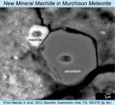

This isn't a standard (though if it could be synthesized it might be useful as an Al-Ti oxide), but it's a mineral named after our colleague Chi Ma at Cal Tech:
http://www.psrd.hawaii.edu/CosmoSparks/Feb17/machiite.html
He's now discovered over 1% of all known minerals...
