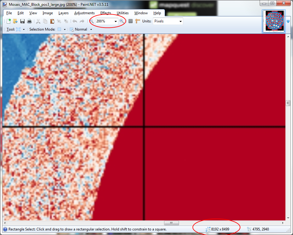

But in the meantime I would just keep increasing the pixel export size until you see the actual acquisition pixels in the exported jpg file.
For example this zoom from my mosaic at 8192 x 8499 pixels:
Thanks John, I basically just want a 1:1 acquired to exported pixel resolution, i.e. no mathematical operations performed on the pixels. Basically raw data but stitched to a mosaic. "Binning", e.g. combining 4 (2x2) acquired pixels into 1 would be OK, but only integer numbers for resolution reduction.

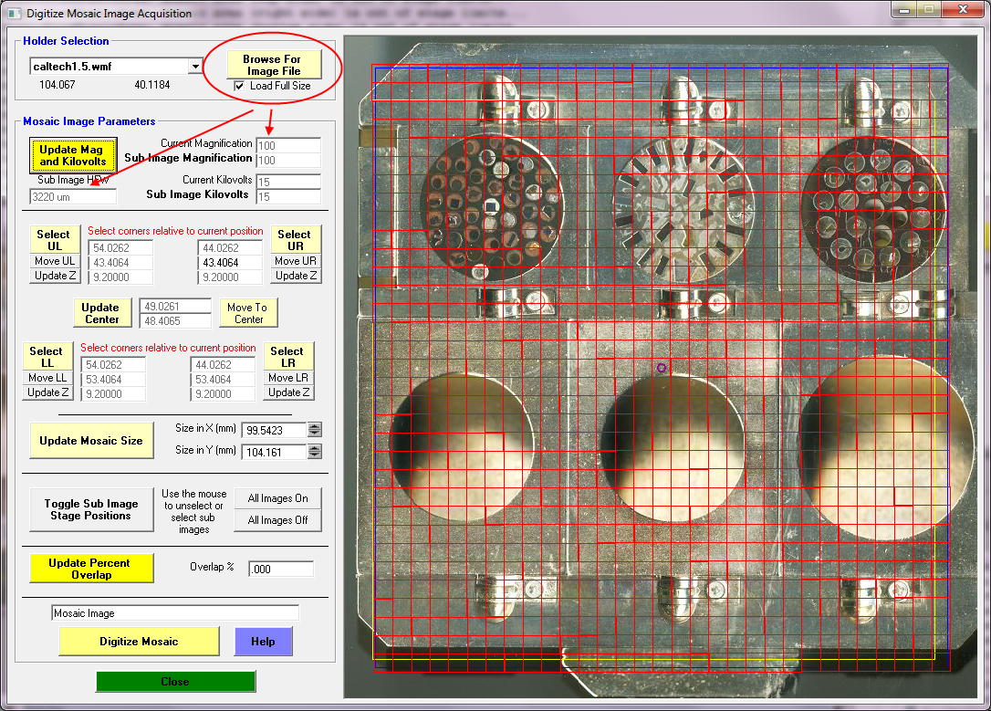

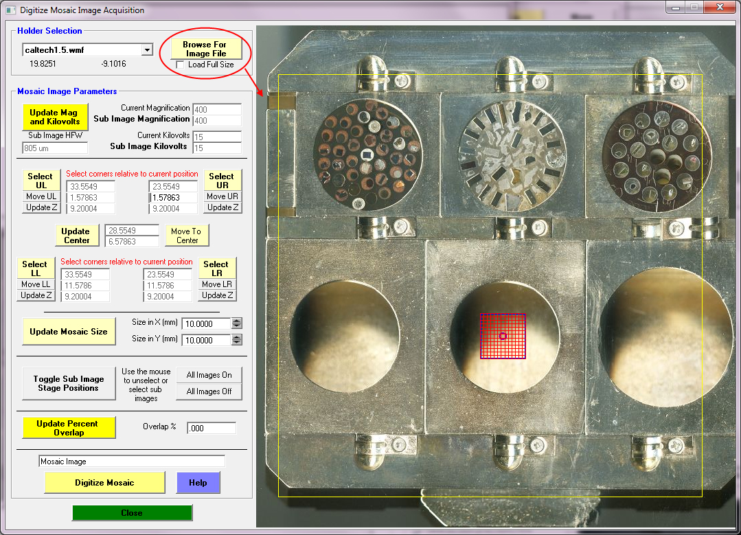

OK, I fixed the "non-corner" image calibration issue. Actually I did more than that- now the mosaic feature will work with any type of calibration file: 2 points, 3 points, corner or non-corner...
Here's the file you sent loaded as an image (note the sub image horizontal field width field):
And here it is loaded as a sub image with the default mosaic loaded (not that anyone would actually mosaic their entire sample holder!):
Next I'll implement a z-tilt correction for the mosaic acquisition, though for SE and BSE imaging it isn't really necessary.

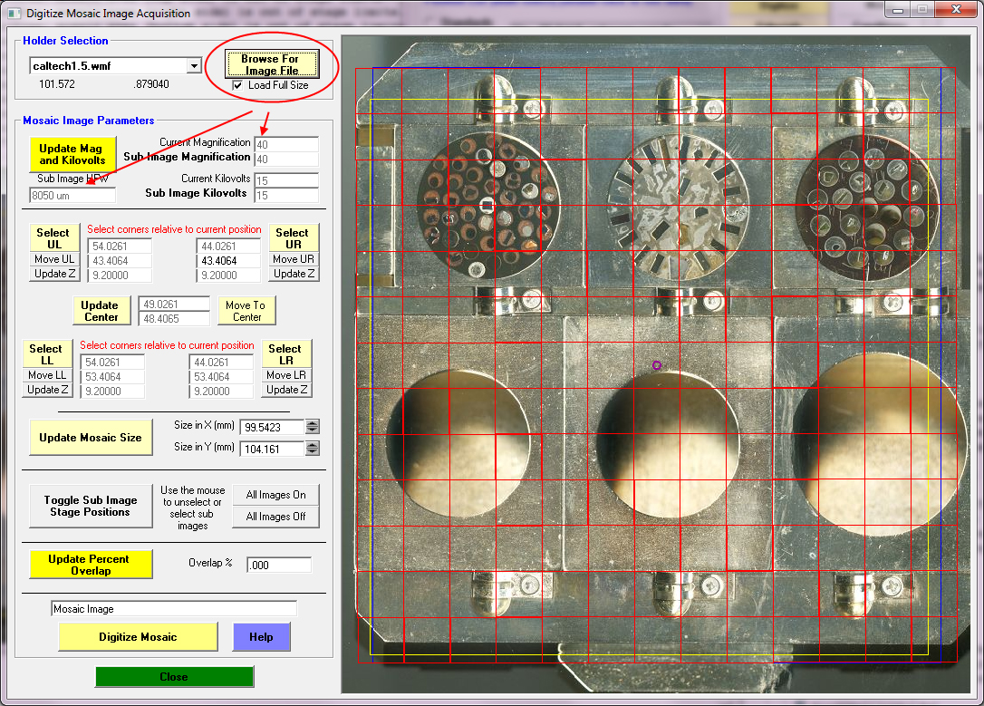

In fact now the software moves the stage to your image and automatically rescales the magnification automatically starting with the lowest magnification:
Of course then you can manually adjust the mag if desired:
#25
In fact, if anyone would like these full size scanned sample holder jpgs shown in the above posts, the JEOL one is from Ma Chi at Cal Tech and the Cameca one is from Karsten Goemann at Hobart.
They are attached below (remember: you have to be logged in as a member to see attachments!).
Finally, in addition the program now automatically moves to the proper Z stage position if using a three point calibrated image and it is loaded "full size".   8)

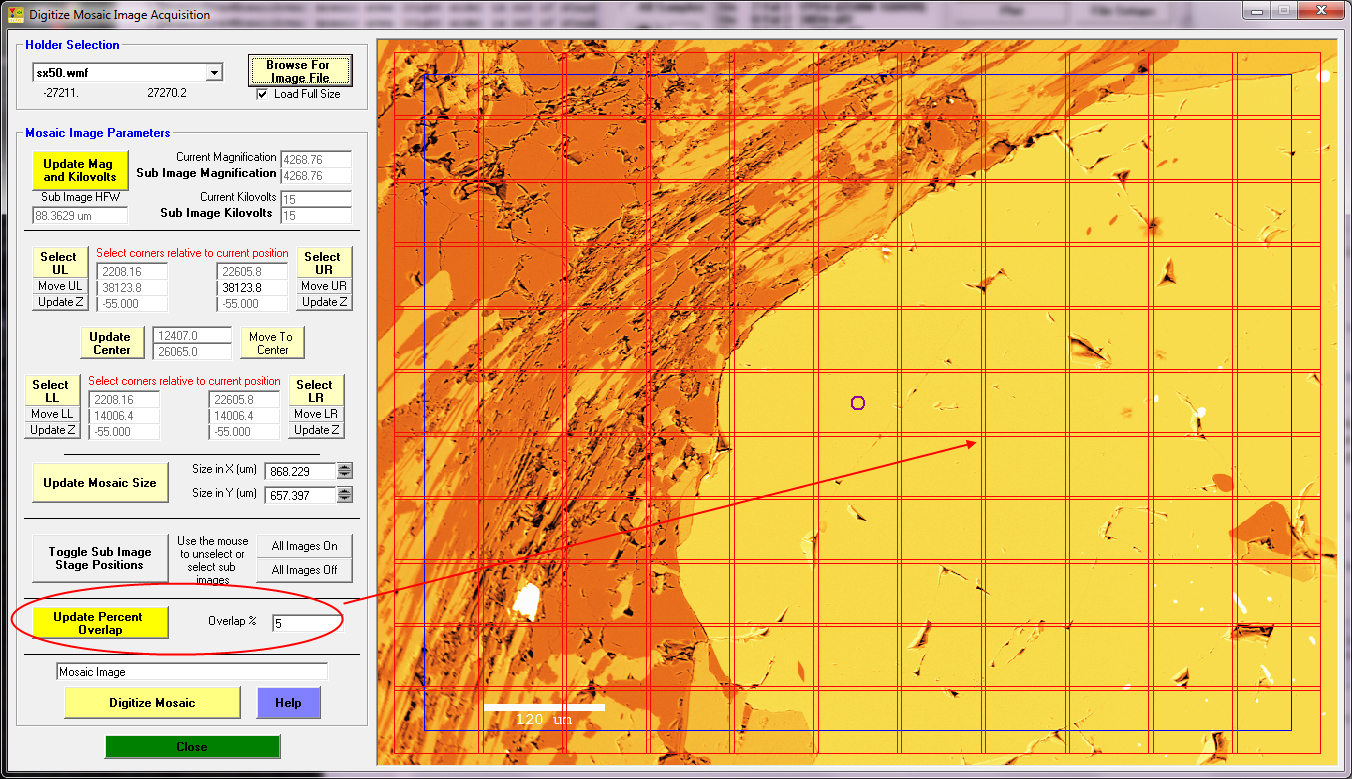

Has anyone tried to mosaic the sub images together by using the Overlap parameter and an "image stitching" software package (as opposed to relying on the PFE image beam scan calibration)?  There are many free packages out there but I have not tried any of them:
http://en.wikipedia.org/wiki/Comparison_of_photo_stitching_software
Anyway, if you do want to try this, here is the overlap set to 5%:
#27
Note that the Stage application was designed for confirming positions only, not acquisition. The Conditions, Sample Setups, File Setups buttons are for assignments only.
Now one might reasonably ask: why then is it there?  And the answer is: some people like to digitize off-line on an optical microscope and also do the condition/sample assignments off-line.
However, for image/mosaic acquisition in Stage, just set the instrument conditions in PFE or on the instrument console.  You can also use the Use Auto Brightness/Contrast checkbox to help compensate for variation in samples.

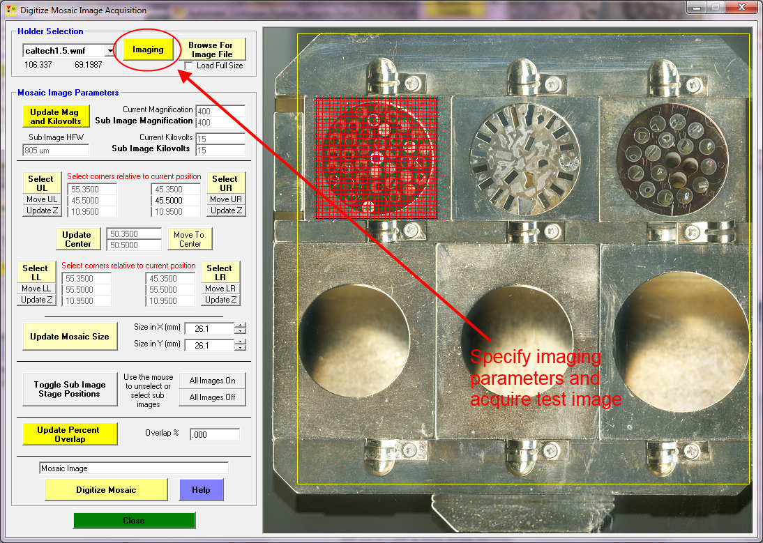

Following suggestions from Anette and Gareth I added a new button in the Stage mosaic imaging window as seen here:
This will be very useful to specify the imaging parameters for the mosaic acquisition and also acquire a few single test images for getting the brightness and contrast *just right*.
