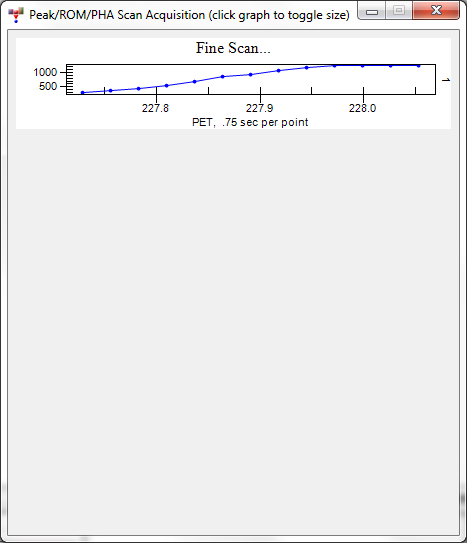

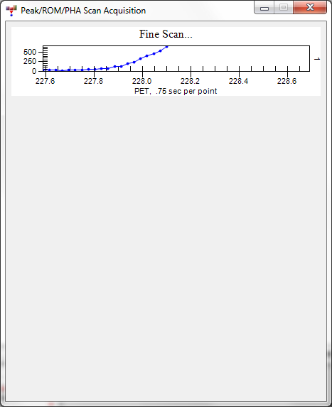

At Paul Carpenter's request I added a new keyword to the Probewin.ini file [software] section:
DisplayFullScanRangeForAcquisitionFlag=0      ; zero = expand automatically, non-zero = force full scan range
The difference can be seen here for, DisplayFullScanRangeForAcquisitionFlag=0
and with the flag turned on (non-zero), DisplayFullScanRangeForAcquisitionFlag=1
