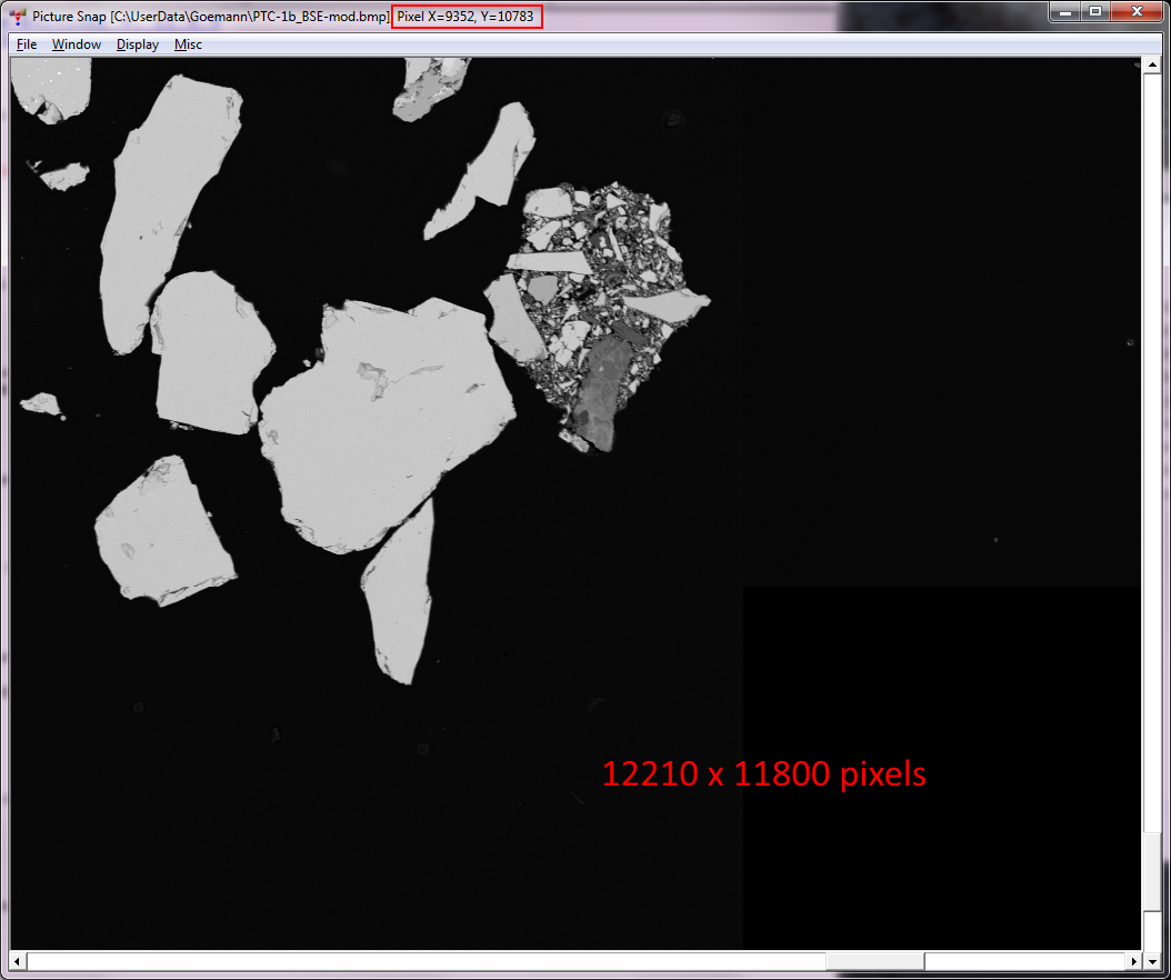

I figured out that we can load very large images into PictureSnap and see the entire image area at full 1:1 pixel resolution, by a tweak to the scroll event codes.  Here is an example of a 12210 x 11800 pixel image (from Karsten Goemann) displayed in PictureSnap:
There are still going to be possible memory issues on older computers with limited video memory, but most computers today have 1, 2 or 3 GB of video RAM and that is more than enough for images like this. The complete image file (a large mosaic) is linked here if anyone is interested in playing around with it (it's too big for an attachment, even when compressed!).
http://probesoftware.com/download/PTC-1b_BSE.png
Please update to Probe for EPMA v. 11.6.9 to get this new capability.
