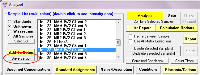

PS One other route is to export the element setups from the sample to the element database (SETUP.MDB) using this button:
Then from the Acquire! | Elements/cations | Element setup dialog load them into the new MDB file.  This will prevent any globals, such as your wavescan flag from the Probewin.ini file from getting into the new run, but I'm pretty sure it will still bring in the crystal 2ds because those are at the element abstraction level.

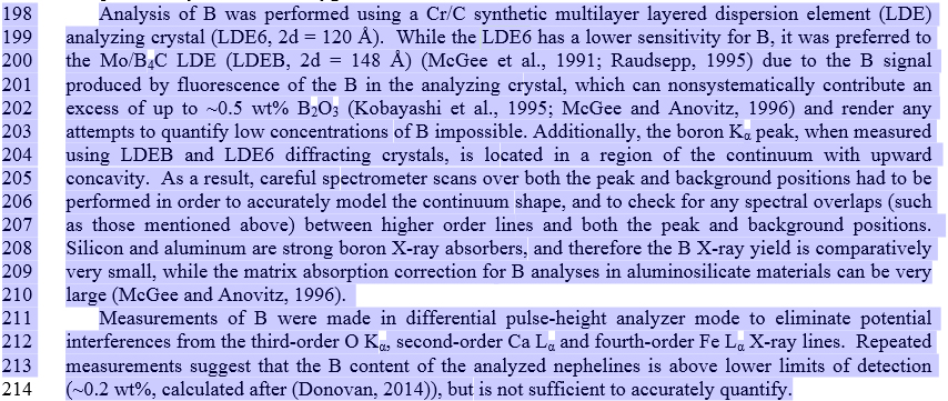

Does anyone have the nominal 2d spacing value for the LDE6 multilayer crystal? Also, if anyone can tell me what the PC/LDE crystals are each made of it'd be interesting to know. The only one I have info so far is PC1/LDE1 (W/Si). I'm looking for PC3/LDE3, PC2.5/LDEB, PC2/LDE2, and PC0/LDE45.
P.S. I understand the reason JEOL use a Roland circle value of 140 rather than 100 to calculate the 'mm' values is so that they are consistent for a given element across all three spectrometer types.
Quote from: Mike Matthews on December 03, 2015, 01:28:02 PM
I quote this from a preprint by Owen Neill:
http://www.minsocam.org/msa/ammin/AM_Preprints/5370McCloyPreprintFeb.pdf
