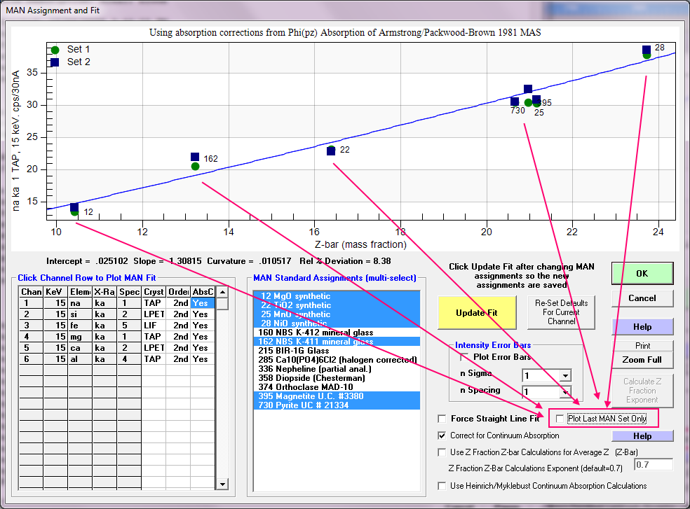

Could you help to find a solution to compare background levels (for MAN curve) of the same standard/element which was measured at the same conditions but in different sessions (different MDB).
I tried to upload the standard measuring from different sessions with standard way (acquisition/new sample/... way) but it is impossible? because  the system will be confused?
I wonder to use a set of identical data to obtain an average for routine measurements of main elements.
Also we can quick (just quality) compare a contamination of minor elements in the close samples which were measured in different sessions etc.
Thank you a lot.

Quote from: Rom on August 22, 2022, 07:52:39 PM
If you want to compare MAN background values from multiple runs you should be able to export those using the Output | Save User Specified Format Output menu from each run and compare them in an external program.  Note also from the Output | Save Custom Analysis Output menu there is a Format #8 (MAN) output menu that might also be useful.
You can also import standards into Probe for EPMA from multiple MDB files using the Acquire! window, New Sample/Setup button dialog, Load File Setup button, but you'll need to (completely) close Probe for EPMA, before loading the same standards from other probe runs. Hey, it's a feature, not a bug!   :)
Then once you have all the multiple (MAN) standards loaded from all your runs, you can open the Analytical  Assign MAN Fits menu and then *uncheck* the Plot Last MAN Set Only checkbox as seen here:
Or you could use "Drift.exe" and just search for a specific element or element/standard combination. It should tabulate all the intensities over all the mdbs with time stamps into a single xls spreadsheet. However, these intensities are not corrected for continuum absorption. Nevertheless, drift makes it easy to compare how the intensities vary from run to run over time.
