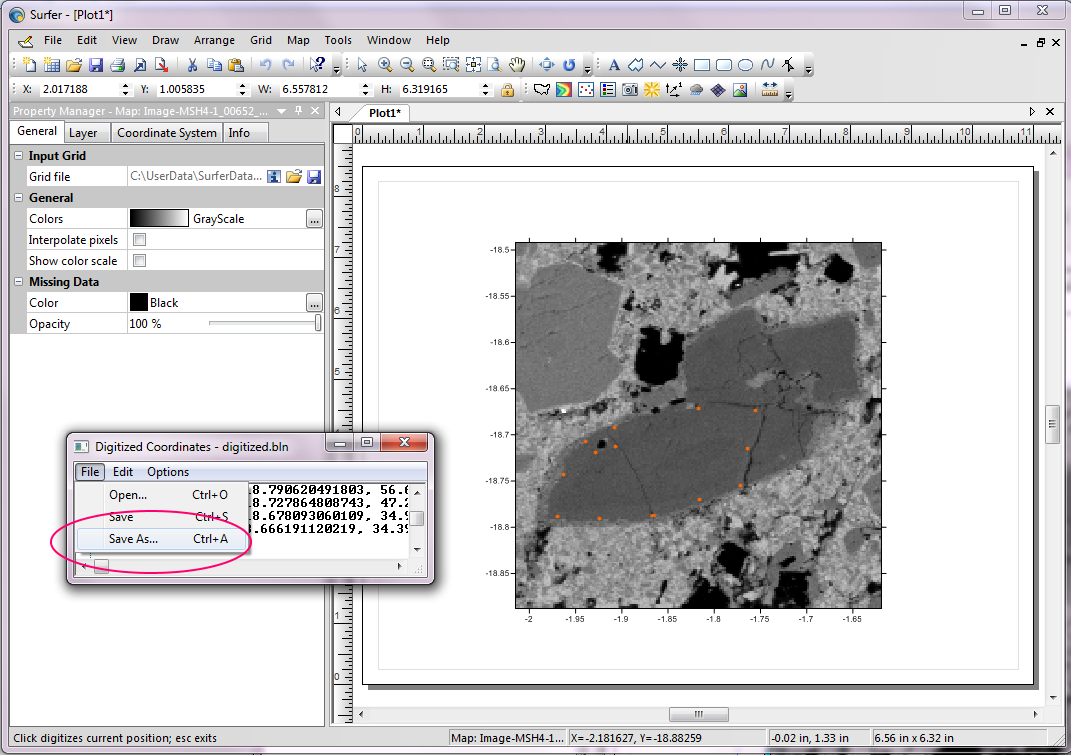

I recently modified the scripting output code to set the "Project Folder" for Surfer, to the folder of the currently open CalcImage project, when a Surfer script is being output.  This is done by editing the registry settings for the Surfer application "Project Folder".
The practical  benefit is merely that when running a "slice" or "polygon" feature extraction script, when the user clicks the Save As menu for the digitized slice or polygon outline, as seen here:
Surfer will now open the current CalcImage project folder by default.  As opposed to having to browse to the correct project folder manually.  Please update to 12.0.1 and you will obtain this small improvement to the CalcImage script processing in Surfer.

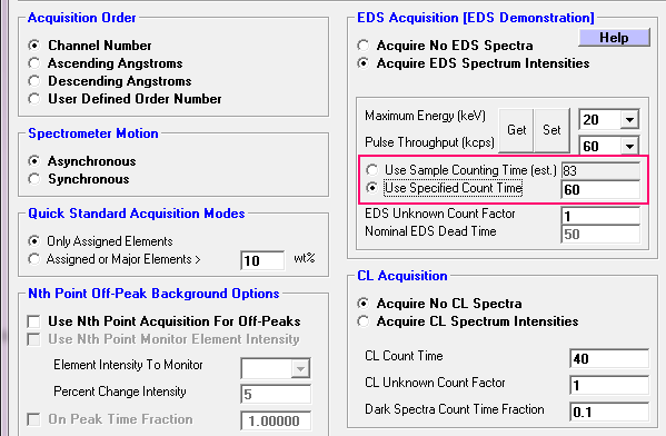

The latest version of Probe for EPMA now displays the EDS sample count time in the Acquire! | Acquisition Options dialog as shown here:
This is the amount of time the program calculates for the WDS (only) acquisition, with an adjustment for the EDS deadtime, so that both the WDS and EDS acquisitions will complete at the same time.  This is a dynamic calculation based on the specific sample configuration for each sample being acquired and is updated for each point acquisition.

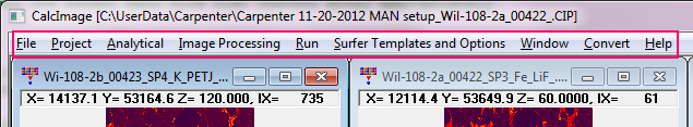

Basically it allows the use of the keyboard cursor (and Enter) keys to select menus. For example, if you hold the <alt> key down on your keyboard, the main menu in PFE shows that the menus have some letters underlined. The desired menu can then be selected by hitting that letter key while the <alt> key is held down. Once the selected menu is visible, simply use the cursor keys to navigate the menus and then hit Enter to select that menu.
Here is the CalcImage menu shown with the <alt> key pressed:

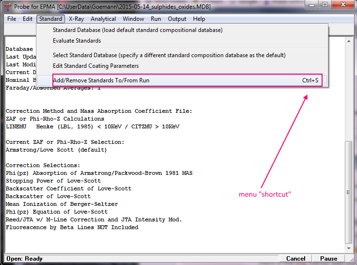

I should also mention that one can do some operations using the <ctrl> key "shortcut".  For example, you can open the Add/Remove Standards dialog by hitting the <ctrl> and s keys at the same time as seen here:
Look in the menus for other <ctrl> shortcuts.

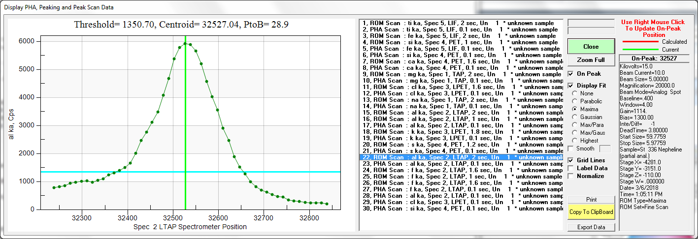

Paul Carpenter recently did some Probe for EPMA training at NASA JSC and he suggested we change the aspect ratio of the Display PHA and Peaking dialog for better visibility on small monitors and laptops, so we did:
He also suggested and we also made the default size of the peaking and wavescan "real time" displays larger...  grab v. 12.2.4 by updating from the Help menu as usual.

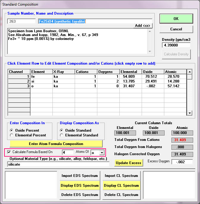

We've introduced several new parameters to the Probewin.ini file.
The first two parameters are in the [standards] section:
LoadFormulasFromStandardDatabaseFlag=0
LoadCalculateOxygenFromStandardDatabaseFlag=0
If these flags (as requested by Paul Carpenter) are changed to non-zero values then PFE will, from the New Sample Setup dialog from the Acquire! window (and even from the Automate! window), automatically load the specified formula basis from the standard composition database and/or the calculate oxygen by stoichiometry flag, based on the Display As Oxide" flag in the standard database (there is no use stoichiometric oxygen flag in the standard database, so we're using the display as oxide flag instead).
The formula basis in the standard database is described here:
https://smf.probesoftware.com/index.php?topic=71.msg6040#msg6040
