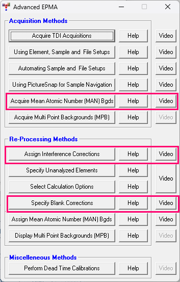

We've added three new video tutorials from our Probe Software YouTube channel:
https://www.youtube.com/@ProbeSoftware
to the Advanced EPMA "helper" window in Probe for EPMA (see under the File menu):
These include short tutorials how to acquire MAN background standards, perform quantitative spectral interference corrections and how to specify blank corrections for improved trace element accuracy.

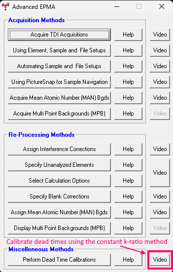

We added a link to the YouTube video on WDS dead time calibrations to the Advanced EPMA window (accessed from the Probe for EPMA File menu), using the constant k-ratio method:
More details can be found here also:
https://smf.probesoftware.com/index.php?topic=1466.msg11102#msg11102
