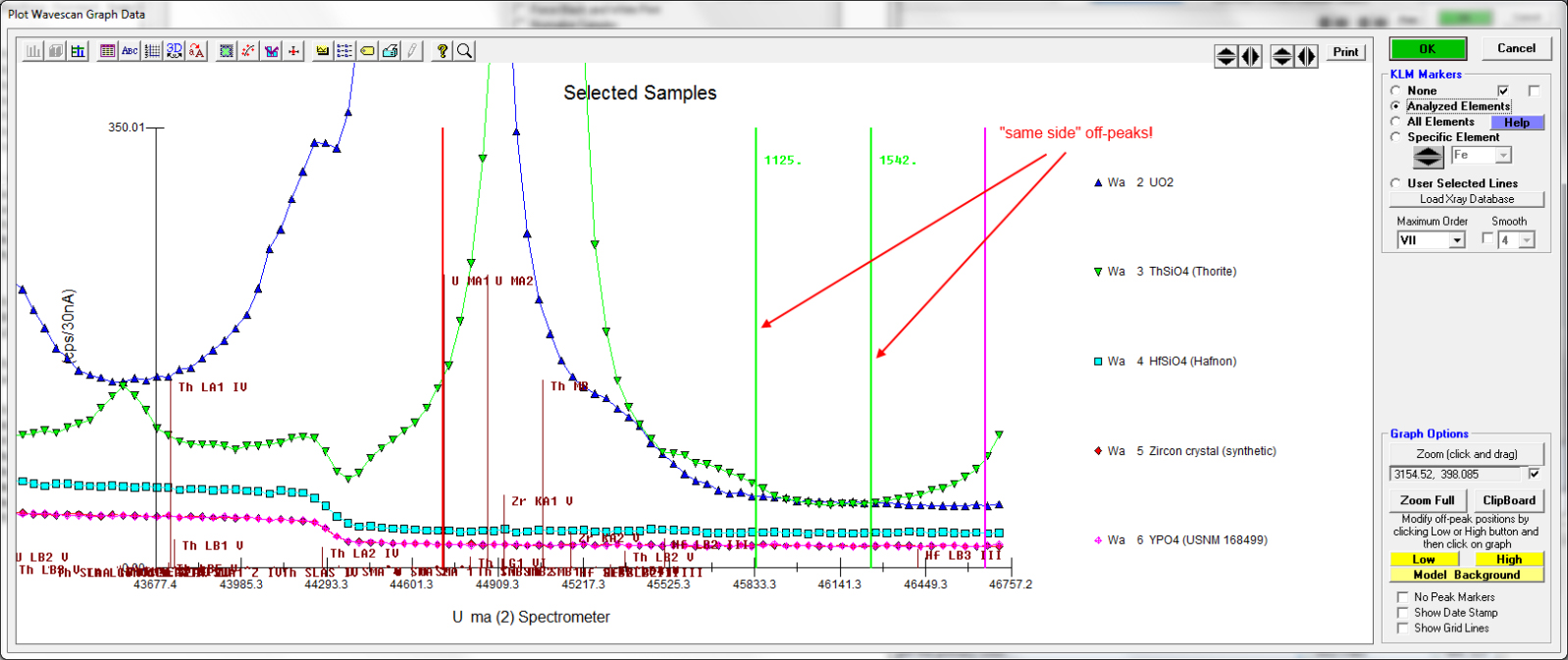

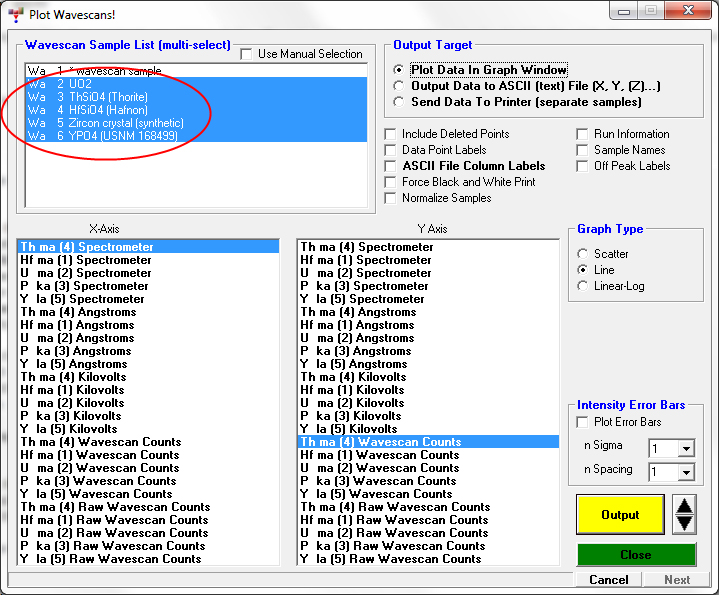

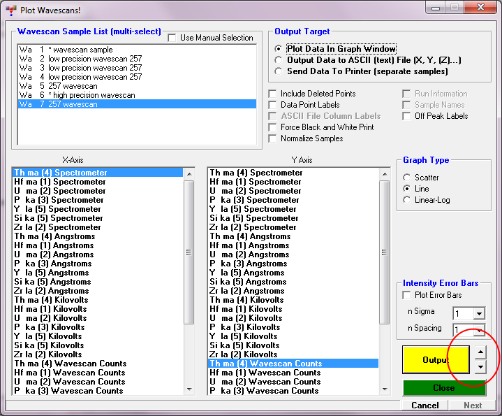

The new wavescan plotting routines are pretty nice for complicated backgrounds.  Here I've acquired wavescans on multiple standards for a trace zircon run:

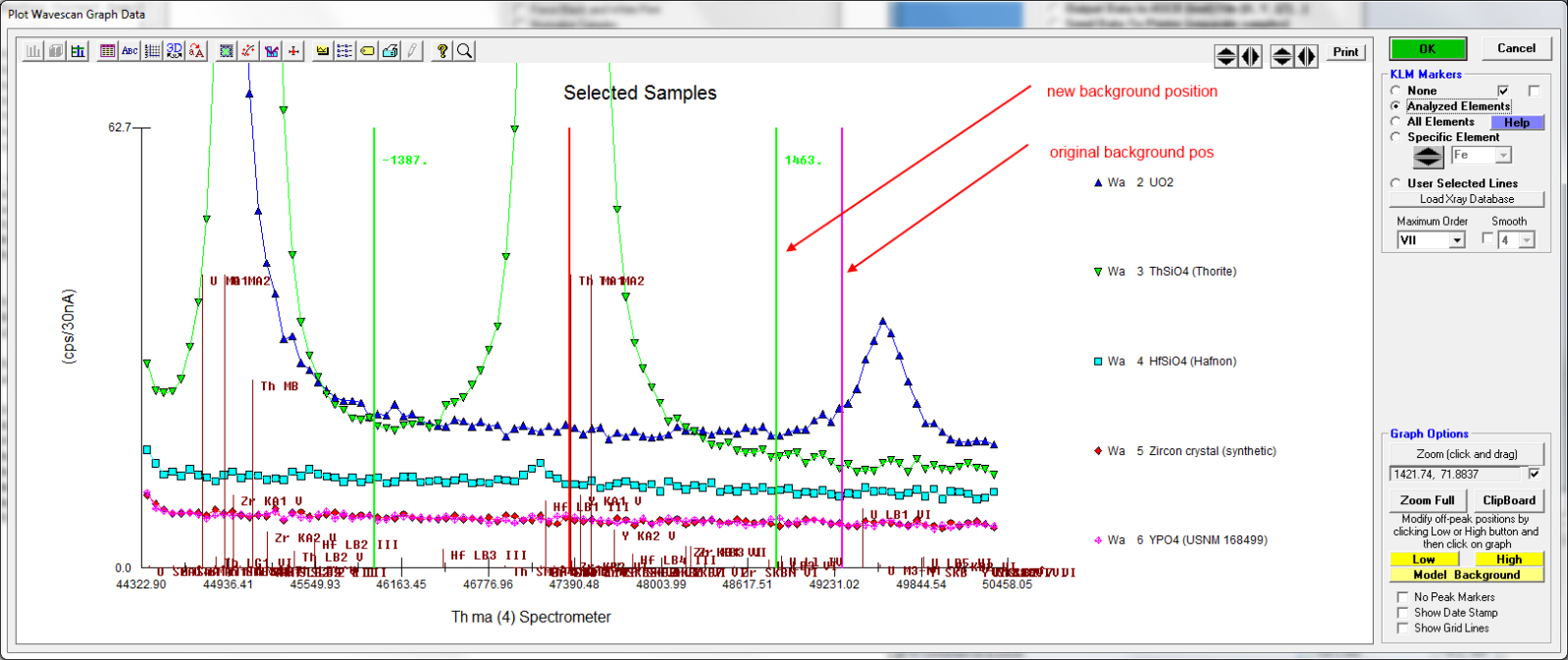

Plotting the Th spectrometer scans, note that I moved the high side off-peak to avoid a secondary peak in UO2:
Here is a situation for U Ma where I decided to avoid extrapolating across the Ar detector absorption edge and utilized "same-side" off-peaks:
This new feature really helps to sort out these complex situations.
PS The plot/output window for standards and unknowns is now in the Output menu, but please note that the User Specified Format output menu is probably the way to go from now on if you wan to export to a file.

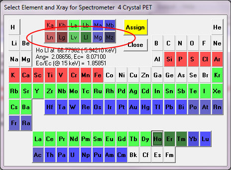

In concert with the new release of v. 11.0.6 which contains additional x-ray lines for acquisition and quantification, here is a list of all x-ray and MAC files and what they are for.
XLINE.DAT        X-ray emission line energies for Ka, Kb, La, Lb, Ma, Mb
XLINE2.DAT       X-ray emission line energies for Ln, Lg, Lv, Ll, Mg, Mz
XFLUR.DAT        X-ray fluorescent yields for Ka, Kb, La, Lb, Ma, Mb
XFLUR2.DAT       X-ray fluorescent yields for Ln, Lg, Lv, Ll, Mg, Mz
XEDGE.DAT        X-ray shell edge energies for all K, L and M edges
FFAST.DAT        MAC table for all emitter/absorber binaries for Ka, Kb, La, Lb, Ma, Mb
FFAST2.DAT       MAC table for all emitter/absorber binaries for Ln, Lg, Lv, Ll, Mg, Mz
Note also these additional files that are now distributed:
XLINE.TXT        All zeros text file for updating x-ray emission energy file XLINE.DAT for Ka, Kb, La, Lb, Ma, Mb (see CalcZAF.exe)
XLINE2.TXT       All zeros text file for updating x-ray emission energy file XLINE2.DAT for Ln, Lg, Lv, Ll, Mg, Mz (see CalcZAF.exe)
XFLUR.TXT        All zeros text file for updating x-ray fluorescent yield file XFLUR.DAT for Ka, Kb, La, Lb, Ma, Mb (see CalcZAF.exe)
XFLUR2.TXT       All zeros text file for updating x-ray fluorescent yield file XFLUR2.DAT for Ln, Lg, Lv, Ll, Mg, Mz (see CalcZAF.exe)
XEDGE.TXT        All zeros text file for updating x-ray shell edge energies file XEDGE.DAT for K, L-I, L-II, L-III, M-I, M-II, M-III, M-IV, M-V (see CalcZAF.exe)
Latest version of PFE v. 11.06 supports these additional x-ray lines in all acquisition and quant:

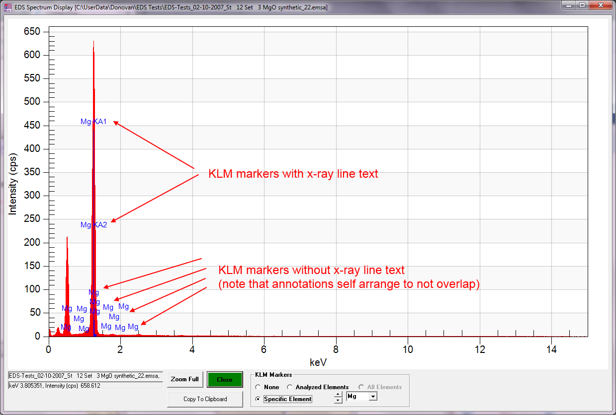

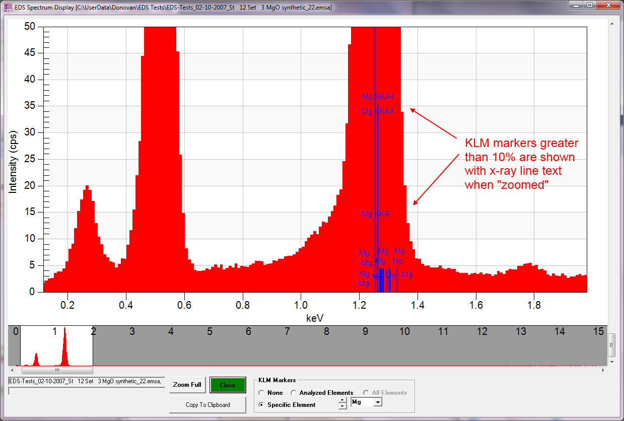

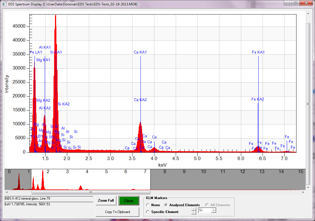

Gareth Seward has implemented new graphics for our EDS spectrum display along with some cool new KLM markers.
The new KLM markers are "dynamic" in the sense that the x-ray line text isn't loaded unless the marker height is more than 10% of the display height.  For example, here is a MgO spectrum with the KLM markers for Mg:
Note that only the highest KLM markers are labeled with the x-ray line text. And here is the same plot zoomed in a little more:
I think the new markers are much better looking and we don't get all that KLM "hash" at the bottom of the screen as seen here in these plots of NIST K-411 mineral glass:
The next idea is to add an "absorption correction" to the KLM markers to reflect the predicted intensities!

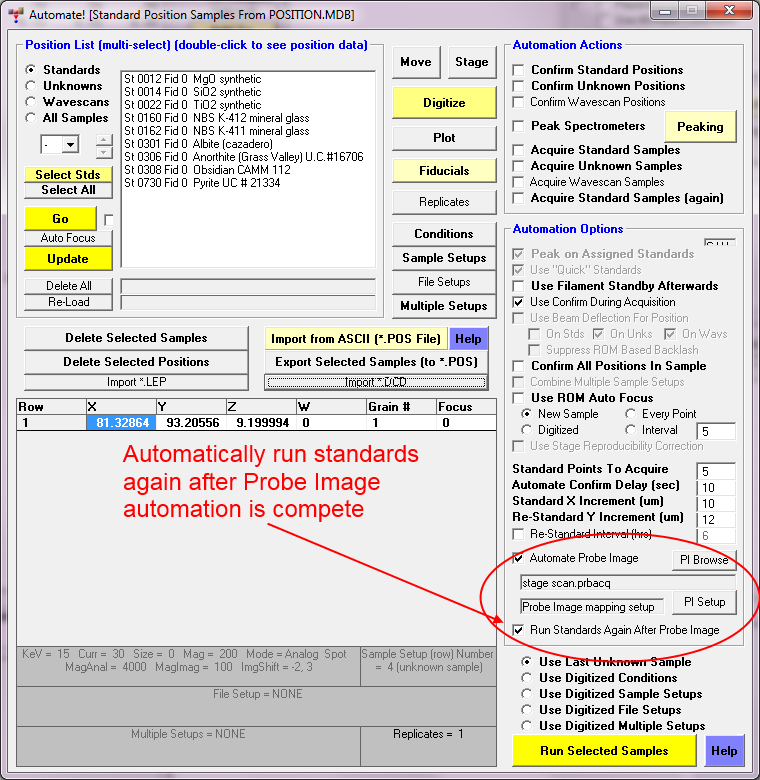

I just added the ability to automatically run an final set of standards from the Probe for EPMA Automate! window after the Probe Image automated map acquisitions all complete, as seen here:
So with the latest version of PFE once can now fire off and run the following automation actions with a single mouse click:
1. Confirm standard, unknown and/or wavescan positions
2. Acquire Standard, unknown and/or wavescan samples
3. Re-run the standards again for the standard intensity drift correction of the point analyses
4. Run Probe Image for automated x-ray mapping
5. Re-run the standards again  for the standard intensity drift correction of the x-ray maps
Pretty cool if I do say so myself!

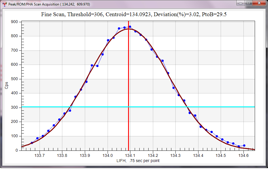

New scan graphics in the peaking/PHA scan graphics window starting in v. 11.1.6:
This should fix the problems reported with Windows 8 and "locked down" IT versions of Windows 7.  And I think it looks very nice too.   :)

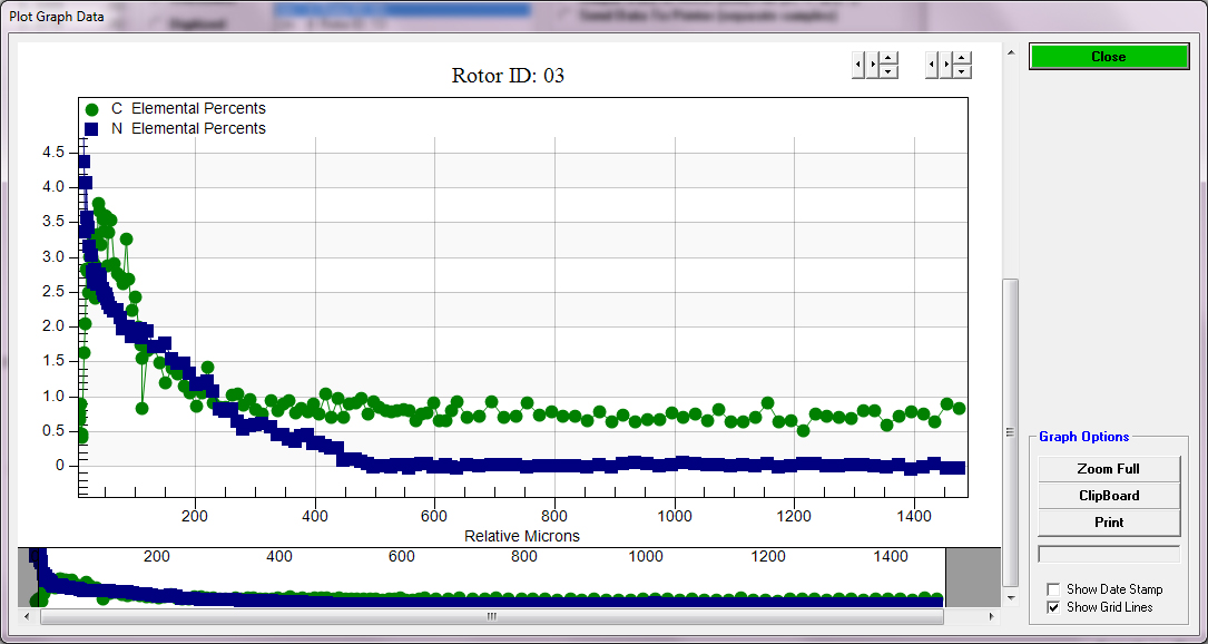

New plot graphics for std/unkns and digitized polygon areas:
