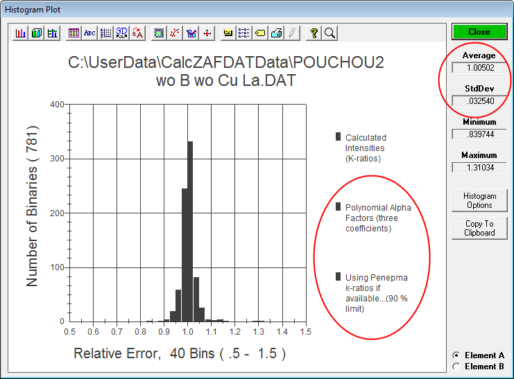

This is a error distribution from the Pouchou database (without B ka and Cu la) now with the 52.5 degree k-ratios included.
As you can see it is even better than before (smaller variance).  I should also point out that a significant portion of the above variance is due to two low over voltage binaries as seen here:

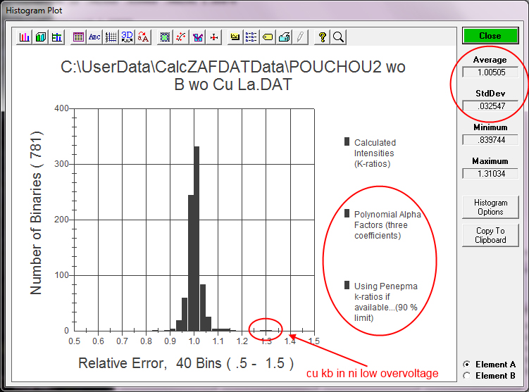

Problematic k-ratio errors (< 0.8 or > 1.2)
  Line             ConcA   ConcB     TOA      eO      Uo   K-Exp   K-Cal   K-Err
715   Cu ka in Ni .565000 .435000 40.0000 10.1000 1.12485 .558000 .719701 1.28979
722   Cu kb in Ni .565000 .435000 40.0000 10.2000 1.13598 .549400 .719902 1.31034

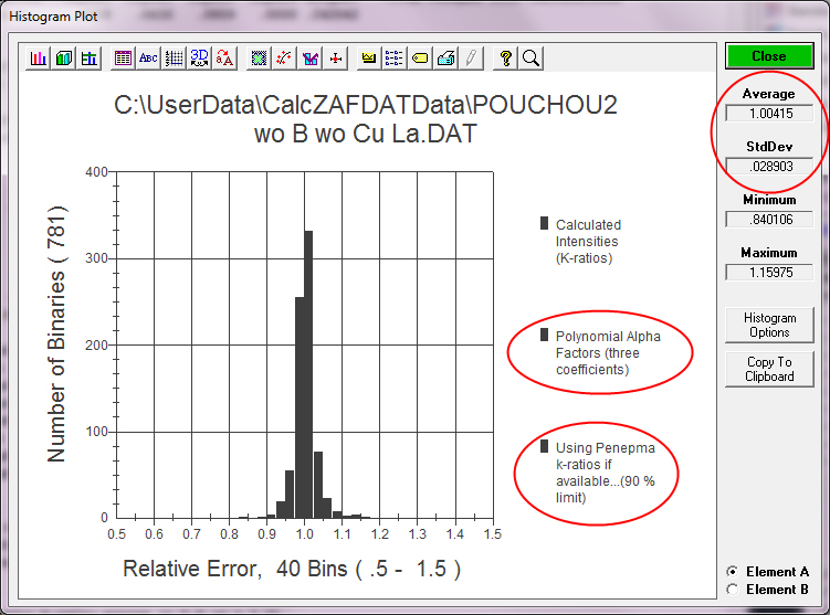

But this can be improved from increasing the modeling time from 3600 to 7200 sec per keV.  See the last error plot in this post calculated at 7200 sec:
http://smf.probesoftware.com/index.php?topic=47.msg2680#msg2680

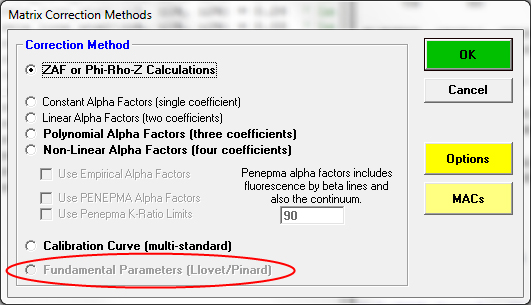

On a related note, Xavier once said to me: why don't you implement a fully rigorous fundamental parameters matrix correction in your software. And I replied: give me the equations and I'll do it!  I even have a place holder for it in the software already:
As soon as you guys send me the code I'll implement it with full attribution!

Quote from: Probeman on July 21, 2015, 12:31:54 PM
Interesting idea, you just need to solve the electron transport equation in the sample and calculate the x-ray generation from the electron distribution (energy and position) to get the phirhoz curve. The work of Rex and Dapor should be a good starting point.
Regards,
Hendrix
Quote from: hdemers on July 22, 2015, 03:23:15 PM
That sounds simple... not!    :-\
In any event here is the Pouchou database re-calculated with some 75 degree k-ratios extracted and added to the matrix.mdb file:
Basically the same results, just very slightly worse in the 4th or 5th decimal place. Again the main problem here are the low over voltage Cu Kb in Ni measurements as noted in the image above. I will be adding higher precision MC calculations to the matrix.mdb file shortly which will take care of this for many elements.
I am pleased to report that after re-calculating the Ni-Cu binary at 7200 sec per beam energy (20 hours per binary for 11 binary compositions or 220 hours), the Pouchou database calculated errors from using the Penfluor/Fanal derived k-ratio for alpha factor fits looks even better (error variance down to 2.9 % compared to 3.2 % from the previous post above), as seen here:

I've recently updated the matrix.mdb file for fast Monte-Carlo matrix corrections.  The new binaries include additional light elements, actinides and rare-earth binaries, particularly Ce, La, P, U, Th and Pb.
See the link here for a list:
http://probesoftware.com/download/Calculated%20Matrix%20Binaries.txt

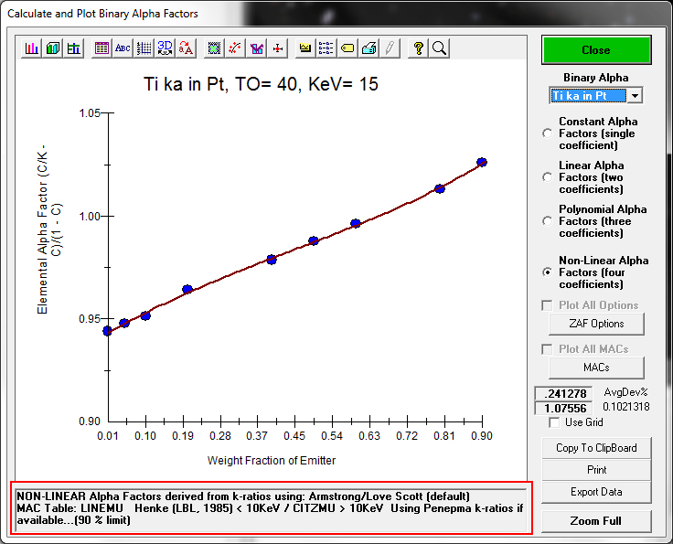

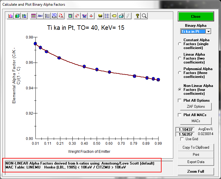

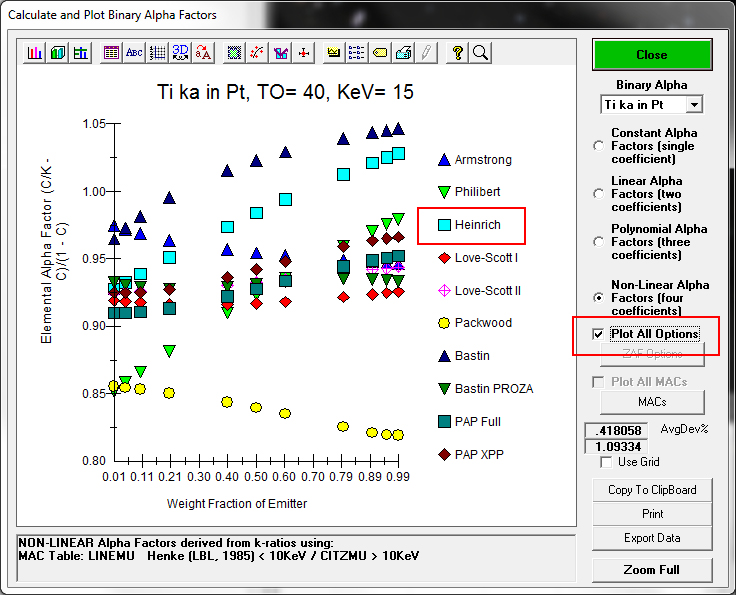

Julien Allaz asked me to calculate the Ti-Pt binary using Penepma (Penfluor/Fanal) and I've finished part of the calculation (Ti Ka in Pt)... here are the results:
Ti Ka in Pt calculated using the default Phi-rho-z from Armstrong/Love Scott/Reed with non-linear alpha factors:
and here is the same binary, but using Penepma derived k-ratios:
Interesting that both both methods give about the same absolute correction, a small fluorescence correction, but with opposite slopes!   However, it should be pointed out that the different analytical methods don't agree very much either, and they are shown here all using the same fluorescence correction!
Most surprising to me is that the old Heinrich method appears to yield the best agreement with the Penepma Monte-Carlo method!  Luck or skill?
