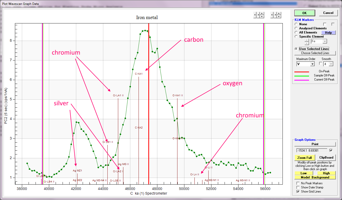

As you can see from previous posts in this thread I've tested measuring carbon in pure Fe using a graphite standard for carbon, MAN backgrounds and a TDI correction for carbon contamination.

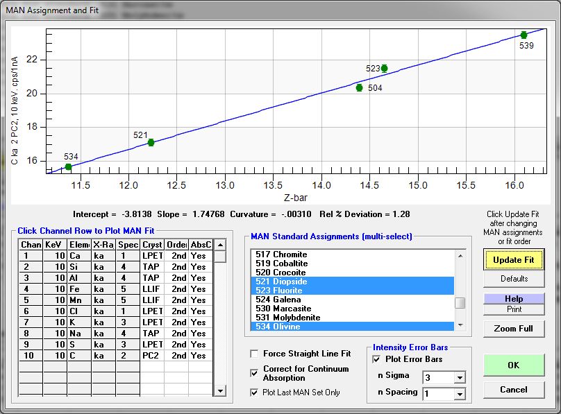

Then there is the issue of peak shape for carbon Ka...   Maybe for scapolite you should use a pure siderite (FeCO3) standard as your carbon standard (by assuming carbon concentration by stocihiometry) and coating both the carbon standard and unknown with 15 nm of Ag.   You might want to do some wavescans to see how the peak shapes look on your unknown and standard.

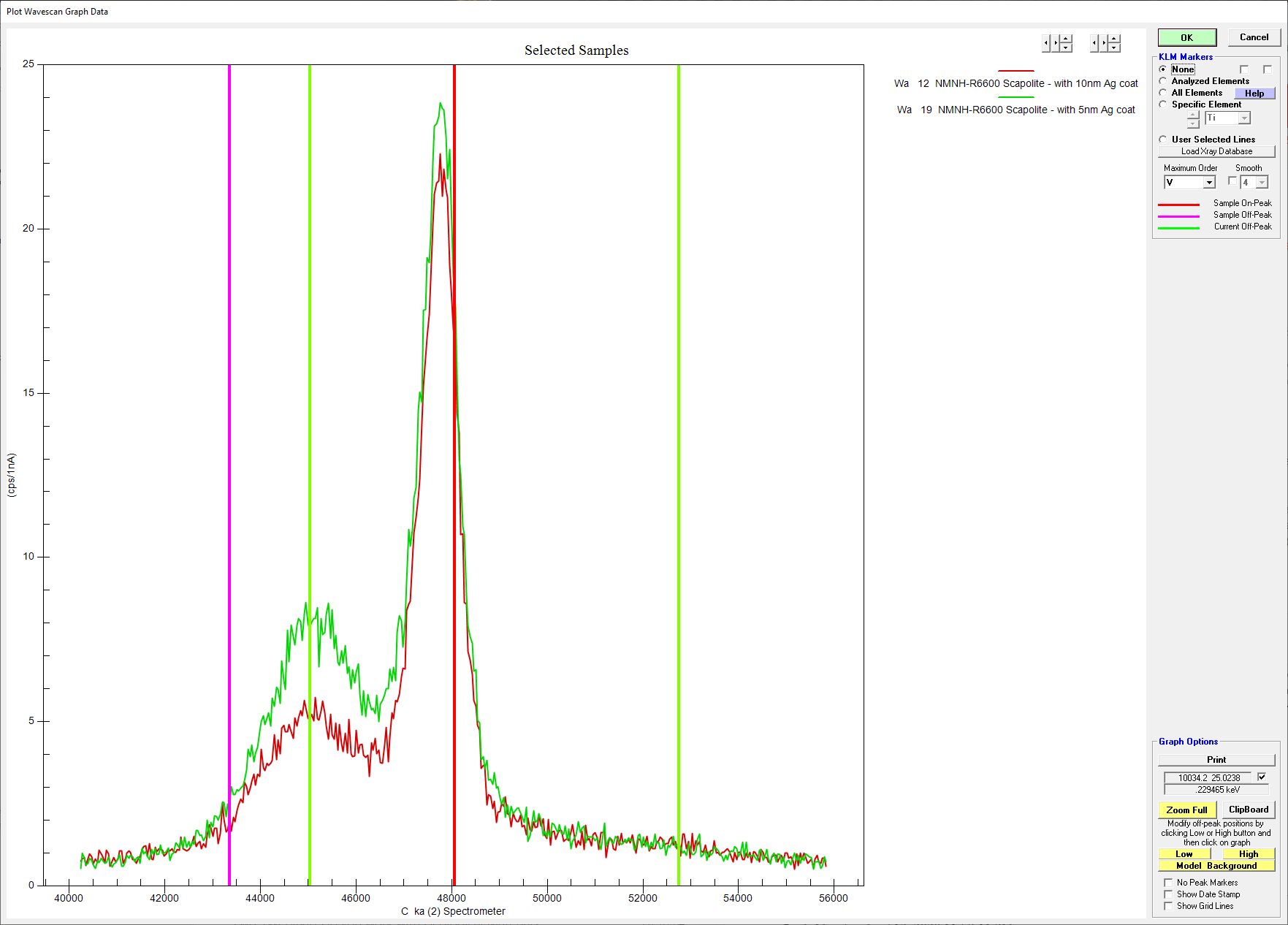

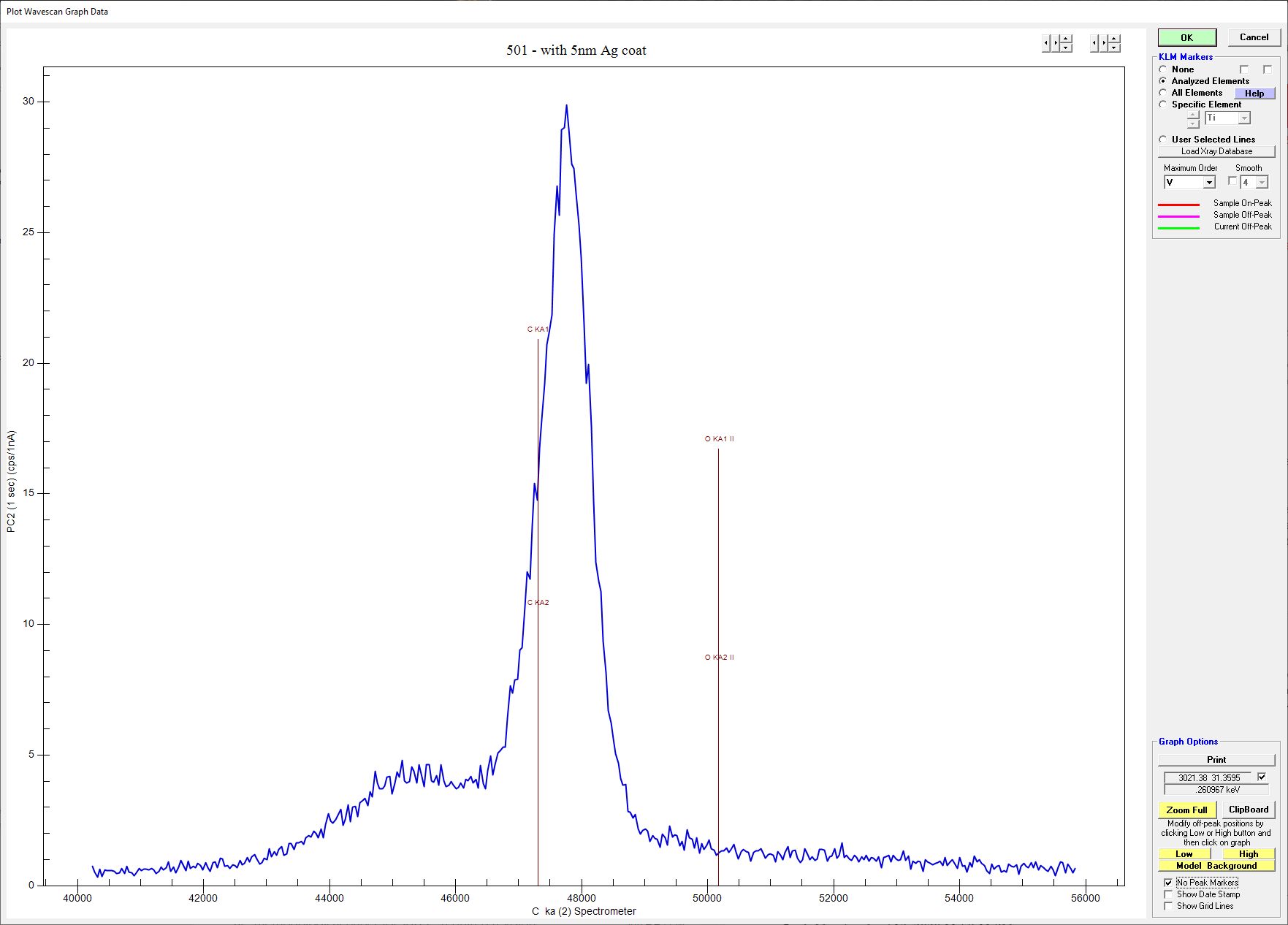

In regards to the coating, I tried both 5 and 10nm of Ag coat.  I get ~1.5 times the counts with a 5nm coat on my scapolite NMNH standard (see wavescans below – ignore the fact that my PC2 xtal is wayyyy out of alignment, that major peak is Oxygen, the carbon peak is the small broader hump to the left of it).
The 5nm seemed to work fine with regards to negating charging so I ended up going with that. To get around having to use coating corrections between standards and unknowns, I ended up finding an older Astimex mineral mount laying around so polished the carbon coat off and coated it in Ag at the same time as the unknowns and NMNH scapolite mount.  Despite me thinking I polished the life out of the samples, getting the samples to the coater quickly and keeping it all under vacuum, I had real problems with C still being measured in minerals that should have none.  Wavescan below shows C peak in standard 501 albite.

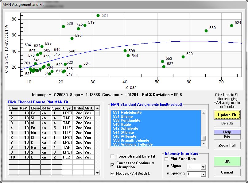

Some of my measured C in standards are probably interferences, as seen in MAN fit diagram below for C. I am sure some of it is residual carbon coat/adsorbed carbon to the sample surface, which I guess isn't unexpected.  If I concentrate on the lower Z end where scapolite will plot (mean Z ~11.6), I can refine the fit to something OK but am not left with many data points (refined MAN fit plot below).  I am hoping that these standards left perhaps don't have as much residual carbon on their surface and this correlation is real and mostly due to mean Z.  Using the MAN vs traditional, I get ~10% higher carbon values on unknowns so perhaps there is still some other extraneous C contribution.

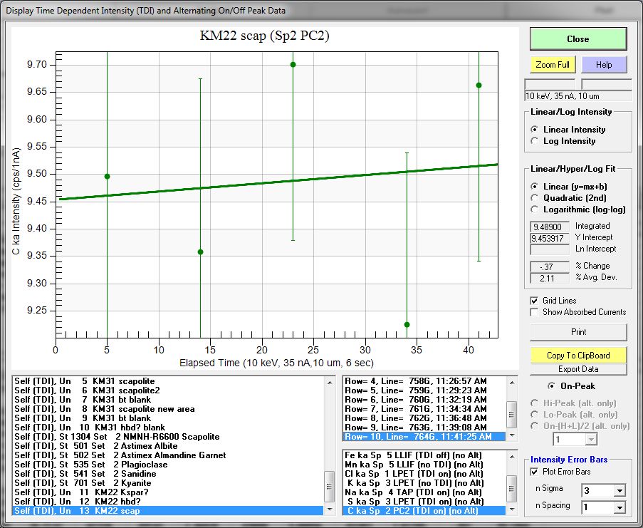

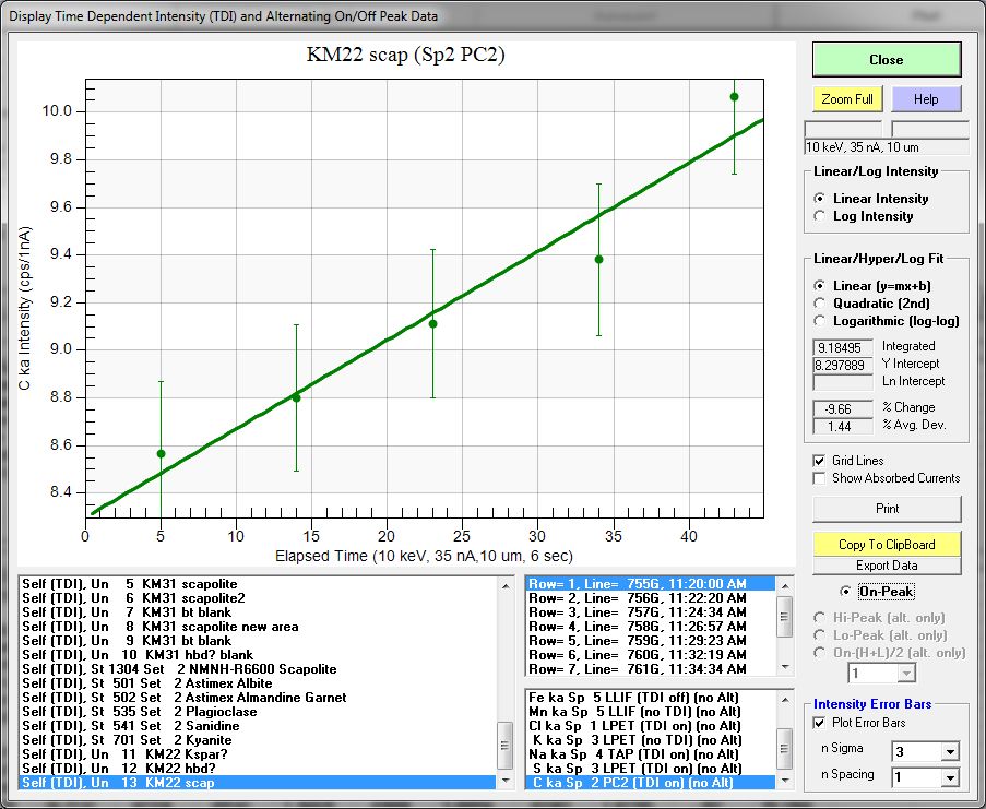

Despite this I ended up running a standards and unknowns at 10kV/35nA/10um defocussed beam.  Both standards and unknowns had TDI enabled. Standards were collected with traditional background methods, and unknowns both with and without MAN for comparison.  TDI plots on unknowns were variable, some spots showing C increase which might be expected, some showing no correlation at all (attached images).
I ended up using NMNH R6600 Scapolite as my Carbon standard for the unknowns.  I tried pure graphite, calcite, dolomite, and all give me extremely high C measurements when treating NMNH R6600 Scapolite as an "unknown" (reported CO2 is 2.5 wt%, returned values range from 7-10wt% when using dolomite/calcite/graphite).
Given the inherent "background" level of carbon, I decided to utilise the blank assignment.  For the levels of C I am measuring in my unknowns (<3 wt% C), applying this correction cuts my C concentrations in half, from ~2.5wt% without correction to ~1.2 wt% with.  This is due to the quite large "background" contribution and the low amount of counts we are dealing with.

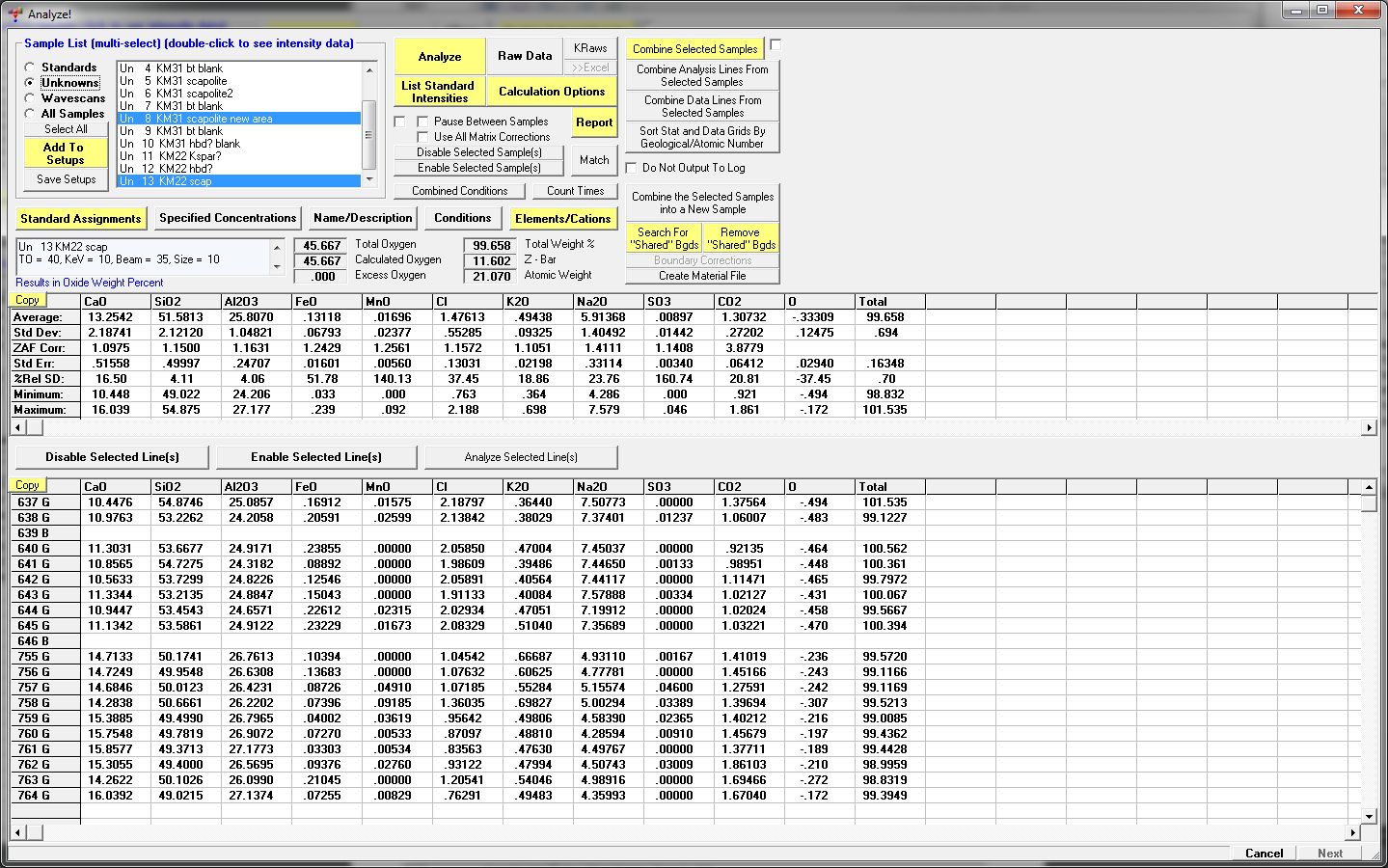

So I am at the point where I can get some analyses on scapolite with OK totals and varying C from sample to sample (see Results image of combined samples KM31 and KM22 below), but have no real confidence if those C contents are real or not.  What I need is more scapolite standards I think to do more cross checking, it's all a bit circular at the moment.

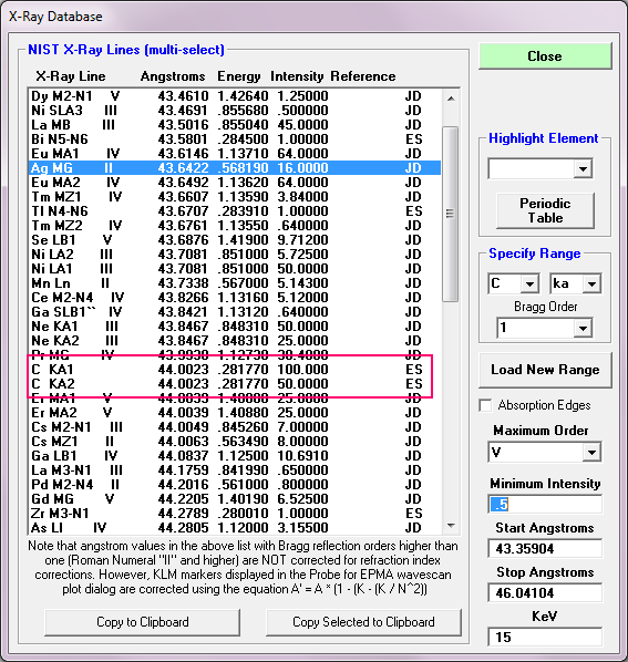

Here was my addled brain thinking of analyzing carbon containing minerals, which made me think of carbonates, and that made me think of Ag coating, which people have used to limit beam damage effects when measuring cations in carbonates.  But not for measuring carbon!
Turns out there is a close interference from an Ag MG (2nd order) emission line right beside the carbon peak... can that be it (above, taller thinner peak on the right) in your wavescan?  Remember this x-ray table is uncorrected for refraction, so please plot up the Ag and Cr KLM markers in the wavescan plot.  It could be that the Ag MG II is underneath the 2nd order oxygen peak...
I think that is at least part of the reason for your "carbon background".  If I remember from my carbon in Fe measurements from last year, I believe I finally used a thin Cr coating on my samples and standards. Cr has a lower MAC than an Al coating and no interferences.
Next time before I suggest a coating material, I'm going to check the darn x-ray database first!   :-[

I found an old carbon k-alpha scan from 2013 and I think that is when I realized (and subsequently forgot!) that an Ag coating was not going to work for carbon analyses:
In fact there is also a small Al (high order) peak in there as well, but far enough away from the carbon peak, so I think one could use an Al coating.
Another lesson here is that one must plot a refraction corrected wavescan plot for these higher order lines because they move around compared to their nominal sin theta positions.  You know what I should do is add a checkbox to display the KLM markers *without* the refraction correction just to show the effect.
No problems! If I was doing due diligence I probably should have checked for any interference of Ag on C anyway. Having said that, looking at my wavescan I don't see any Ag peak like what you document below which is quite large! Was that with 15nm? Perhaps I will have to go back and check again. Its a bit complicated with my PC2 xtal being so far out at the moment, I have to guesstimate where the peaks should be. Unfortunately it will have to wait a few weeks now before I have any more spare time to investigate the C further.
