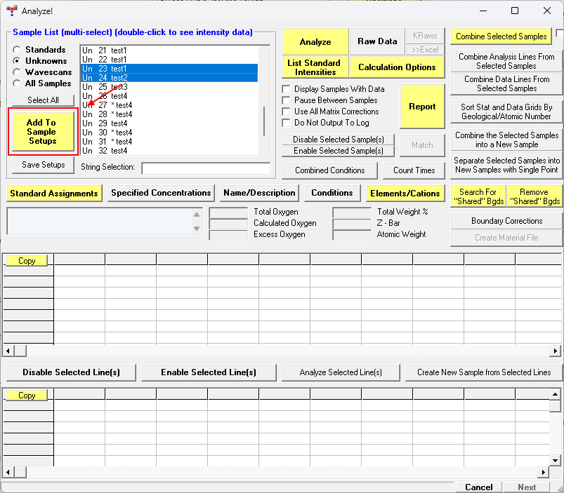

In your case it seems that you want to use the original 15 element general setup (edit:for the standards)? in which case, create a Setup for the standard data collection in the same way you did for the unknowns (edit: setups Amphibole and Plagioclase):
In Analyze! select an appropriate unknown with the setup that you want (i.e. the general setup you used to acquire the original standards), then click 'Add to Setup'. Now, select your standards and click the 'sample setups' button. Select the newly created 15 element general setup, and apply this to the standard positions.  Now when you run the data collection from Automate! using 'Use Digitized Sample Setups', Standards, Amphiboles and Plagioclase will be collected with the appropriate setup. Note that to collect Standards and unknowns in the same Automation you will need to use the 'All Samples' display option for the Position List so that you can select Standards AND Unknowns together.

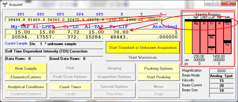

The Automate! window time estimation percent is great for checking the entire automation time estimate accuracy which on my Sx100 is usually within 5% or so.  But you can also check the single point time estimation accuracy.  Basically when the counting on the spectrometer(s) finishes, you'd like to see the yellow elapsed time bar level with the element gauges as seen here:
In this particular example, the Cr Lo peak measurements still has a couple of seconds "on the clock", but all the other elements have finished.

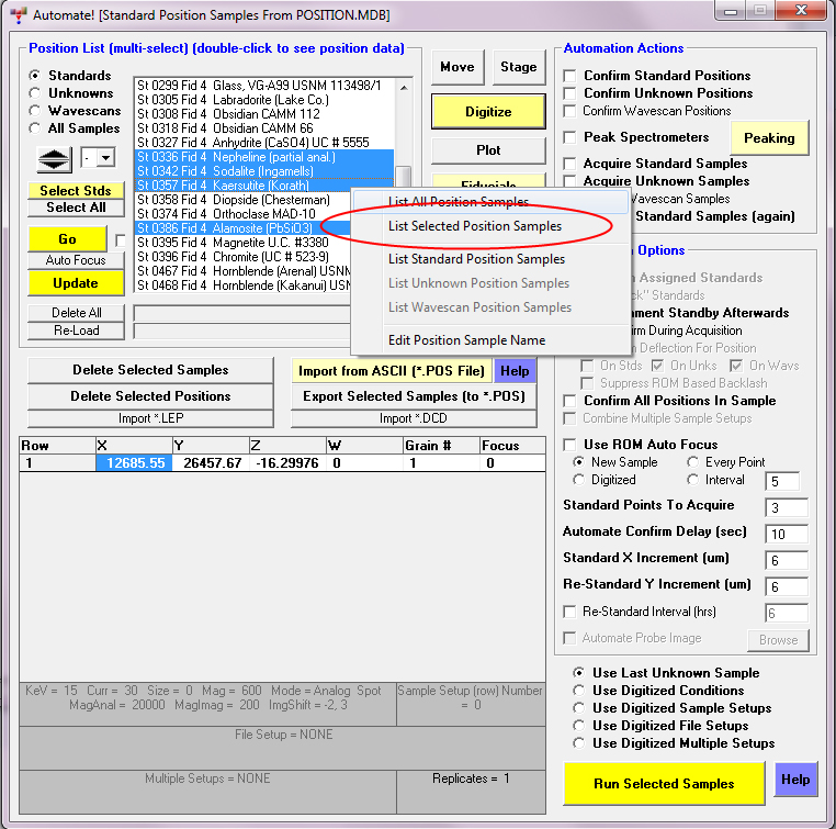

Pretty sure you are missing something as many of us have been using this feature almost everyday for years!  You might want to triple check your sample setup assignments!     ;)
This could help: note the Run | List Selected Sample Positions menu in Automate which you can access using a right click on the position sample list as seen here:
This will list all or selected position samples and any sample setup assignments if assigned.

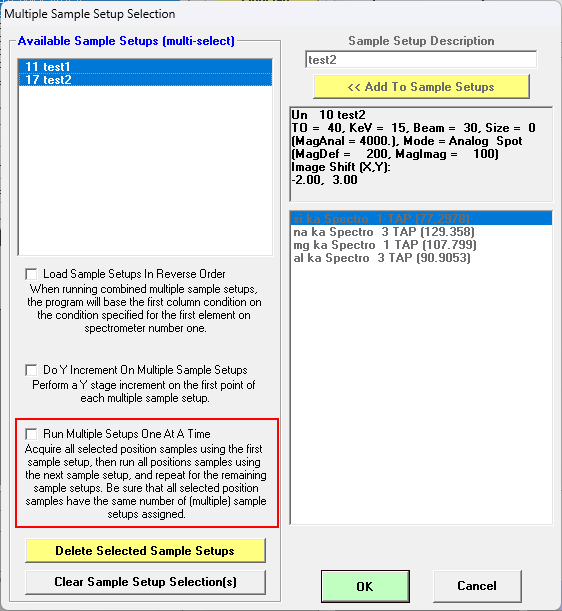

I just wanted to make a comment about the "Run Multiple Sample Setups One at a Time" feature in the Probe for EPMA Automate! window under Multiple Setups.

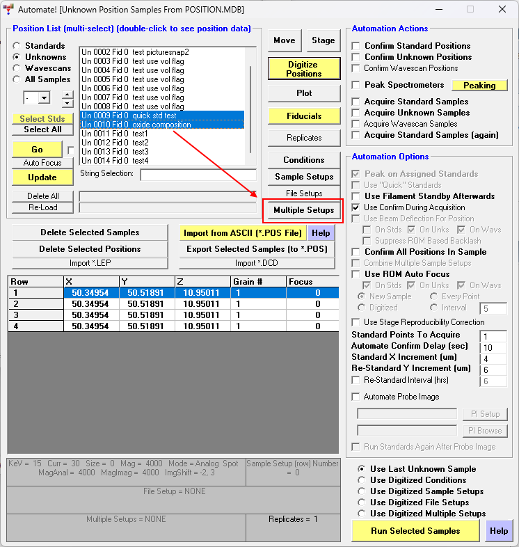

To utilize multiple sample setups per position sample, you first open the Automate! window and digitize the positions that you want to run multiple sample setups on.  Note that sample setups can be added to your sample setup list using the Add To Setups button in the Analyze! windows as described here:
Then, from the Automate! window, you select the position sample(s) that you want to run multiple samples on:
Then you click the Multiple Setups button and select the sample setups that you want to run on those position samples:
Now, there are two ways that you can run these multiple samples setups on your positions samples. The default is to run all the samples setups on each position sample.  Then it proceed to the next position sample...
"Run Multiple Setups One at a Time" is NOT checked:
position sample 1 (5 points)  ---->  sample setup 1
position sample 1 (5 points)  ---->  sample setup 2
position sample 1 (5 points)  ---->  sample setup 3
position sample 2 (5 points)  ---->  sample setup 1
position sample 2 (5 points)  ---->  sample setup 2
position sample 2 (5 points)  ---->  sample setup 3
etc.
This is the mode one would usually utilize when running say multiple accelerating voltages on thin film samples so thin film composition and thickness can be calculated using the method of Pouchou in the STRATAGem or BadgerFilm applications:
https://smf.probesoftware.com/index.php?topic=111.0
But by checking the "Run Multiple Setups One at a Time" checkbox, Probe for EPMA will instead run all the selected position samples in the Automate! window using the first selected sample setup, and then run all the position samples using the next sample setup...
"Run Multiple Setups One at a Time" is checked:
etc.
This acquisition mode is preferred when attempting to utilize the "Constant K-Ratio" method developed by John Fournelle and myself for the calibration of ones dead time, picoammeter linearity and determining ones spectrometer effective take-off angles:
https://smf.probesoftware.com/index.php?topic=1466.msg11196#msg11196
The reason is that the primary and secondary standards will be acquired at the same beam current so any non-linearity in the picoammeter will be nulled out.  Though one must also be careful to always run the primary standard before the secondary standard, and make sure that the standard intensity drift correction is turned off!  These steps ensures that the primary standard is utilized for the secondary standard measured at the same beam current...
I hope that makes sense to everyone. Please let me know if you have any questions.

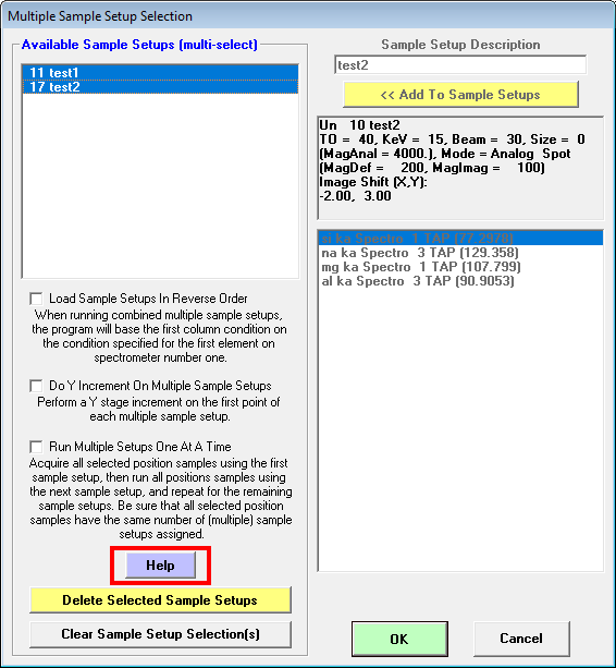

We made some minor changes to the latest version of Probe for EPMA v13.8.3, but the only thing worth mentioning is that we added an "Interactive Help": button to the Multiple Setups dialog which is accessed from the Automate! window as seen here:
which now connects the user to the post above.  I think it's worth having because even I sometimes have to think for a second about which option I want to utilize with regards to the "Run Multiple Samples Setups One at a Time" checkbox!
