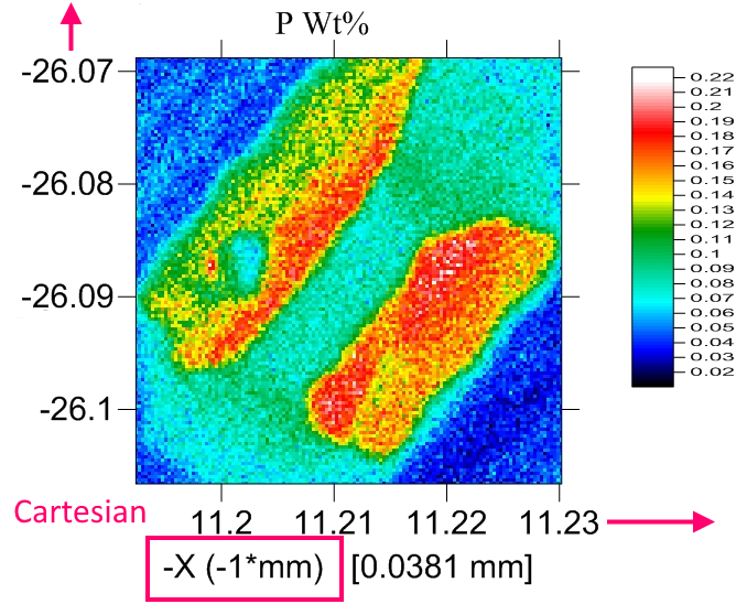

When we first starting using Golden Software's Surfer application to create scripts for automatic output of presentation quality quantitative x-ray maps, we had to handle the fact that the JEOL stage is "anti-cartesian". In others words, the stage XY maximum limits are in the lower left of the map.
But because Surfer (at the time) could only handle cartesian axes where the stage XY maximimum limits are in the upper right, we had to display them like this:

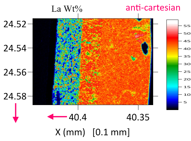

But starting in v. 13 of Surfer, Golden Software added support for a "Reverse Axis" option for the X and Y axes:
If your version of Surfer is 13 or higher, the current version of Probe for EPMA will automatically detect this, and utilize these "reverse axis" options to display the JEOL stage axes natively as anti-cartesian:
Contact Golden Software if you have v 12 or earlier, and update your license to obtain this capability:
