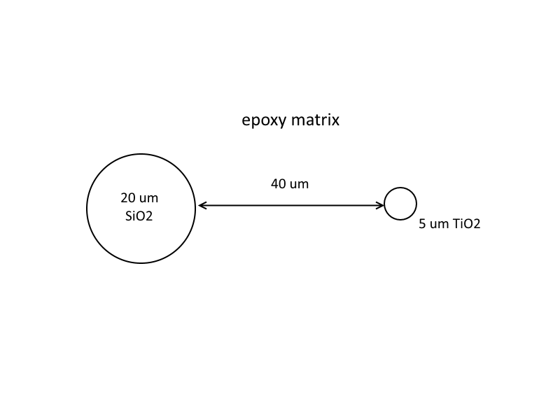

Here's the geometry for a .geo file that we need from a Penepma .geo file expert:
The materials are arbitrary, we just need help with creating the .geo file.  The beam position could be varied but normally we'd put it in the center of the 20 um inclusion.
Does anyone have a file of this (or similar) geometry that they can share with us?

I think this should work (see attachment). I shifted the TiO2 inclusion by 40um, so a beam at (x=0, y=0) hits in the centre of the SiO2 inclusion.
macosta
Hello Philippe,
Thank you for your help! It is much appreciated. Just a  quick clarifying question - is the TiO2 inclusion shifted 40 micron with respect to the edge of the sphere or the center of it (i.e. is the center or the edge of the TiO2 inclusion 40 microns from the center of the SiO2 phase?) ?

The 40um is from the center of each half-sphere. This distance is defined by the x-shift of the TiO2 inclusion.
If it helps, I attached the Python script I used to create this geometry. You need Python3 and pypenelopetools https://github.com/pymontecarlo/pypenelopetools library, which you should be able to install using pip install pypenelopetools

We modified and renamed the .geo file to obtain a distance of 40um between the boundaries of the inclusions by setting the x distance of the TiO2 inclusion to 52.5 um (0.525E-02 cm) as seen here highlighted in red.

That is, 40 um plus 10 um radius for the 20 um SiO2 inclusion plus 2.5um radius for the 5 um TiO2 inclusion. The renamed .geo file is attached below.

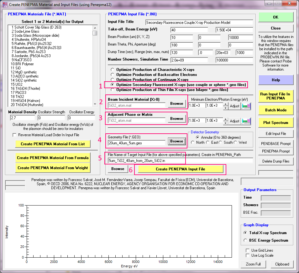

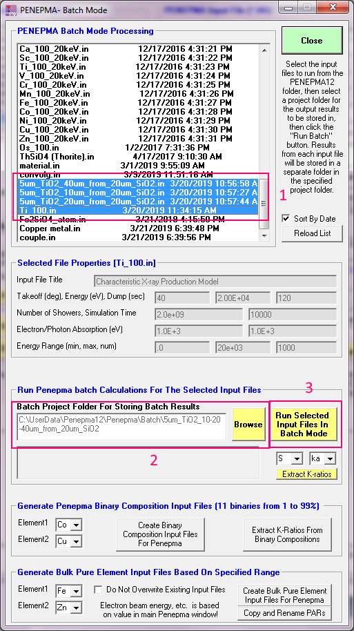

I thought I would share how Marisa and I manually edited the Penepma .in input files to work with Penepma .geo files containing three materials.  This manual editing is necessary because the Penepma GUI in Standard only supports one or two materials. This two material limitation covers most modeling situations, e.g., a single phase (bulk.geo), a SF boundary fluorescence (couple.geo), a thin file on a substrate (bilayer_200nm.geo), and an inclusion in a matrix (50mic_sphere.geo).
The reason for not supporting more than two materials in the Standard GUI is that the possible configurations gets complicated, and so it was decided to limit the Penepma GUI in Standard to two materials. But we can add a third material to the Penepma .in input files manually using a text editor, and then still be able to run these input files from the Penepma GUI in Batch Mode, which automatically copies each completed simulation to a specified subfolder for subsequent review and/or k-ratio extraction.
But first let me mention that after manually modifying the Penepma .in files for a third material and then reloading the modified .in file into the Penepma GUI, we discovered a small bug that caused an error message about a missing control index (for the manually edited third material).  This bug still allowed the batch mode option to run the simulation, but one had to "click through" the error message for each .in file containing more than two materials. The current version of the Penepma GUI in Standard (update to PFE and CalcZAF v. 12.6.0) now handles three materials for running in batch mode. But please note that loading a manually edited three material .in file into the Penepma GUI (by using the Browse button), and re-saving that .in file, will cause the third material to be excluded from the saved .in file. Bottom line: don't click the Create PENEPMA Input File button if your .in file contains more than two materials.  Or if you do, simply re-edit the .in file afterwards, by adding the third material manually, as I am about to describe below.
So, let's start by looking at a three material .geo file, specifically the one created by Philippe Pinard for two inclusions (each a different material) separated by a specified distance, in a matrix (a third material).

The lines highlighted in red above, indicate which material is assigned to each geometric body. In this particular .geo file,  material 2 is the TiO2 inclusion (separated from the SiO2 inclusion by a non-zero distance), material 3 is the SiO2 inclusion (centered on the incident beam when the beam incident X/Y distances are zero), and material 1 is the matrix (SiO2 or epoxy).  Note that these three geometric bodies could be any material (as defined in the .in file), and the comments in the .geo file are simply there to assist in their identification in the .geo file.  By the way, these .geo files are normally saved to the C:\UserData\Penepma12 folder.
So now we look at a corresponding .in file created using the Penepma GUI in Standard (note that the Penepma .in input files are normally stored in the C:\UserData\Penepm12\Penepma folder). Let's start with a two material .in file, by utilizing the default couple.geo file and modifying it for our two inclusion materials:
After the .in file is saved in the 6th step, let's look at it in a text editor:

Note that if one has utilized different SIMPA values for each material, you will want to move those lines along with their corresponding MFNAME lines.  But in this case all the minimum electron/photon energies are 1 keV for all three materials.
Now finally one can go to the Batch Mode window from the Penepma GUI and select the .in files to run as seen here where we created different .geo files with different distances, but we used the same .in file, except of course for the Ti standard which will get used for extracting the k-ratios once it's all finished the simulations (note the Ti standard only needs to run a short time compared to the SF inclusion simulations which are expected to be in the PPM range):
It's so *simple*...     :)   seriously though, it's a lot simpler than editing everything by hand, and besides, the two material GUI works for almost all modeling situations.
And you didn't forget the specify the correct beam energy in the .in files for all the models, right?   :)

So our 20 keV simulations for a 5um TiO2 inclusion 10, 20 and 40 um from a 20 um SiO2 grain *in an epoxy* matrix, finished over the weekend. I forgot to optimize for secondary fluorescence but the variances are smaller than the k-ratios so perhaps it's OK:
"Ti ka in Sample"   "Distance or Radius (um)"   "Std.Tot.Int."   "Unk.Tot.Int."   "Unk.Tot.Int.Var."   "K-ratio"   "K-ratio Var."
"5um_TiO2_40um_from_20um_SiO2"   0   1.69e-04   7.65e-10   1.37e-10    .000005    .000001
All ti ka k-ratios were calculated and output to folder C:\UserData\Penepma12\Penepma\Batch\5um_TiO2_10-20-40um_from_20um_SiO2_epoxy_matrix\5um_TiO2_40um_from_20um_SiO2
"5um_TiO2_20um_from_20um_SiO2"   0   1.69e-04   1.81e-09   2.08e-10    .000011    .000001
All ti ka k-ratios were calculated and output to folder C:\UserData\Penepma12\Penepma\Batch\5um_TiO2_10-20-40um_from_20um_SiO2_epoxy_matrix\5um_TiO2_20um_from_20um_SiO2
"5um_TiO2_10um_from_20um_SiO2"   0   1.69e-04   3.50e-09   2.94e-10    .000021    .000002
All ti ka k-ratios were calculated and output to folder C:\UserData\Penepma12\Penepma\Batch\5um_TiO2_10-20-40um_from_20um_SiO2_epoxy_matrix\5um_TiO2_10um_from_20um_SiO2
Expressing the k-ratio in PPM we get:
10 um from: 21 +/- 2 PPM
20 um from: 11 +/- 1 PPM
40 um from:  5 +/- 1 PPM
So about the same (~ 1/2) as we got for an SiO2 matrix (at 15 keV), but the distances were a little different so I'm going to re-run the SiO2 matrix simulations with the correct distances and at 20 keV again over the weekend so we can compare apples to apples.

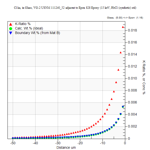

Doing that we can see that assuming a Cr or Mn Ka radiation as a proxy for continuum x-rays sufficient to excite the Ti K edge (at ~4.9 keV), for a distance of 10 um we get roughly a transmission of 0.8 for an SiO2 matrix, and a transmission of 0.95 for an epoxy matrix.
Therefore the epoxy matrix produces a slightly larger secondary fluorescence effect for Ti Ka than an SiO2 matrix.  Sorry for the earlier confusion!   :-[
I was recently contacted by Di Zhang at the Institute of Geology and Geophysics, Chinese Academy of Sciences (IGGCAS) and they asked where the Epon 828 epoxy composition comes from (it has 0.3 wt% Cl) and I cannot remember where I found it.
It's not a huge contribution is this case as there is only about 40 PPM Cl a few microns from the boundary, but maybe other epoxies have higher Cl contents?
Does any one have compositional data on other epoxies?
This also reminds me of a time a few years ago when we started seeing about 100 PPM of Cl in all our samples, and we finally traced it to our carbon coater, in which the engineer had replaced a piece of vacuum tubing to the roughing pump with PVC tubing, that turned out was out gassing Cl into the system and getting into our carbon coats!
I should also mention that, for the purposes of modeling the boundary fluorescence of Cl by x-rays generated from a (volcanic) glass, the CNOH composition of the epoxy isn't especially important. That is to say, the composition of the organic compounds isn't as important as the Cl content of the epoxy. In other words, the fluorescence of chlorine by X-rays from the glass interaction volume will primarily be from the continuum.
To that end, has anyone here ever attempted to analyze the concentration of Cl or other (non-CNOH) elements in epoxy?
Yeah, I know that normally one always tries to avoid hitting epoxy!   :o  But if we actually needed to know the Cl concentrations in various epoxies, how might one go about that using the EPMA?  Obviously a very gentle, defocused beam, but even then would it be possible?
I also note that asking Google this question I got the following response:
QuoteEpoxy resin used in various applications is superior in adhesive strength, heat resistance and has good handling, too. However, epoxy resin usually includes several percent chlorine as impurities.
So if indeed there are epoxy formulations with several percent Cl, then the boundary fluorescence issue of this element at trace concentrations (near epoxy boundaries) could become a much larger concern for us.
I'll attempt to calculate a PAR file with "several percent chlorine" and present these results...
