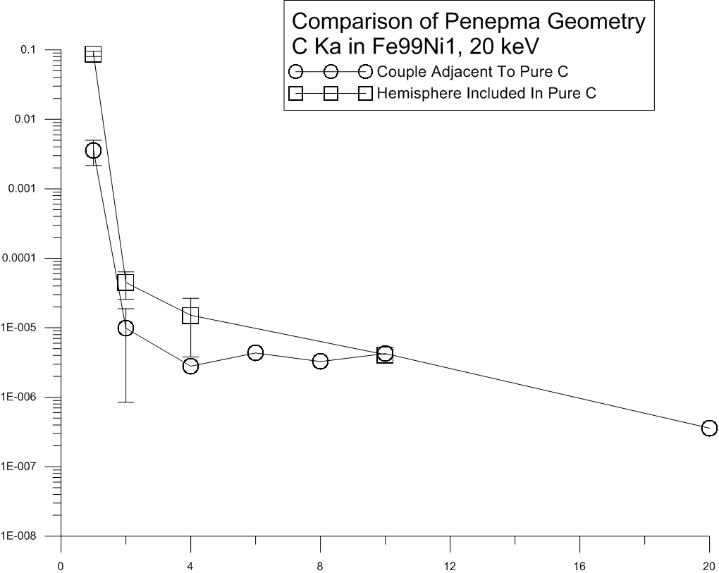

I re-ran the C Ka in Fe99Ni1 adjacent or included in pure C for both the couple and hemisphere geometries, but using a longer integration time. That is 50K seconds versus the original 3.6K seconds per simulation as seen here:
http://smf.probesoftware.com/index.php?topic=59.msg1341#msg1341
Here are the 50K seconds simulations calculated for Penepma couple and hemisphere geometries along with the Penfluor couple calculation just for comparison:
Note that the Penepma couple calculations and the Penfluor quick and dirty model produces similar but somewhat different intensities also.
A plot shows that the couple and hemisphere geometries produce quite different k-ratios for C Ka:
The symbols without error bars have errors larger than the data values!

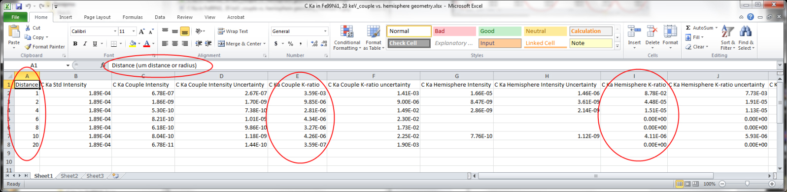

The data file and plot output are attached below.
Note that the hemisphere calculations were originally plotted using the diameter. They have been updated to plot using the radius.

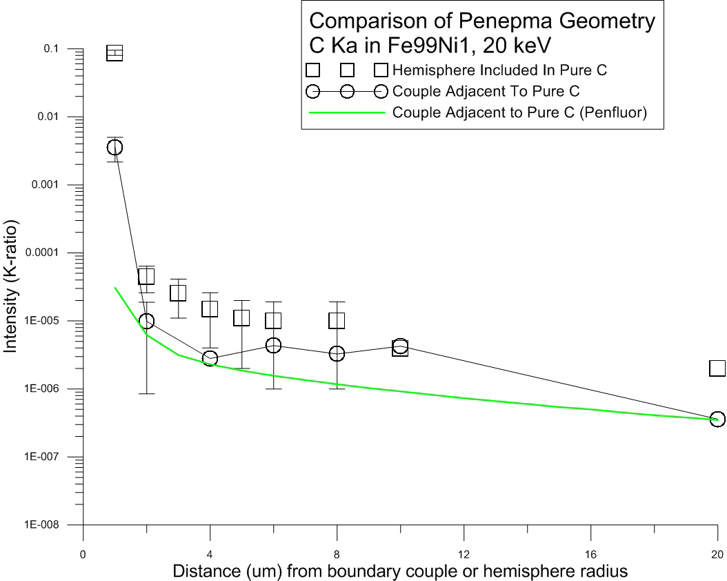

Someone asked to see the Penfluor data plotted up alongside the Penepma data for the C Ka in Fe99Ni1 adjacent to pure C and so here it is.  I added an arrow to show where the 0.5 um k-ratio intensity would plot up, but considering how steep this function is for a very, very absorbing system, the differences aren't as bad as one might think.
In fact, the k-ratio values at 2 microns and further are essentially identical (within statistics)!
As for the difference in the intensities at less than 2 um? These can probably be explained by the fact that at that distance and with a 20 keV incident beam, you'll get some primary electron scattering into the boundary phase which Penepma will handle properly, while that contribution is neglected in the SF calculation in Fanal. Why? Because Penfluor pre-calculates the PAR files for the primary excitation (and continuum fluorescence) intensities based only on composition- without geometrical considerations in its Monte-Carlo modeling. Fanal then calculates the secondary fluorescence intensities using an analytical model which assumes that all electrons come to rest in the beam incident material. More discussion on this here:
http://smf.probesoftware.com/index.php?topic=58.msg1388#msg1388
What does this mean to us?  Well we should perhaps utilize Penfluor when we need a relatively quick answer, but maybe not trust it quite so much as the interaction volume radius approaches our boundary distance.

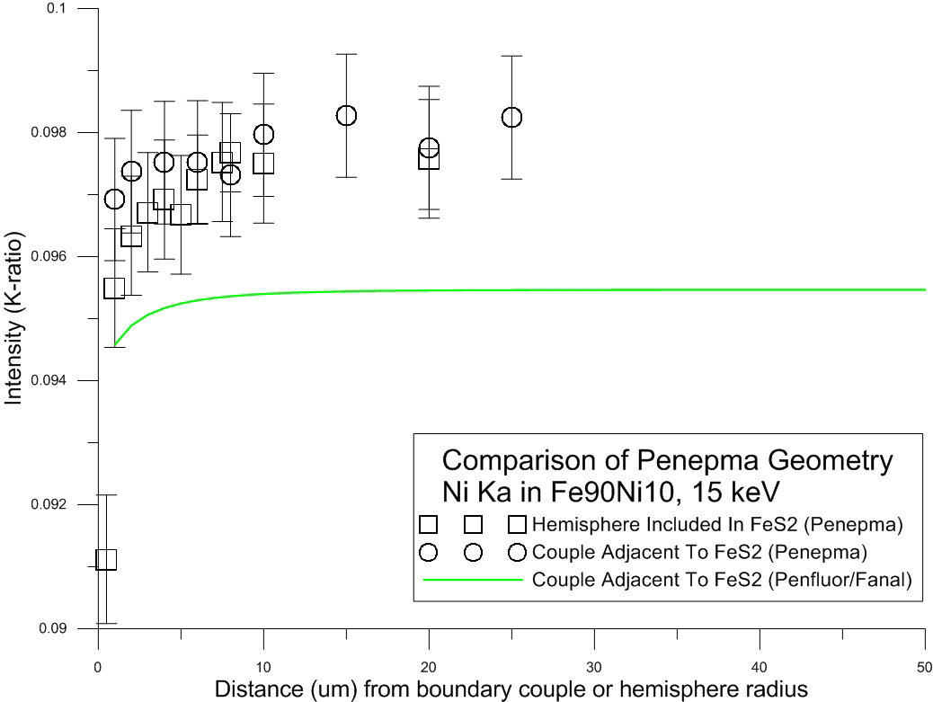

Here are my S ka in Fe90Ni10 at 15 keV comparison between Penepma hemispheres vs. Penepma couples vs. Penfluor/Fanal couples.
The remaining values I am continuing to calculate...
I've also attached a complete set of the hemisphere geo files in case that would be useful below.

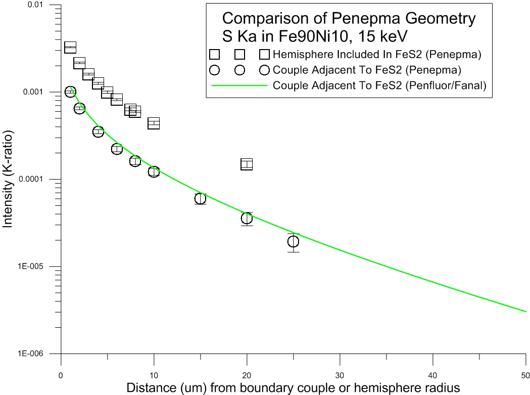

Here is an updated plot of S Ka in Fe90Ni1 embedded in FeS2:
Just for fun I also calculated the same for Ni, which gives the following:
Not bad considering the size of the 1 sigma error bars!
Don't know why the Ni intensity drops as the boundary is approached?  A hint is here:
http://smf.probesoftware.com/index.php?topic=126.msg525#msg525

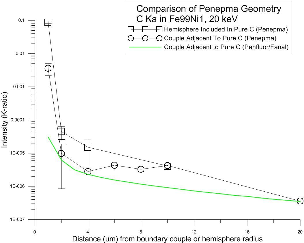

A more recent calculation of Ed's C Ka in Fe/Ni included in carbon (epoxy):
Data files attached below.
