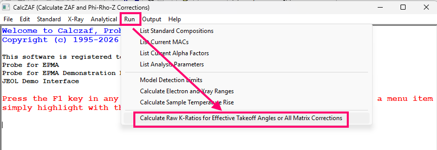

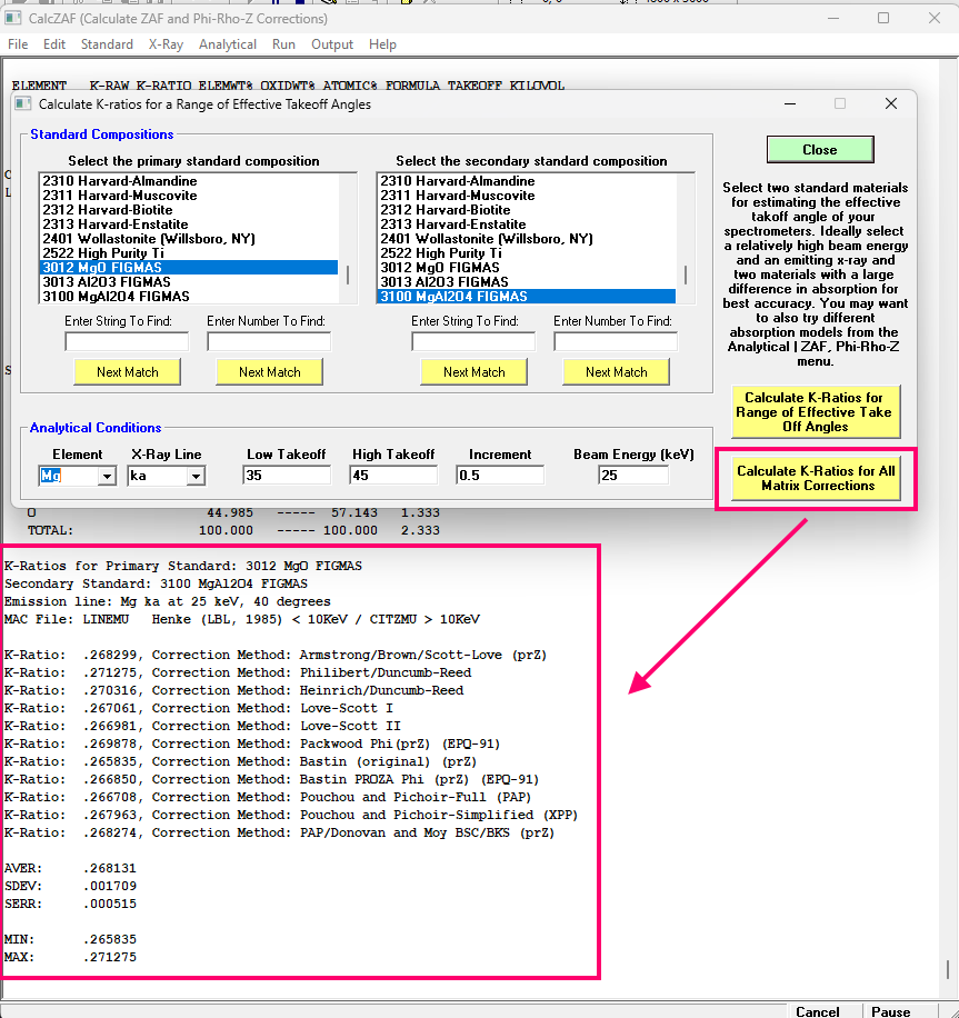

Continuing our discussion of new features in Probe for EPMA added since early summer, we now have a new effective takeoff angle estimator dialog in the CalcZAF application as shown here:
This dialog in CalcZAF can be used to derive the "effective" takeoff angle on one's WDS spectrometers when there is an apparent disagreement between the various spectrometers as shown here:

Have you ever wanted to quickly calculate what your expected raw k-ratios will be for two materials?
We've modified the Calculate K-ratios for a Range of takeoff Angles window in CalcZAF for this:
Here's an example output:
I'm finding it useful for our evaluations of spectrometer k-ratios:
https://smf.probesoftware.com/index.php?topic=1569.0
Maybe you will too!
