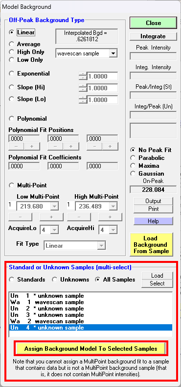

So next click the Model Background button as seen here and you will see the fit to the default (linear) model:
Not bad, but this spectrometer range is near the low side and therefore the background tends to be more exponential. We can see the default bgd fit intensity here:
So now lets try an exponential fit as seen here:
Note the lower background intensity value and also the ability to adjust the "tension" of the exponential fit.
The new off-peak positions are automatically saved, but if we want to save changes to the background fit type we can simply select the samples to assign it to specific samples at the bottom of the dialog (note All Samples option and Select button) using the mouse and then click the Assign Background Model To Selected Samples button as seen here:
Remember, if you also include the currently displayed wavescan sample in this background fit assignment, the software will automatically load that assignment the next time you click the Model Backgrounds button.
Or you can modify the fits from the Elements/Cations dialog as seen here:

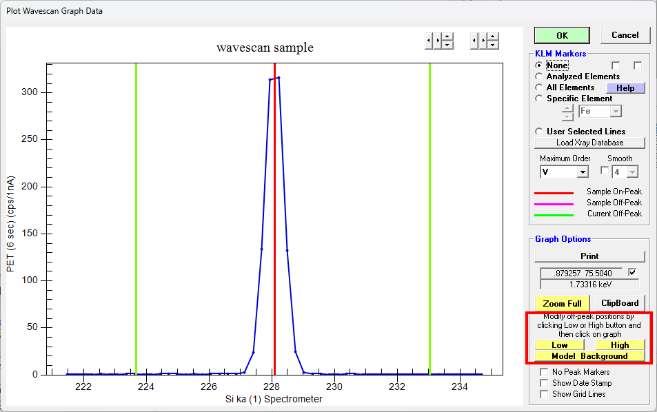

No peaks interfering with the off-peak positions for Fe in these matrices, so we can just stick with the default two point linear model. What about Si Ka:
Looks OK, but what happens when we zoom in a little and check our background fit using the Model Backgrounds button?
As we can see the two point linear model isn't working very well because the background between the Si ka and a secondary peak (from Hf) doesn't quite reach the true background level. Remember about Bragg crystal polygonization effects during manufacturing which greatly extends the tails of our Bragg crystals?
Time to go to the high or low side background and apply a slope (SEM Geologist's favorite method!) as seen here using a Slope Low fit:
Now that our background fit is better we can apply these background model changes to all samples using the Select button and the Assign Background Model To Selected Samples:
Remember, one cannot change the off-peak background positions for samples that already contain data, but they will be applied to new samples. However, one *can* change the background fit model for all samples regardless of whether they contain intensity data or not!

At first glance that might look OK, but of course we'll want to zoom in a bit as seen here:
Now we can see that things are more interesting and in fact maybe we need to move the high off-peak positions a bit more to the right!  Here we have for Al Ka zoomed in:
and more interestingly, for O Ka, which has a non-linear background:

Here's a tip when adjusting your off-peak backgrounds from the Plot! window after plotting up a wavescan:

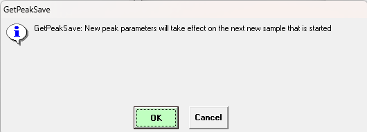

If the current sample is a wavescan, or a unknown or standard which contains intensity data, Probe for EPMA cannot assign the new off-peak positions to the current sample. Instead you will get this warning:
When you see this message you should immediately create a new unknown sample from the Acquire! window. Then your changes to the off-peak positions will be saved.
Note that you can also assign the modified off-peak position using these option here from the Model backgrounds button:
Even easier, just create a new unknown sample before opening the Plot! window before making any changes to the off-peak positions.
