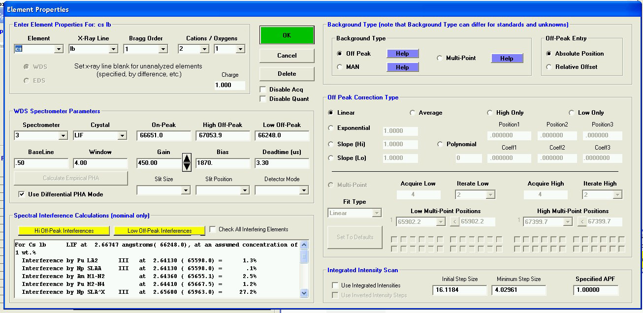

By the way the interference calculations in the element properties window do
1) not work for beta lines,
2) and do not show the offset in spectrometer units.
See image below.

Hi Philippe,
It looks like it works for beta lines, as you have one displayed in your image!
Unlike Standard, the spectrometer reading in PFE is in absolute value, not offset.  I could change that to display in relative spectrometer offset values if you prefer.
Edit by John: Ok, I see why the Elements/Cations dialog nominal spectral interferences are not displayed in relative offsets...  they *are* displayed in relative offsets in the Standard Assignments dialog because the interference calculation there is for on-peak interferences.
But because the Element/Cations dialog is for *off-peak* interferences, there is a problem with what to reference the relative calculation to if the off-peaks are "same side" off-peaks!  So for now they will stay in absolute spectro units... and the topic is open for discussion.

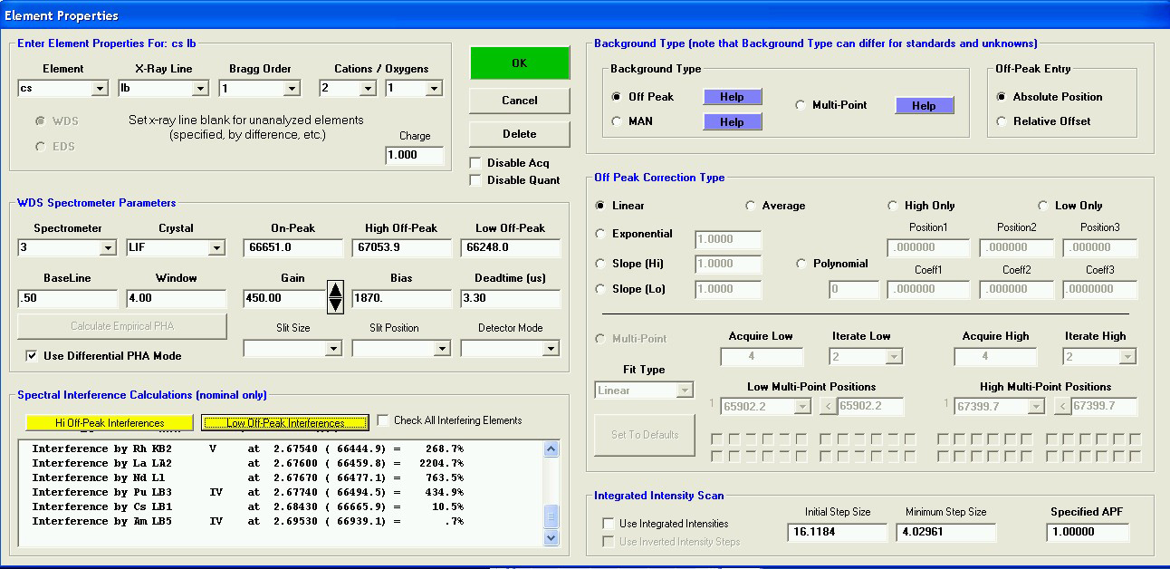

As you might have noticed it says:
"For Cs Lb     LiF at  2.66747 angstroms (66248) ..."
That IS the La peak position. It even calculates the interference with the Cs Lb line, see below. Where it also gives the correct value for the Lb line. The list value for Cs Lb is 66665.9 (2.6843 A) or on my spec it is "On-Peak" 66651.0.
Elighten me, if I am wrong.
As from my point of view, everything is quite ok, but being able to choose the crystal in standard.exe would be very helpful.

Hi Philipp,
Ok, I see the source of your confusion.  First of all it appears you are using an edited file of x-ray line energies, which confused me a bit...
But more importantly, when it says "For Cs Lb     LiF at  2.66747 angstroms (66248) ..."
The phrase "Cs Lb" doesn't mean the on-peak position of the Cs Lb, it means the off-peak position of Cs Lb.  In the screen shot below, because I clicked the "Low Off-Peak Interferences" button, it lists the interferences in the vicinity of the Cs Lb low off-peak position.  Which is exactly what one would like to see, correct?  If I had clicked the "Hi Off-Peak Interferences" button it would display the interferences around the Cs Lb high off peak position.
Does that make more sense?
I can fix the output so it states that more clearly.   Remember, in the Standard Assignments dialog is where you can see the on-peak interferences...

yes, this does make more sense. I think a slight rewording of the text might be helpful, because I got confused by the peak position, which was in fact one of the background positions... Maybe this can be made more clear.
Philipp
