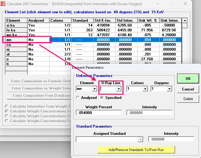

The remaining examples are similar to what we have already looked at above, but a few others deserve additional explanation.  This example of calculating stoichiometric oxygen in a matrix where some of the oxygen is replaced by a halogen element is interesting:
Because the matrix correction was calculated with the assumption of stoichiometric oxygen as shown above, the absorption correction of F ka by oxygen is over calculated. Particularly since the absorption of F ka by oxygen is quite severe. However, by simply applying a correction for oxygen equivalent of halogen in the matrix iteration we can rigorously calculate the proper absorption correction for F ka by stoichiometric oxygen as seen here:
The modified absorption correction and results are seen here and it is worth noting that without the subtraction of the oxygen equivalent of fluorine from the calculated oxygen during the matrix correction, the fluorine values will be in error by over 20% relative (9.252 wt% without the halogen equivalent correction and 9.023 wt% with the halogen equivalent correction in the matrix correction)!
Finally note that the standard used for fluorine should be entered properly into the standard composition database (Standard.mdb) with the oxygen equivalent of halogen applied as seen here:

Just a reminder that one can specify unanalyzed elements (elements specified by concentration, difference or by stoichiometry, etc.), in CalcZAF just as one does in Probe for EPMA:
https://smf.probesoftware.com/index.php?topic=8.msg13634#msg13634
by leaving the x-ray line blank:
