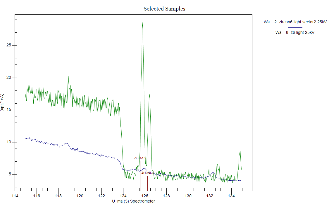

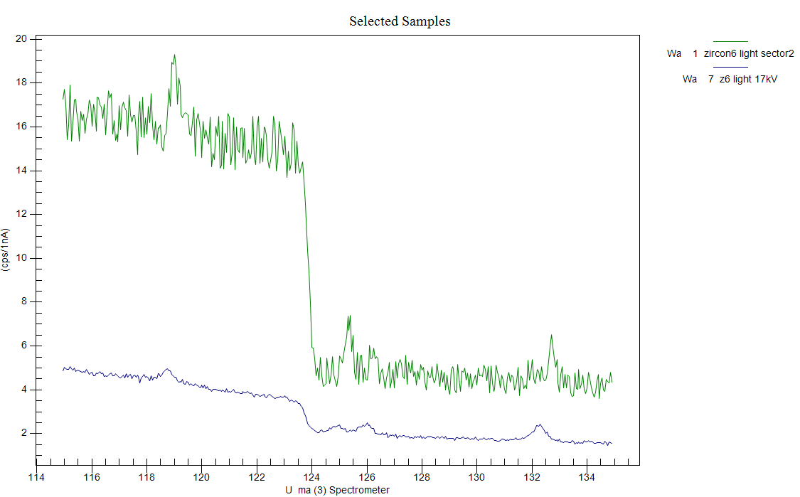

I ran the simulation on a zircon - for a sample I already had an actual wavescan for at 17kV.
It does a very good job, shows the effect of absorption edge, and allows correct background selection - or use of Mb line. Plus when compare to xeno counter spec 4 see difference
Simulation green. Actual wavescan blue
At 25kV - see simulation includes Zr La 5 order, for like wavelength tables, the reflectivity of crystals for high orders not none

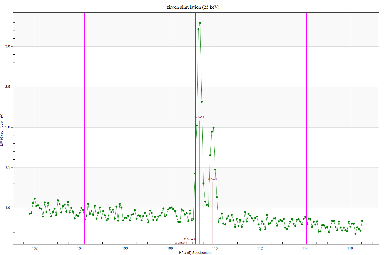

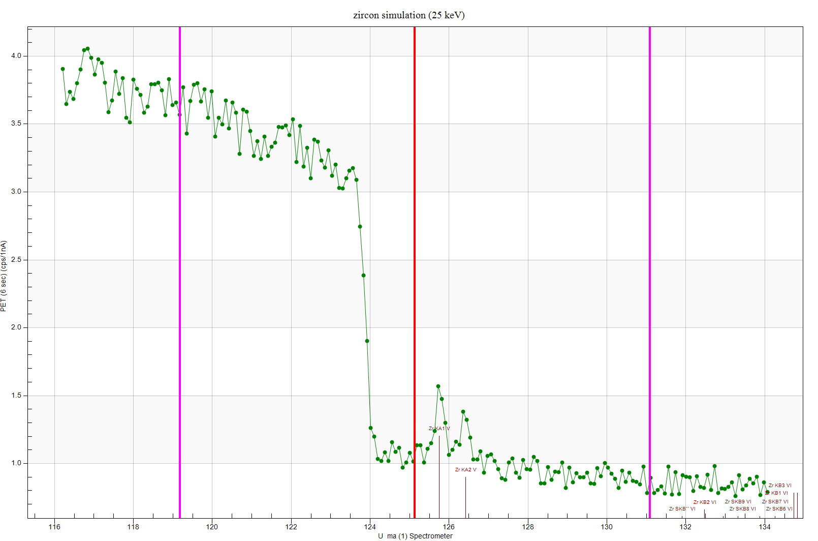

I worked a bit on the higher order Bragg reflection code and here is a simulated scan of U ma ROI on PET for a zircon composition (at 25 keV):
I think this looks better.
By the way I also happened to also run a simulation of the Hf La region and here is a teaching opportunity to demonstrate to students why in zircon we prefer the Hf Ma line:

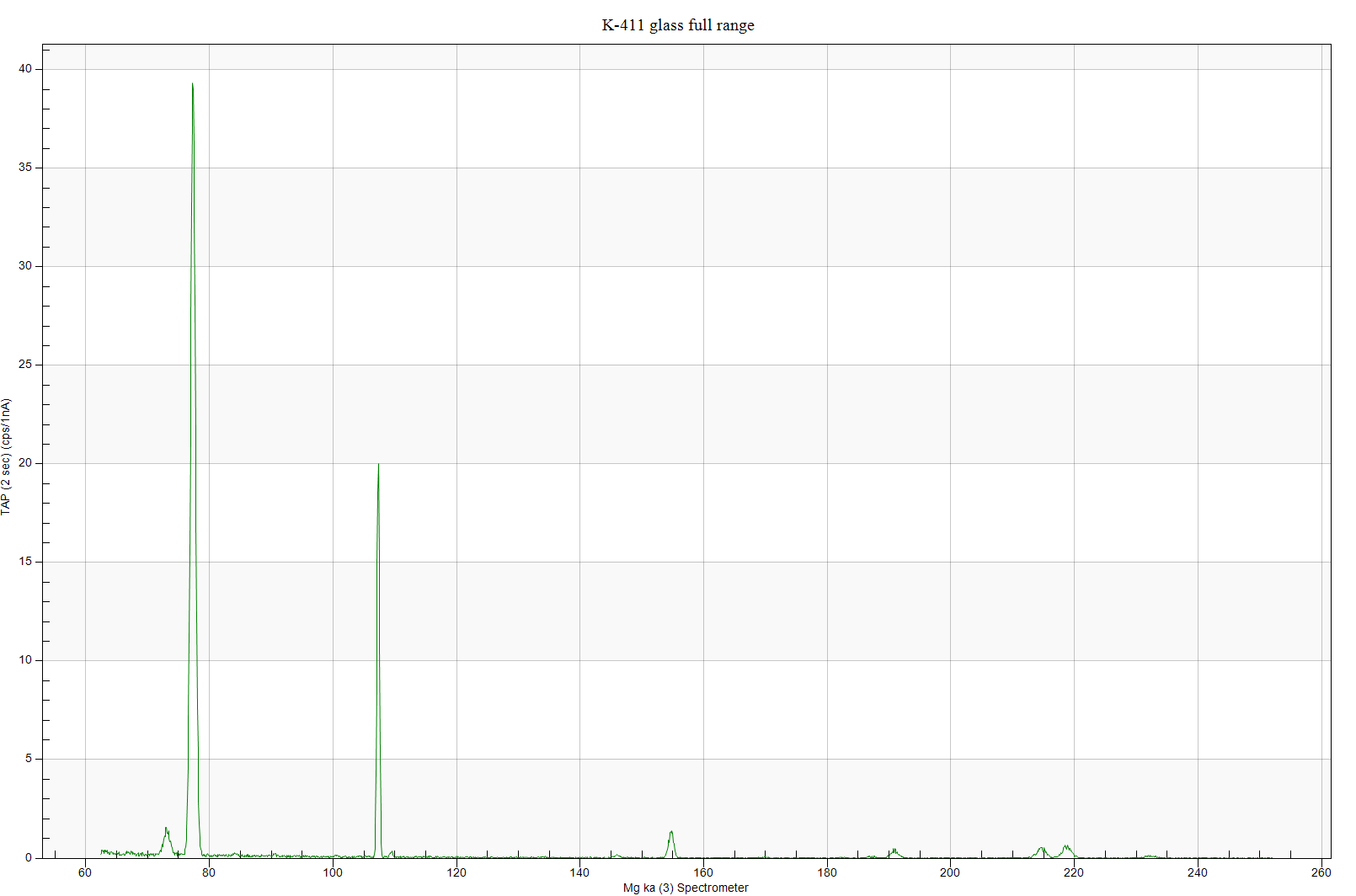

In addition I ran a full spectrometer range simulation on the K-411 glass here (at 15 keV):

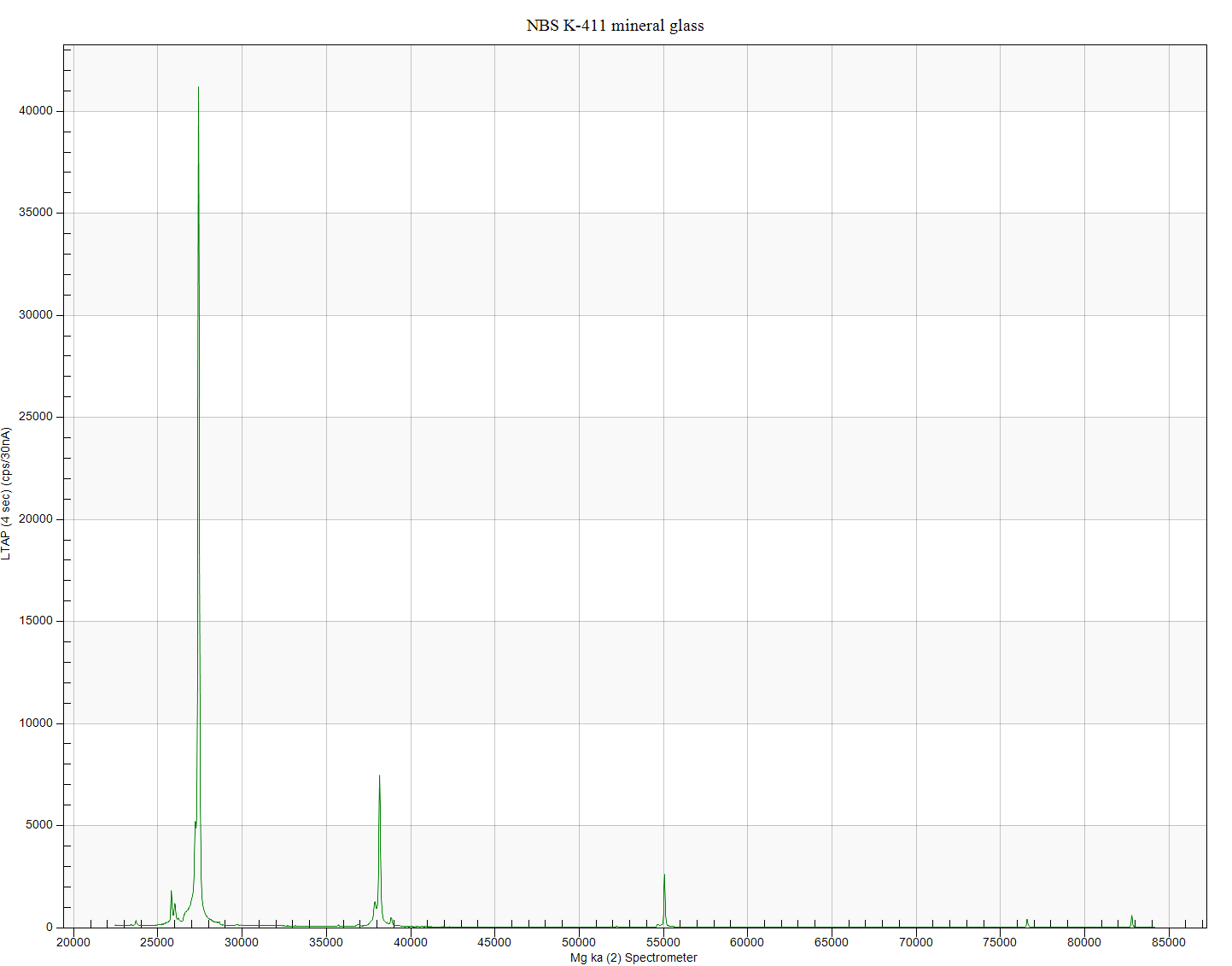

and here is an experimental scan from my SX100:
Not too bad I think.  Good enough for teaching in the classroom I think.

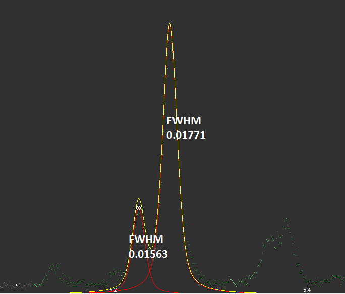

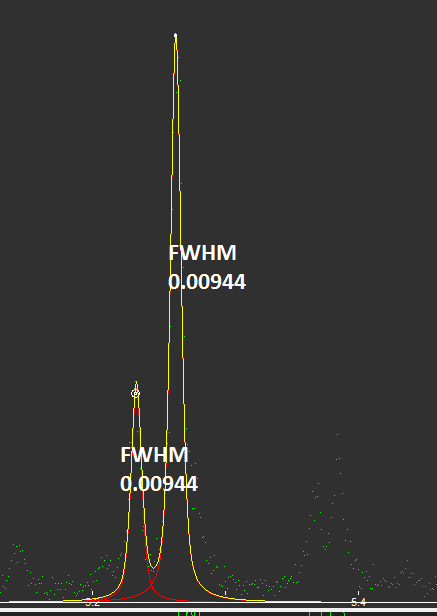

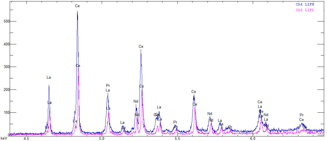

Here are wavescans on Monazite
Which give LIFL 9.4 eV FWHM for Ce Lb and Nd La
And LIFH 17.71 ev FWHM
(peak fit using Fityk)

Sorry did I forget to say. Its REE in Monazite. LIFL in pink, LIFH in blue
