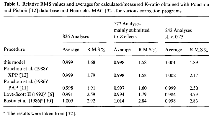

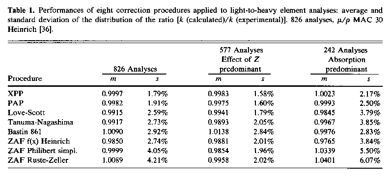

Does anyone know of a paper that compares Armstrong matrix correction with PAP and XPHI. In Pouchou & Pichoir (1991) (Heinrich green book) - we have 826 dataset - and is tested on following
and Merlet (1994) tried his XPHI model
But none compare Armstrong

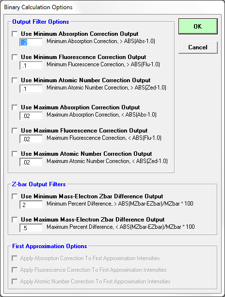

I notice in Calczaf you can do histogram using Pouchouz10 - but this has 91 analyses - what is this?
I'm guessing Armstrong is good for geological samples - as it was developed and tested for them Armstrong (1988) but maybe not as good across the whole range??
Is it possible to change the default matrix correction in PFE.
Following on from my post.
I see you can calculate binaries for pouchouz10 - does this correspond to the 577 analyses z dominant?
pouchouza20 - does this correspond to the 242 analyses absorption dominant.

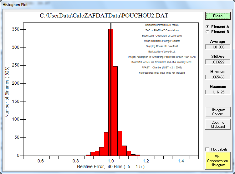

I've tried pouchou.dat this has 756 analyses how does this compare to 826 analyses of Pouchou & Pichoir (1991)
and pouchouz2.dat - I just tried this is the 826 dataset
Right so here is Armstrong and FFAST

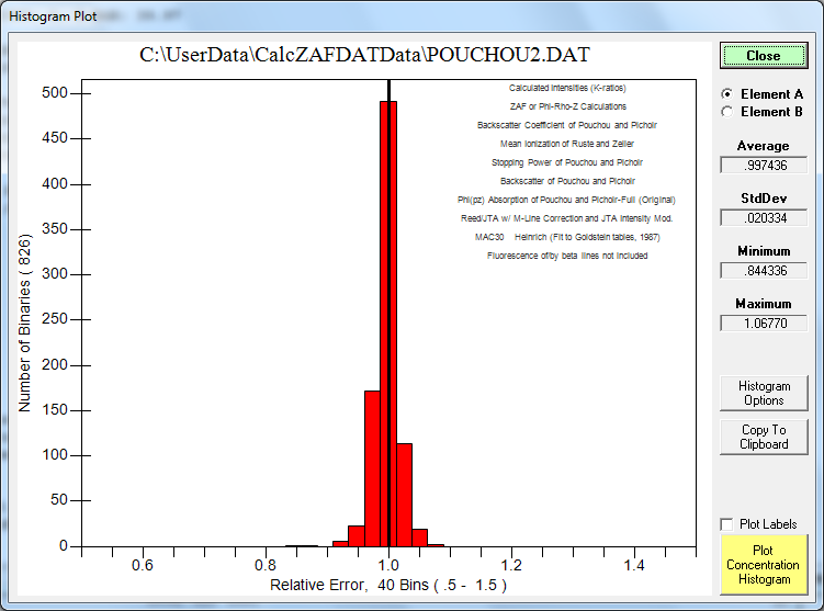

And here is PAP and FFAST

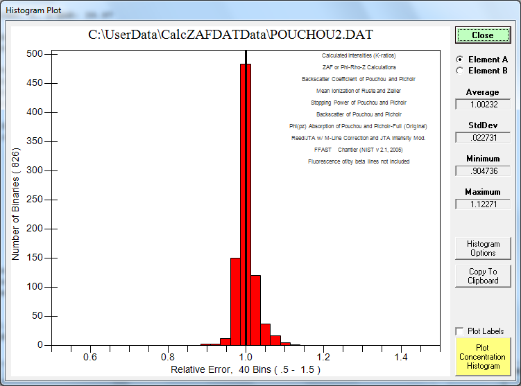

And PAP with MAC30  - as in table

Thanks Owen and John,
That's a great help. So I guess not using Bastin MAC's explains the slight discrepancy from the published table.
