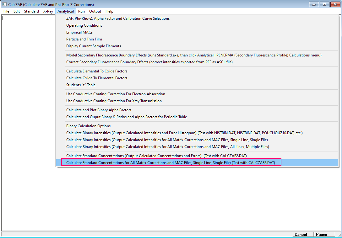

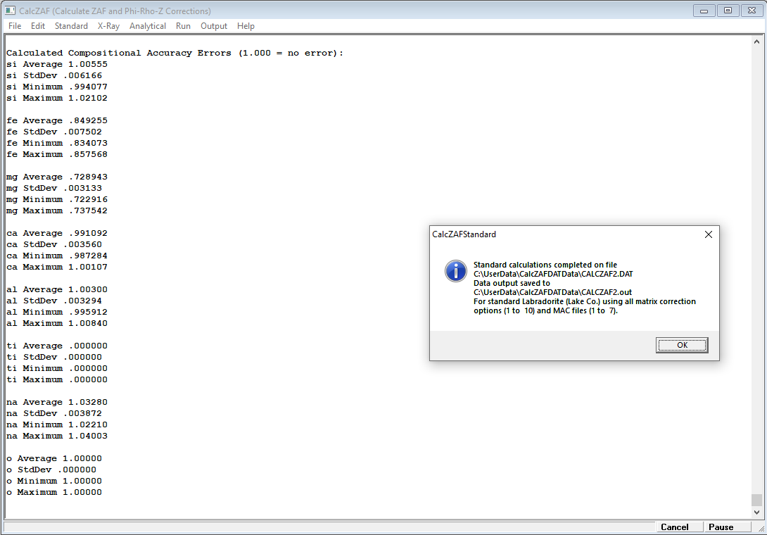

I moved your topic to this existing topic (with the exact same name!)...  so you might want to check the previous posts in this topic.  I should also suggest that you check out the CalcZAF feature shown here:

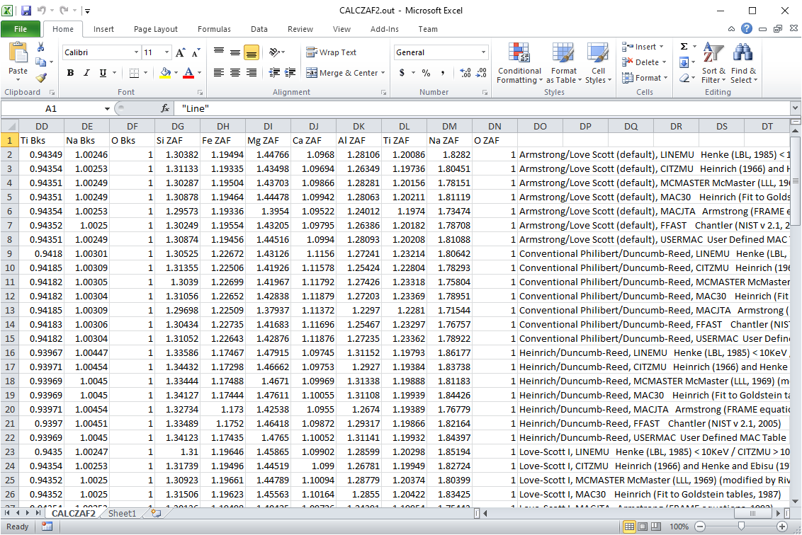

This requires you to export a composition from Probe for EPMA (which was analyzed as a standard, but you said you thought you knew what the composition should be...) using the PFE Output | Save CalcZAF Standard Format menu, and then run CalcZAF to apply all 10 matrix corrections and all 7 MAC tables as shown here:
The output file (or at least a piece of) is shown here loaded into Excel, so you can plot histograms of the different matrix corrections and MAC combinations to see what the distributions are:
Maybe this will be useful.
