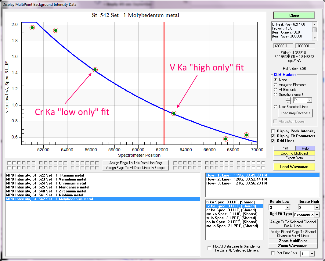

Sorry for this long post but we wanted to update you all on a new and somewhat subtle behavior for the "shared" background method. Our story most recently begins when Mike Williams at U Mass, who has been utilizing the "shared" MPB method in Probe for EPMA (see this this topic for more details), had a suggestion that we thought was quite interesting, but seemingly somewhat difficult to implement.
As most of you know, the multi-point background (MPB) method, originally proposed by Mike Jercinovic, Julien Allaz and Mike Williams,  allows the analyst to acquire *multiple* background measurements on each side (or just one side!) of the peak position. Up to 18 off-peak measurements on each side of the peak for a total of 36(!) off-peak measurements. Very useful when one is trying to characterize the background curvature with high accuracy for trace elements.
Actually the MPB method used to be limited to (only!) 12 off-peak measurements on each side for a total of 24 background measurements, but then Mike Jercinovic and Mike Williams actually found a need for larger MPB arrays (those guys are just crazy about trace elements!) when searching off-peak elements for use as "shared" backgrounds as described in reply #28 above. For those not familiar,  the "shared" background method was an idea from Karsten Goemann and Gareth Seward which utilizes multiple (two background) off-peak elements, acquired on the same spectrometer and Bragg crystal, to allow all the off-peak intensities to be fitted as MPB measurements for each element.  The idea was quite clever because it utilized the already implemented MPB method structures and arrays.
Anyway back to recent events, in very complex spectra Mike and Mike found that there sometimes isn't room for each element to have two off-peak backgrounds, so they asked if we could simply skip acquisition of one of the normal off-peak backgrounds for a particular element.  Well the long and short of that discussion is that it is just not practical, as there is simply too much code that depends on there being two off-peak backgrounds for each element. Also, allowing the analyst to acquire a single background measurement is (in our humble opinion) not very rigorous, since the continuum is generally sloped at a sufficient level of precision.
However there are several off-peak background *fitting* methods in Probe for EPMA that allows the analyst to specify that either only the high or only the low of-peak measurement be included in the background fit. These are respectively the "high only" and "low only" off-peak background fit options (and also the slope high and slope low options) as described here:
https://smf.probesoftware.com/index.php?topic=68.msg6255#msg6255
So we proposed that they acquire two point backgrounds as usual, but then just set the acquisition time for the background they don't need, to a very short time.  There's still the spectrometer motion, but that is pretty quick. Then, they just assign the off-peak background fit on those elements to either "high only" or "low only" depending on which off-peak measurement they want to ignore.
Finally (whew) from the Analyze! window when they do search for "shared" backgrounds, the modified code now also checks the off-peak background fit option and ignores the off-peak measurement that is not being utilized in the off-peak fit. Here is an example of 4 off-peak elements fit using the "shared" background option, but where V Ka was specified as "high only" and Cr Ka was specified as "low only", so only these off-peak measurements for those two elements were utilized in the MPB fit:
