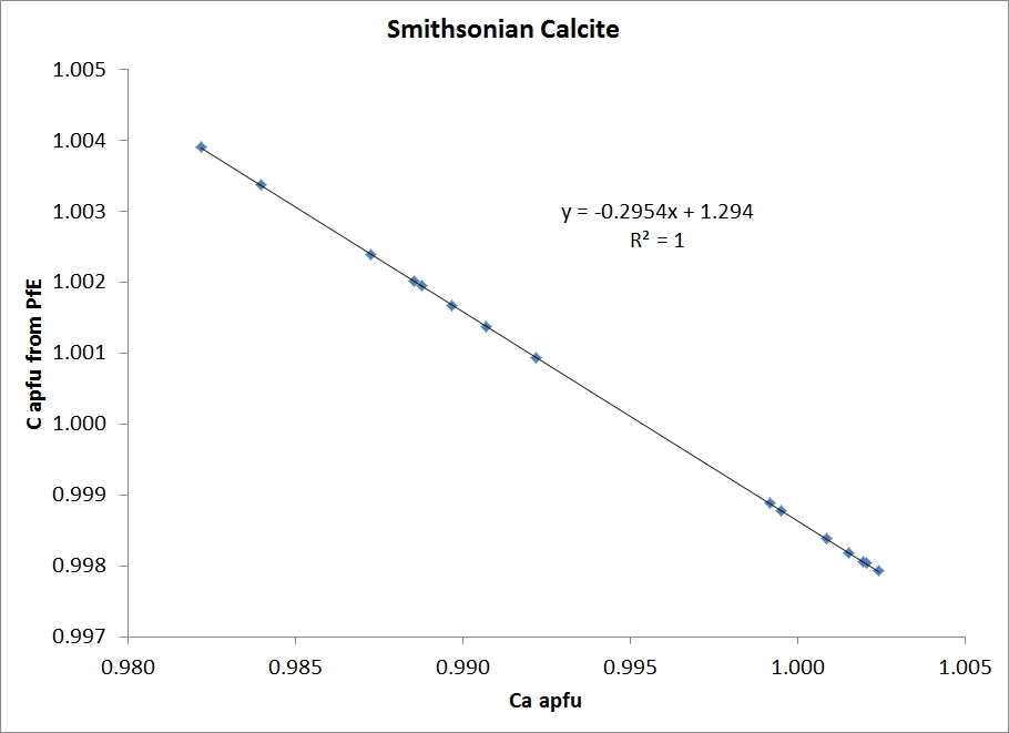

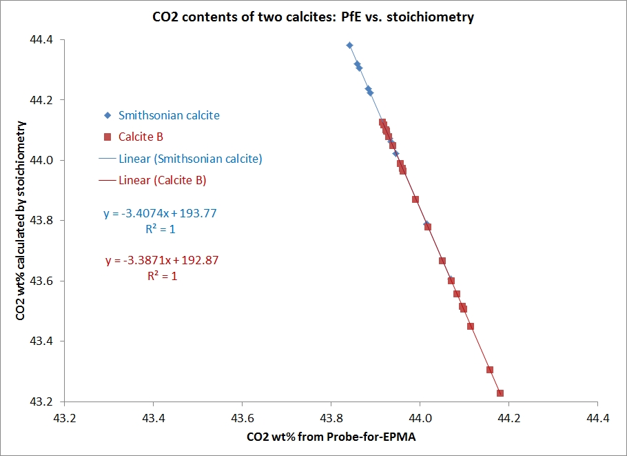

Below is a graph of the C vs. Ca formula contents from multiple analyses of the Smithsonian calcite standard.
CO2 was added by stoichiometry (0.33333 C for every 1 O) prior to the matrix corrections.
The amount of C is perfectly anti-correlated with the amount of Ca.
My interpretation: this is an unfortunate consequence of the analytical uncertainty in Ca coupling with the algorithm loops in Probe-for-EPMA.
If Ca is low, PfE determines C as high. If Ca is high, PfE determines C as low. Of course the ideal is 1:1, CaCO3.
I am pretty sure that the Smithsonian calcite is electrically neutral (charge-balanced!), so the behaviour in this graph is an artifact of the data reduction process.
Take home message: at present, add CO2 in to get the best data reduction, then recalculate it for stoichiometry.

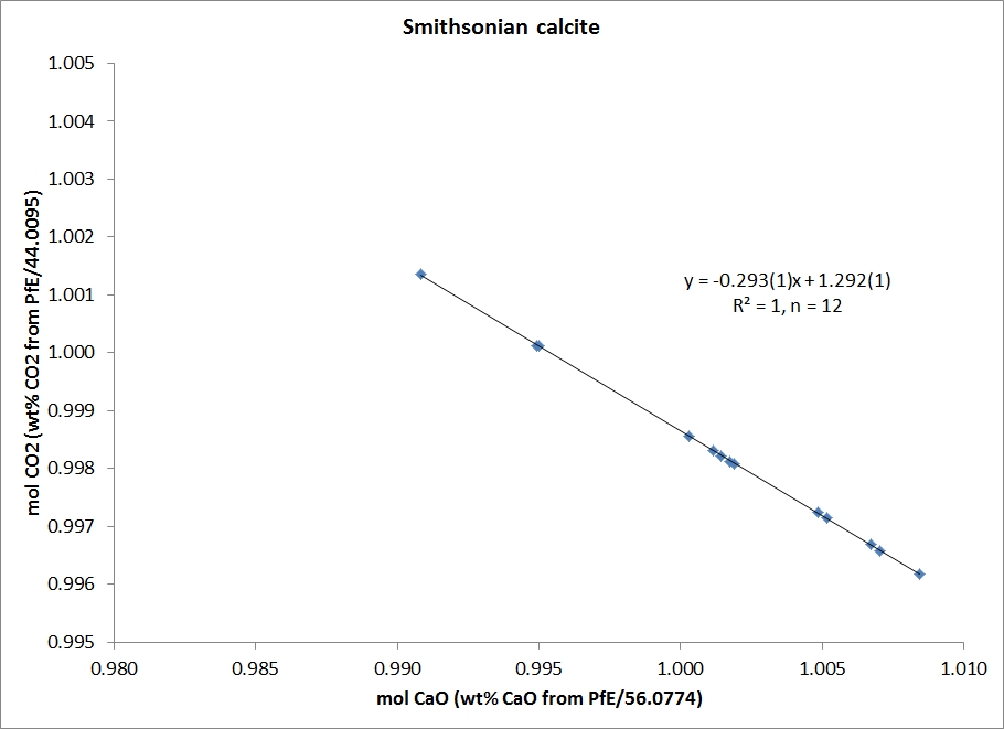

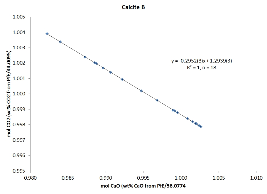

The data are from back in 2015; I have attached the raw oxide data (CaO and CO2) and the molar proportions that result as an Excel file. There are actually two calcite samples present (which I previously confused, sorry).
The plots of the molar proportions show negative linear correlations (essentially identical for the two calcites):
Of course, the molar amount of CO2 should(!) be equal to the molar amount of CaO.
That is, these graphs should simply show y = x.
If one recalculates the wt% CO2 based on the stoichiometry CaCO3, it has a negative linear correlation with the wt% CO2 initially reported by Probe-for-EPMA:
The weight percent CO2 reported by Probe-for-EPMA (after the iterated matrix corrections) is not in stoichiometric proportion to the CaO content for these calcite analyses.

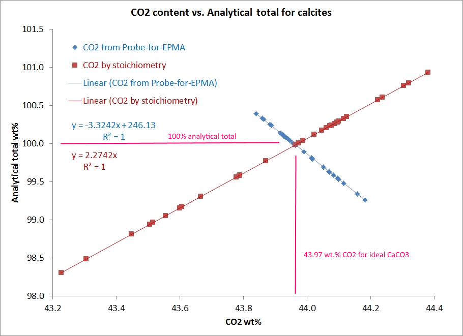

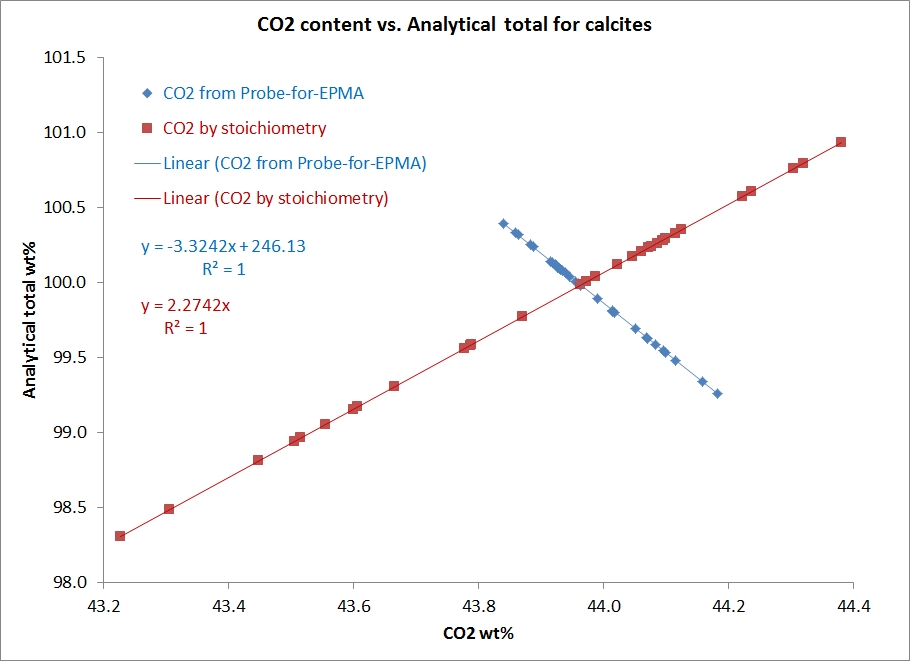

In answer to your question about correlation with the analytical total, for the two calcites, the initial data reported by Probe-for-EPMA show a negative linear correlation between wt% CO2 and analytical total.
Whereas, when CO2 is calculated by stoichiometry to the CaO content, the wt% CO2 and the subsequent revised totals are positively correlated, in the ratio 2.2742. This is, of course, the ratio found in ideal calcite, CaCO3 (43.97 wt% CO2, 56.03 wt% CaO, total 100.00), where 100/43.97 = 2.2742.

Hi Andrew,
Yes, this is exactly what I suspected. For those analyses where the totals are not close to 100%, when the concentrations are normalized to 100% for the formula calculations, the CO2 stoichiometry gets "distorted" due to different atomic weights relative to atom proportions.
As evidence for this, please note that for those analyses in the above plot where the analytical totals are close to 100%, the stoichiometric CO2 values are almost exactly equal to the ideal concentration of 43.97 wt% CO2.
I'm really not sure what one can do about this except try to obtain better analytical totals!   :P
In principle I guess one could concoct a "correction" for those analyses which don't total close to 100%, but this seems to me to be a little problematic for several reasons.
The good news is that averaging these analyses together should average out this normalization effect.  Assuming the average analytical total is close to 100%!  :)

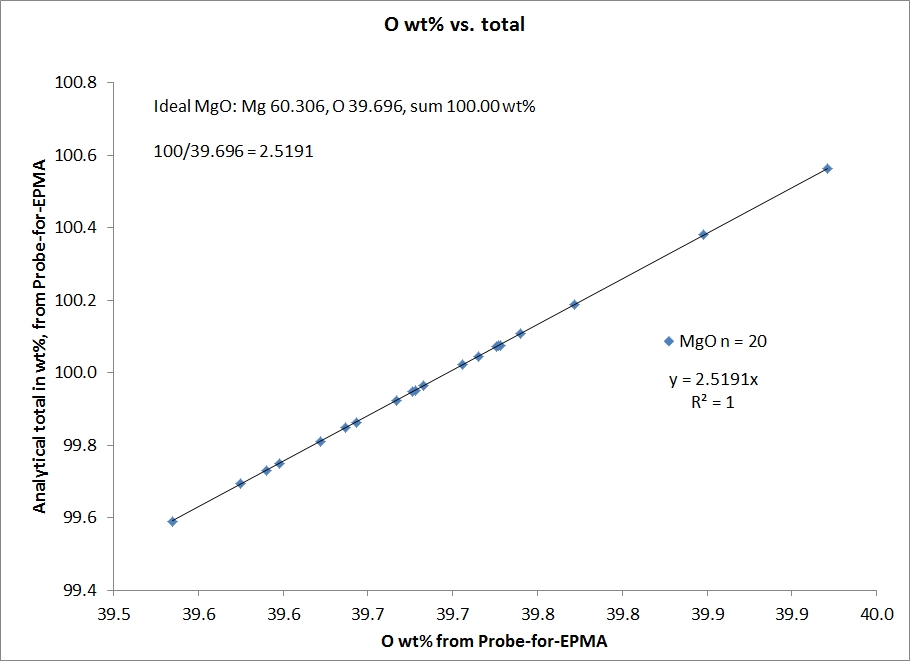

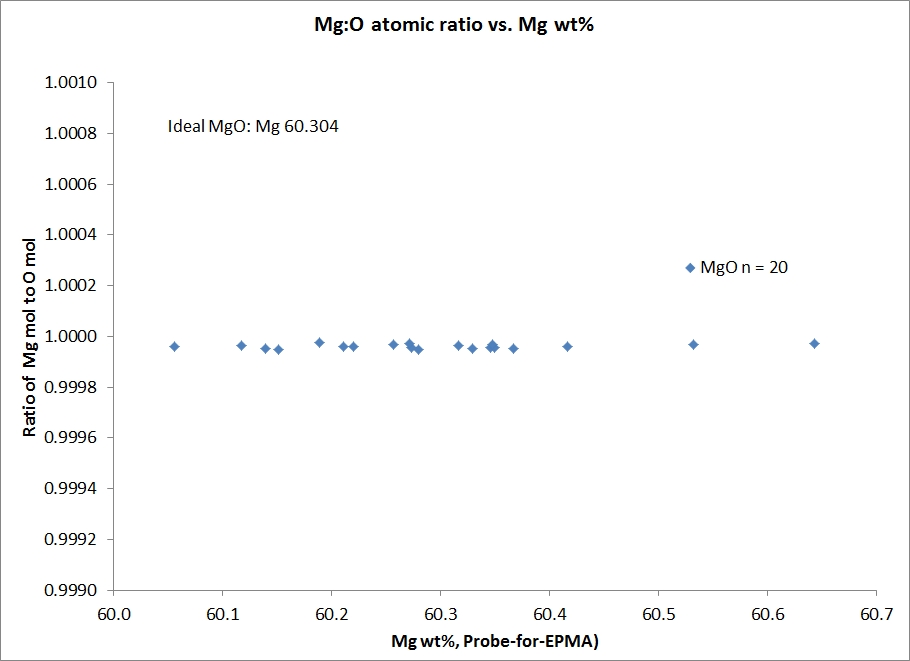

I am confused as to why (or how) oxygen is handled vs. how CO2 is handled in Probe-for-EPMA. Both are added in prior to the iterative matrix corrections (yes?). But the behaviour of a simple oxide compound seems different than that of a simple carbonate.
For example, I just measured Mg in periclase (20 points). The results are given as elements in weight percent, with oxygen calculated by stoichiometry in Probe-for-EPMA. The totals are between 99.6 and 100.6 wt%.
A graph of the oxygen wt% vs. analytical total follows the ideal ratio of 2.5191:
Probe-for-EPMA can figure out the exact stoichiometric amount of oxygen in MgO for a series of points with differing amounts of Mg (and therefore differing analytical totals).
Why are the results for the calculation of CO2 in CaCO3 any different?
Or how is it that the CO2 is handled that causes the results to differ from stoichiometry?

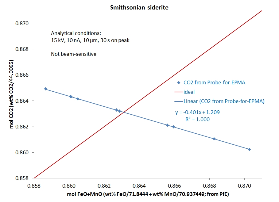

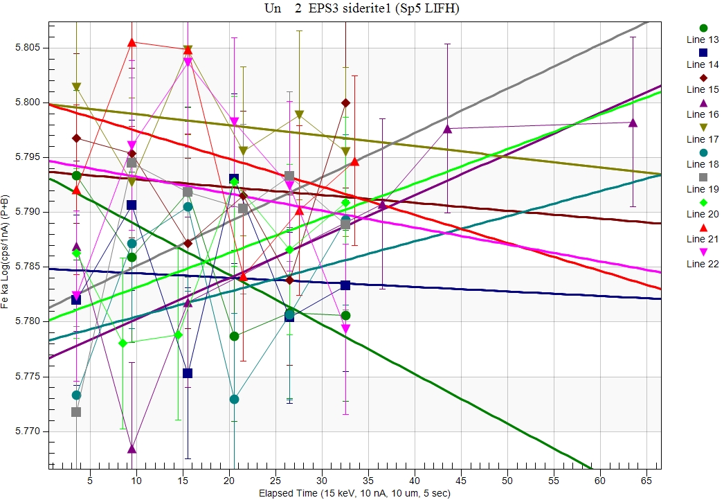

I just examined the Smithsonian siderite reference material, and ran 10 points with a 10-micron defocussed beam at 15 kV and 10 nA, with a count time of 30 s on peak, and 6 time-dependent-intensity (TDI) intervals for the Fe measurement.
The behaviour of Fe as a function of time is shown below:
As the Fe signal does not vary significantly with time, I turned off the TDI correction.
(I do not consider this siderite to be beam sensitive under the analytical conditions used here.)
The initial analytical totals range from 99.7 to 100.3 wt%.
However, the molar proportions of CO2 derived from the wt% CO2 reported by Probe-for-EPMA are negatively correlated with the molar proportions of the sum of FeO + MnO:
As I cannot attribute this behaviour to the sample, I concur with John that this is probably a result of how the CO2 is handled during the matrix corrections.

Here is the MDB file for 4 lines of 10-point analyses on Smithsonian siderite.
The material does not exhibit beam damage (no significant change of intensity of Fe with time) under the conditions used.
Also attached is the formatted Excel file of the results.
As before, the CO2 wt% results reported by Probe-for-EPMA are close to, but systematically different from, the ideal stoichiometry.

Hi Andrew,
I again return to this plot of analytical totals versus Ca concentration you posted earlier.  With some additional annotations.
I'm probably missing something, so please correct me if you see something, but it seems to me that when making a measurement of CaCO3, why would one expect to obtain the exactly correct stoichiometry for CO2, when the Ca measurement is not exactly correct?
We already know the code calculates the correct CO2 when the correct Ca is provided (relative to the standard of course). So if the measured Ca concentration is different than the expected Ca, the matrix correction will be different and the concentration of stoichiometric carbon, based on the calculated oxygen, which is itself based on the measured Ca content, will also be different.
Am I making any sense?
In fact I think the answer is laying right in front of our noses. In Reply#86 look at the ZCOR values for Ca Ka for the standard CaCO3, the slightly high total CaCO3 and the slightly low total CaCO3. I summarize them here:
ZCOR:   1.0567     ---     ---     <--- close to 100% total
ZCOR:   1.0568     ---     ---     <--- slightly high total
ZCOR:   1.0566     ---     ---     <--- slightly low total
In short, different Ca concentrations are calculated for each different case, meaning that different amounts of stoichiometric oxygen are calculated for each composition, and hence different amounts of carbon are calculated for each composition. Only when the correct Ca is measured, does the correct stoichiometric oxygen get calculated, and subsequently only then does the correct carbon by stoichiometry to oxygen get calculated.
What do you think?

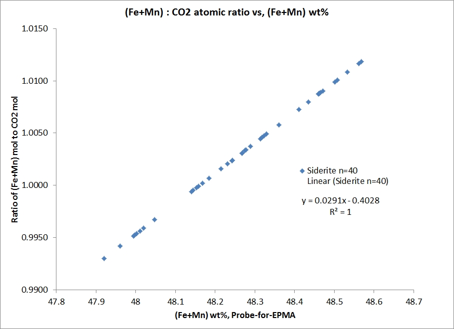

Let us look at how Probe-for-EPMA handles a binary oxide, MgO, in comparison to a simple carbonate, siderite (Fe,Mn)CO3.
In the case of MgO, I measured the Mg K-alpha intensity for 20 points, and for the usual reasons, we have uncertainty in the results. The Mg concentrations range from 60.05 to 60.65 wt%, and the analytical totals from about 99.6 to 100.6 wt%.
However, regardless of this analytical uncertainty, for every point, Probe-for-EPMA reports oxygen-by-stoichiometry in the ideal ratio of 1:1 (with rounding in the fifth decimal place):
In the case of siderite, I measured the Fe K-alpha and Mn K-alpha intensities for 40 points, and for the usual reasons, we have uncertainty in the results (but beam damage was not an issue). The (Fe+Mn) concentrations range from 47.9 to 48.6 wt%, and the analytical totals from Probe-for-EPMA are reported between 99.7 and 100.4 wt%.
However, Probe-for-EPMA reports CO2-by-stoichiometry as a function of concentration!
Only when the concentration is extremely close to 100.00 wt% is the correct, stoichiometric, amount of CO2 reported.
So, in the case of MgO, regardless of analytical uncertainty, the stoichiometric ratio of 1:1 Mg:O is maintained.
But in the case of a carbonate, such as calcite CaCO3 or siderite (Fe,Mn)CO3, stoichiometry is not maintained.
Rather, the proportion of CO2 reported by Probe-for-EPMA is a function of concentration.
To follow up on your above post:
"In short, different Ca concentrations are calculated for each different case, meaning that different amounts of stoichiometric oxygen are calculated for each composition, and hence different amounts of carbon are calculated for each composition. Only when the correct Ca is measured, does the correct stoichiometric oxygen get calculated, and subsequently only then does the correct carbon by stoichiometry to oxygen get calculated."
Yes, in Probe-for-EPMA, different amounts of Ca result in different amounts of C and O being calculated.
Unfortunately, they are not calculated in the stoichiometric ratio for CaCO3 where Ca : C : O should be 1:1:3.
The question is why do we see this behaviour?
We need to look into the matrix correction code more closely.
