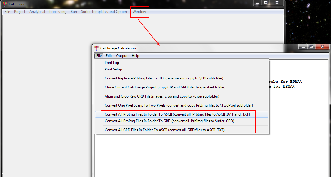

Hi Remi and Ben,
I added several new file conversion menus to the CalcImage "log window" as seen here:
Basically for the conversion to ASCII, the .TXT file contains only the intensities as tab delimited values.  The .DAT file contains a number of useful values in addition to the tab delimited intensities as seen here in this example:
"C:\UserImages\Carpenter\Wi-108-2b_00423_SP1_Na_TAP_.prbimg"
800   800
15   0.05
100.05   100.05
14.331   11.934   53.6757   51.2787
Where the first line is the full path to the file, the second line is the X and Y pixel dimensions, the third line is the keV and pixel dwell time in seconds, the fourth line is the before and after beam current in nA, and the fifth line is the stage extents of the map in millimeters (XMIN, XMAX, YMIN, YMAX).
The latest version of PFE (update from the Help menu), contains these new CalcImage menus.  Please let me know if you need any additional changes to this output.
