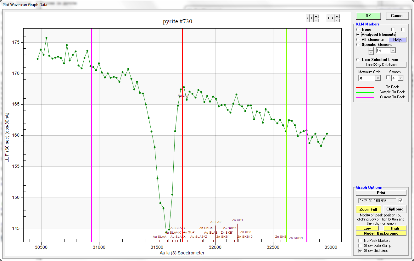

I always find something interesting when teaching the EPMA class here in Oregon.  This year the students and I ran some tests of measuring trace Au, Cu and Ag in pyrite and we found a number of interesting stories to tell.

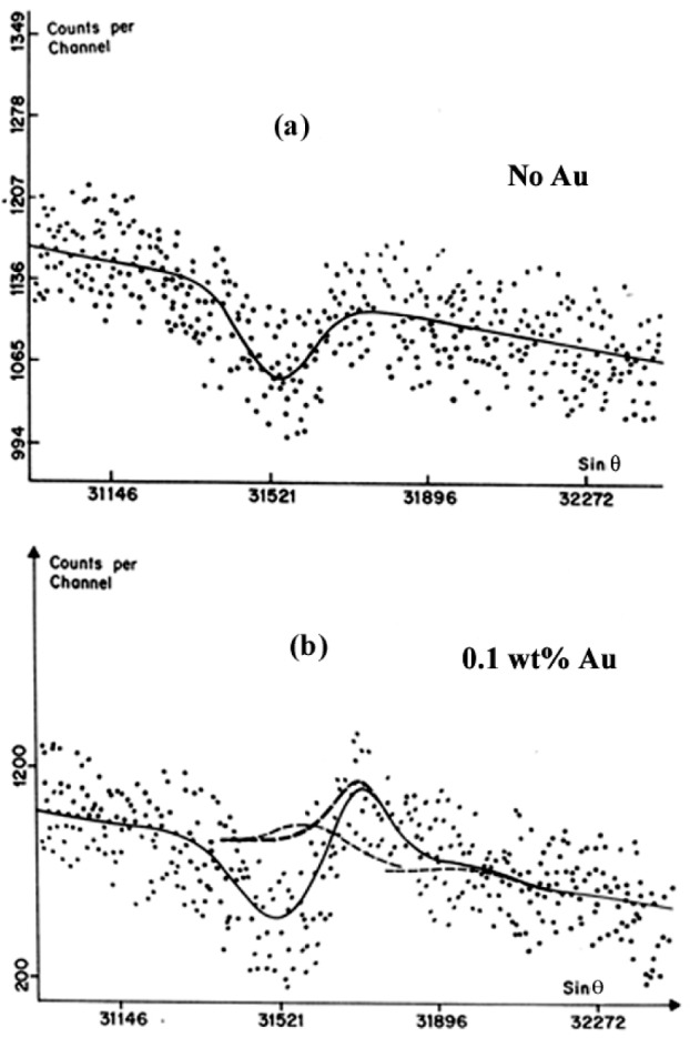

The classic one that many have noted is the "hole" in the continuum for Au La on an LiF crystal as reported by Self et al. (Self PG, Norrish K, Milnes AR, Graham J, Robinson B. Holes in the background in XRS. X-Ray Spectrom. 1990;19:59–61) as seen here:
Since instruments have improved slightly since then, we have the following scan on pyrite using a 60 sec per point wavescan:
One might suspect that this could be a sample absorption edge (since Au La is at 9.7 keV and the Fe absorption edge is 7.1 keV though that isn't close enough, but if we perform a similar scan on say Ti metal, we see the same "hole" in the continuum as seen here:
So the "hole" in the continnum is another Bragg crystal secondary diffraction position, similar to the hole in the continuum underneath the Ti Ka peak position on PET Bragg crystals.

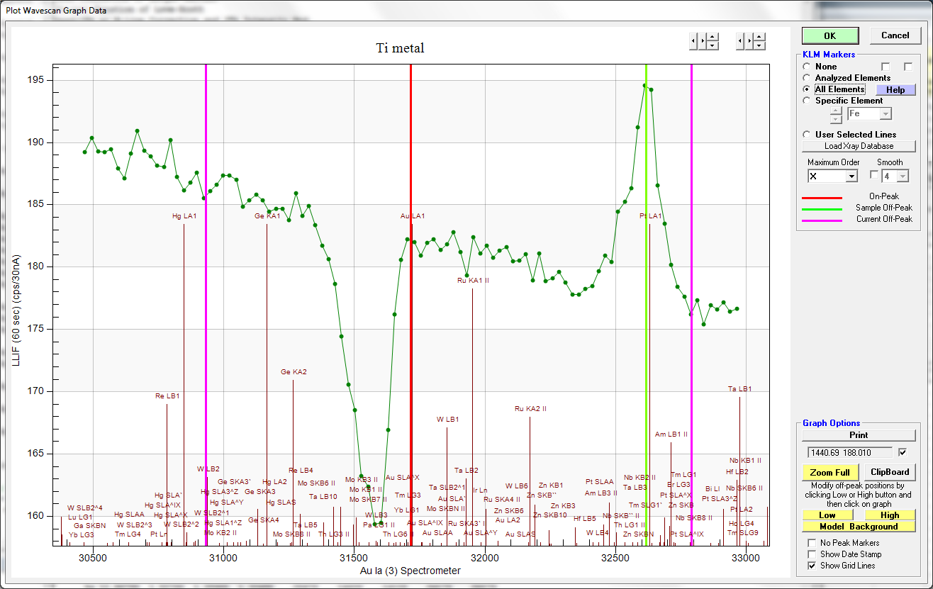

So what gets interesting is this: what is that other peak in the scan on Ti metal?  If I plot all the element KLM markers I get this plot:
Could it actually be Pt?  I don't think so, but maybe I should check.  What else could be a trace element in Ti metal at this position?
I beginning to think that all my Bragg crystals are getting strange artifacts...

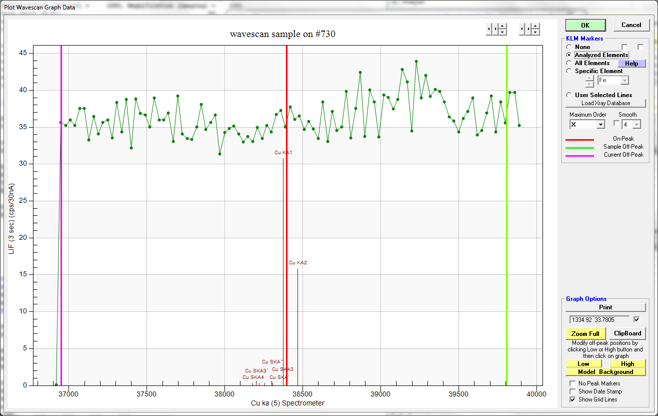

Here's another weird story from the EPMA class run looking at Au, Cu and Ag in pyrite. After peaking the LiF spectrometer on pure copper, we ran a quick WDS scan to check our bgds for interferences. This wavescan on our pyrite standard (with 70-100 PPM Cu from AA and XRF) was 3 sec per point:
So we thought : OK, looks like we have no off-peak interferences. So we ran quant on the pyrite and we got this:

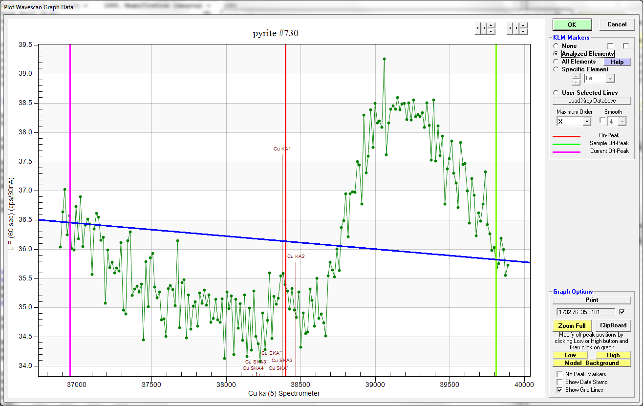

So we ran a longer scan at 60 sec per point on our pyrite and saw this:
Look at the bgd interpolation- no wonder we are getting negative 800 PPM. But what the heck is this peak?  It's too wide for a normal emission peak I would think.  Any ideas?

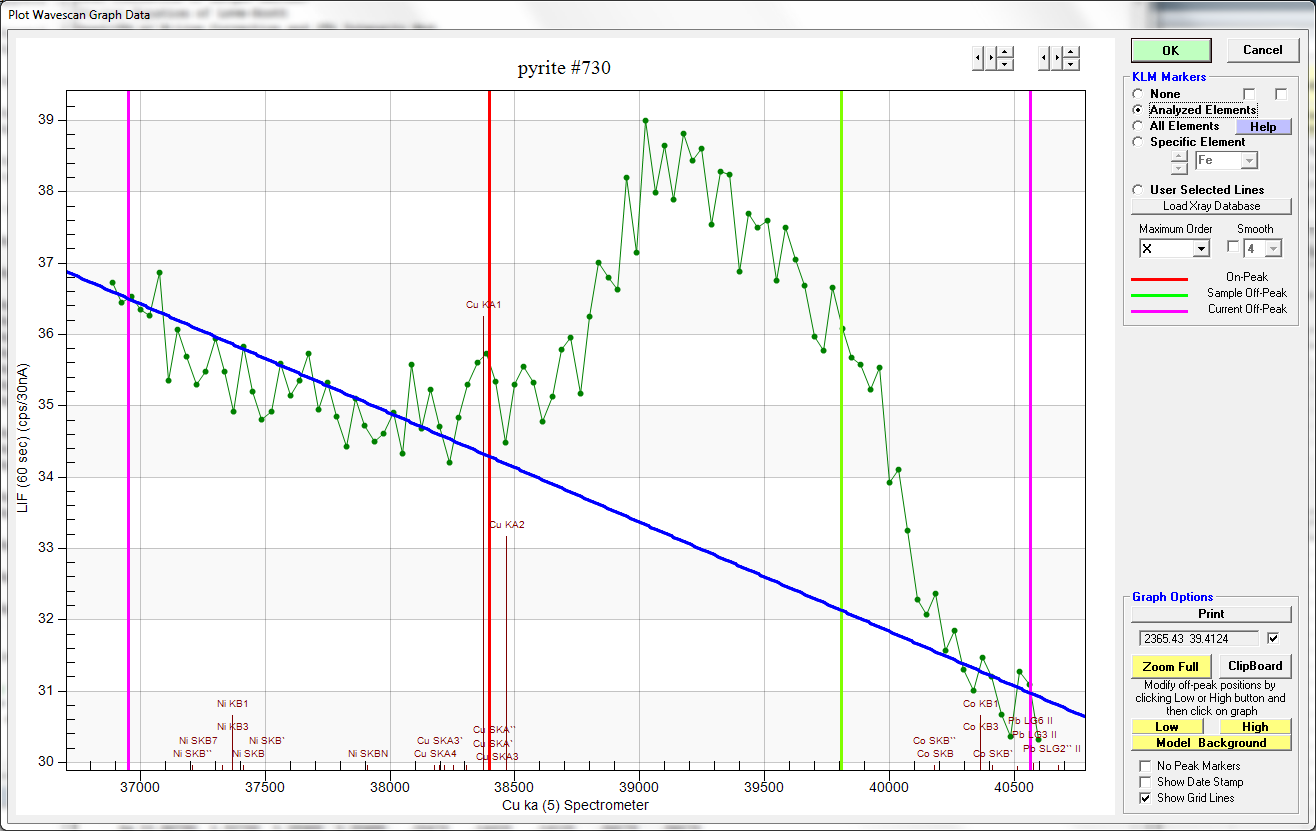

Scanning wider so we can set the high side bgd properly we see this:
This gives us results consistent with AA and XRF as seen here:

But what is this peak?  Does anyone else see it on their instrument?

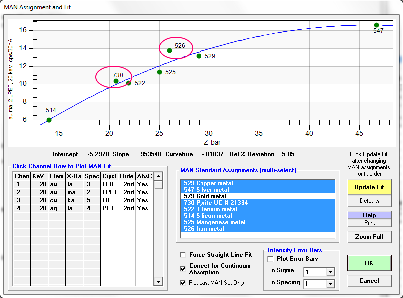

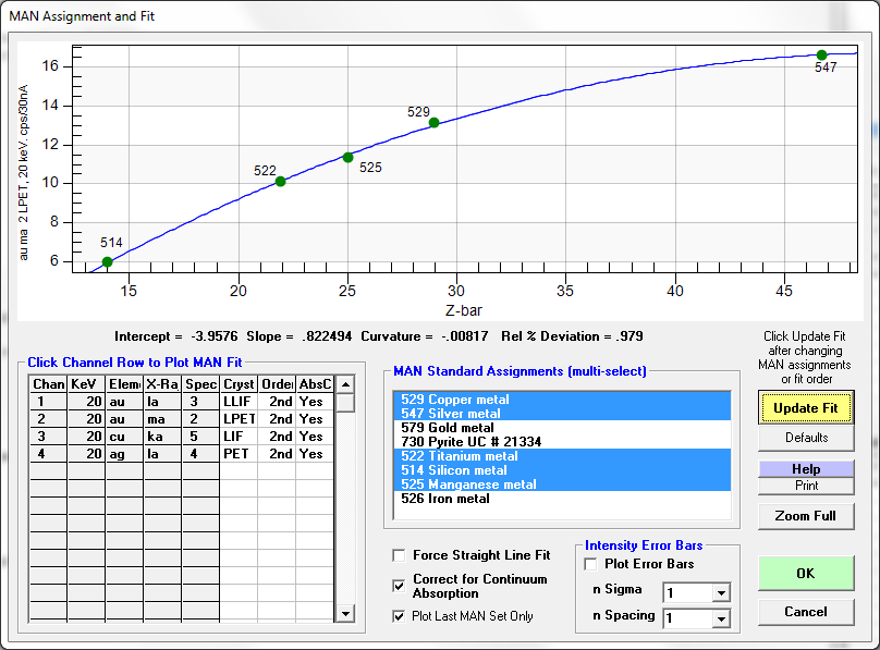

Because I also acquired a few other pure metals for an MAN bgd calibration I noticed this on the MAN calibration for the Au Ma on PET:
That is the thing about the MAN background calibration. Sometimes it tells you about trace contaminants in your standards, sometimes it tells you about subtle spectral interferences in your sample!  All useful stuff to know about. So then the class looked at our scan data for Au Ma on pyrite and noticed this:
This interference causes an additional 70 PPM of interference. We can't correct for this interference in this particular run because we didn't measure Fe, just the traces, but by simply removing the Fe containing standards from the MAN fit, we get a much nicer MAN curve for Au Ma as seen here:

With regards to your peak in Ti metal, given the starting materials are usually ilmenite, rutile, leucoxene etc, you would be looking for elements that occur naturally in those minerals I guess. But looking at the "All Elements" selected there on your wavescan really the only elements that coincide with that peak that might make sense are perhaps Nb or Ta. It could be another one of those mystery peaks like on PC0...

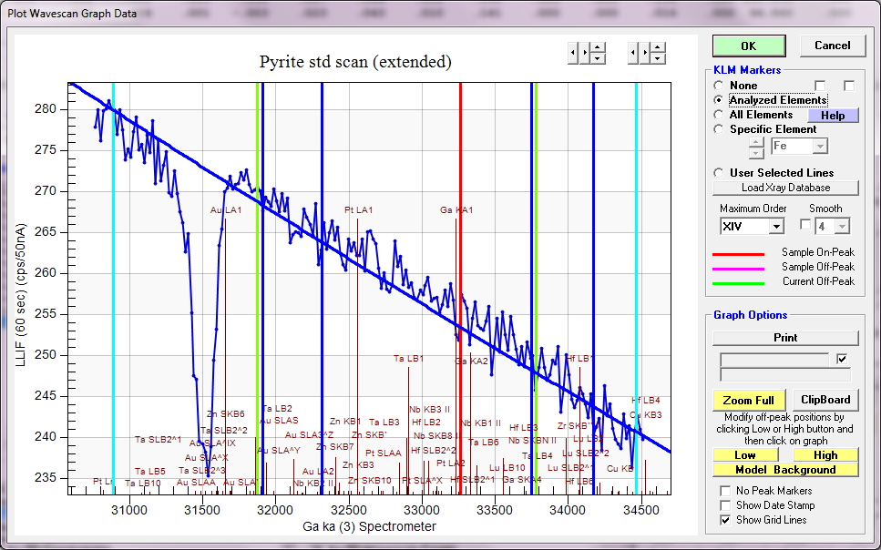

Even if one isn't measuring Au in an iron matrix, one should still be careful to avoid the "hole" in the continuum near the Au La emission line position for other elements:
At least for their background positions. This is a scan of Ga Ka in FeS2, showing the multi-point background measurement positions (in light blue and dark blue- light blue being the MPB positions that are available for adjustment).
