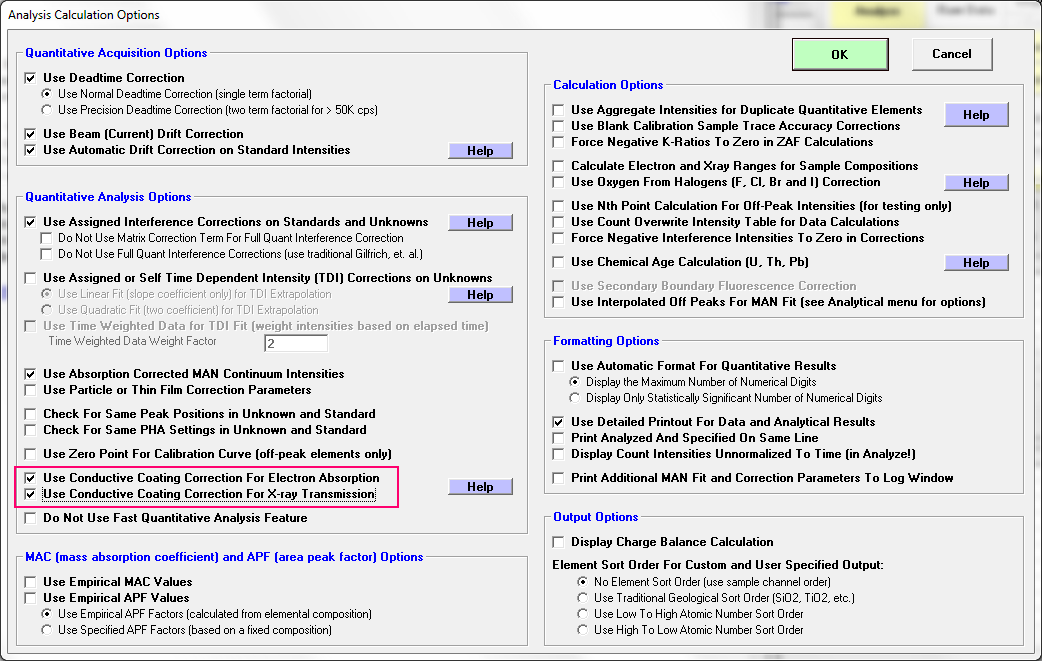

Anyway, the above output clearly shows the need to specify the carbon coat for the standards and turn it off for the unknown.  For the unknown this is easily done from the Calculation Options dialog by unchecking the "Use Unknown Conductive Coating" checkbox.  For the standards one needs to use the Standard | Edit Standard Coating Parameters menu, but by default they are set to 200 nm of carbon at 2.1 gm/cm3.
Then one has to go into the Analytical | Analysis Options dialog and explicitly turn on the conductive coating correction by checking these two checkboxes:
Once that is done we should be OK (or should we?), and we now obtain this analysis:
