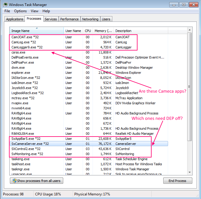

Also just wanted to add that PeakSight seems to be running fine now with DEP set to the "OptIn" parameter, which is most of the basic DEP protection enabled. In summary, Cameca says to issue this command to completely turn off DEP:
bcdedit.exe /set {current} nx AlwaysOff
but it would be much safer to issue this command for DEP protection if you are connected to the Internet (or have students inserting USB sticks into the PC!):
bcdedit.exe /set {current} nx OptIn
I might try this DEP command next:
bcdedit.exe /set {current} nx OptOut
and then just see how PeakSight runs.  If PeakSight continues to run fine with the DEP OptOut parameter, then we are good.  If PeakSight locks up the PC again, we could turn off DEP only for the problematic Cameca app(s). Maybe just the Cameca Server exe file?  Does anyone know what specific app of their's that Cameca is worried about that they want DEP turned off?
