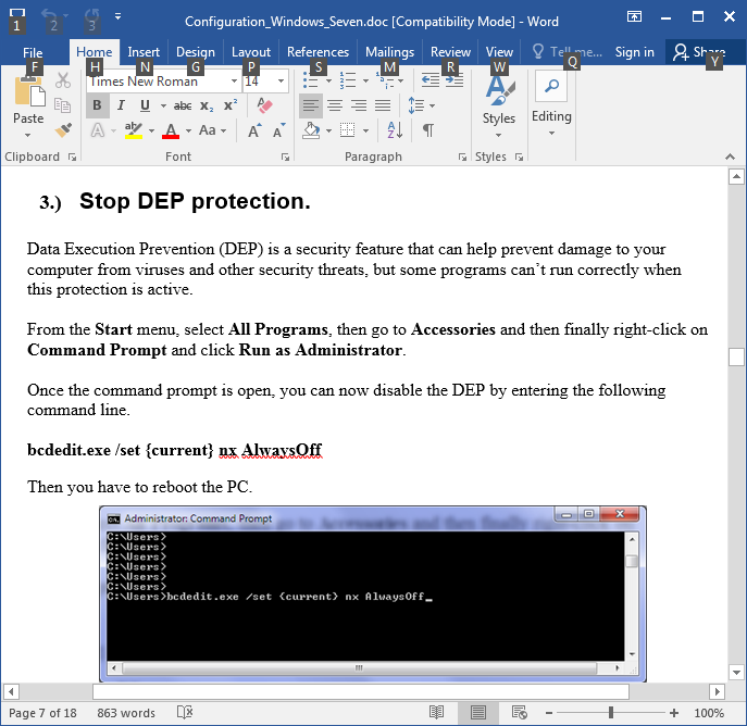

But here's the thing: the Cameca instructions want us to issue the following instructions:
But this appears to us to turn off DEP for all apps and services.  However, in the Microsoft tech link above it offers the following suggestion to turn off DEP only for a specific application:

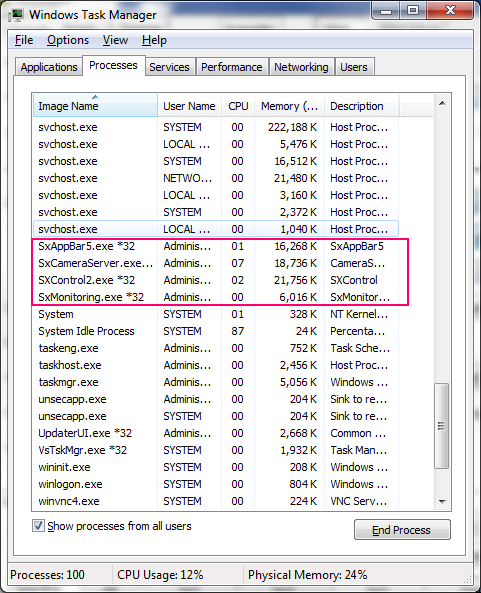

Ok, we may have been successful using the DEP GUI to turn off DEP for the Cameca PeakSight apps. PeakSight now seems to be running fine...
But let me provide some additional info, because the Microsoft link I posted previously didn't provide much details, so here is what we did on our Win 7 system:
1. Right click on My Computer or the Computer icon in Explorer and select Properties. This opens the Control Panel | All Control Panel Items | System window.
2. Next click the Advanced system settings link in the upper left. That opens up the System Properties window.
3. Next click on the Advanced tab and click the Settings button. That opens the Performance Options dialog. This is the window shown in the Microsoft link above.
4. Now click the Data Execution Prevention tab. You will see the DEP GUI. We had originally thought we would use the "Turn on DEP for all programs and services except those I select" option, but Windows informed us that most of the PeakSight apps could not have DEP turned off. So instead we used the option "Turn on DEP for essential Windows programs and services only" and that seems to have done the trick.

PeakSight ran for about 6 hours or so, but then locked up Windows completely again. So I guess we have no choice but to turn off DEP completely on the Cameca computer using the command suggested by the Cameca documentation:
Dang, too bad.  We were hoping to leave DEP on for better protection from malware but apparently that won't be possible with PeakSight.   I hope our anti-virus software is up to the task.

We thought when we turned off DEP using the command prompt above that Cameca documents in the installation instructions, that it would solve the problem with PeakSight locking up the computer.  But within a few hours of PeakSight running, the Cameca computer was totally locked up again, keyboard, mouse, everything. Power reset again.
So we went ahead and implemented all the UAC and RegisterBase mods that the installation document specifies, but yet again, after a few hours of running PeakSight, the Cameca computer is totally locked up, requiring a power reset to re-boot the computer.
