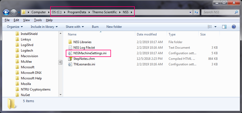

Anyway a couple of pointers on a new Thermo Pathfinder install. To my knowledge the only thing that actually needs to be done manually for the installation of the new Thermo Pathfinder software for off-line reprocessing, is to edit the NSSMachineSettings.ini file which is found here under the ProgramData folder (remember it is usually a hidden folder in Windows!) as seen here:

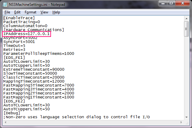

Then edit the IPAddress keyword for the "loopback" address (there's no place like home!) so the software knows that it is running without an actual EDS detector as seen here:

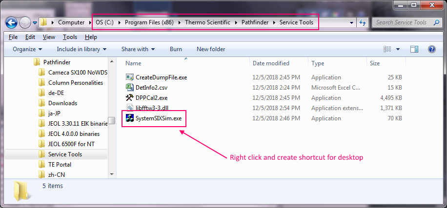

Now for best results (e.g., running the Pathfinder software in simulation mode) one should also make a shortcut on their desktop for the simulation interface app (which is still called SystemSIXSim.exe). This allows the Pathfinder software to run in simulation mode. I'm not sure this is actually necessary for off-line processing but it is fun to play with.
Then one just double-clicks the SystemSIXSim.exe shortcut to start that, then double-click the Pathfinder shortcut that the installers made which is also on the desktop and open a new or existing Thermo project.

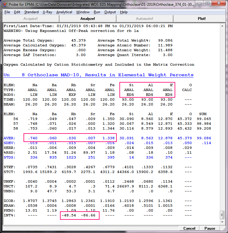

OK, this is interesting.  After I fired up Probe for EPMA I ran some integrated quant analyses and got some nice results for traces in my orthoclase standard as seen here:
But, but, but... I should not have been able to do this because I didn't manually copy over the teportal.dll and socketdll.dll files from the Thermo TE Portal folder to the Windows\SysWOW64 folder, as we have always done in the past (so Probe for EPMA and Probe Image can find the TE Portal interface)!

Just as an aside, note that this quant utilized Si by EDS for the interference by silicon on Sr La (by WDS), and also utilized K by EDS for the interference by potassium (satellite II order) on Rb La (by WDS).   8)
