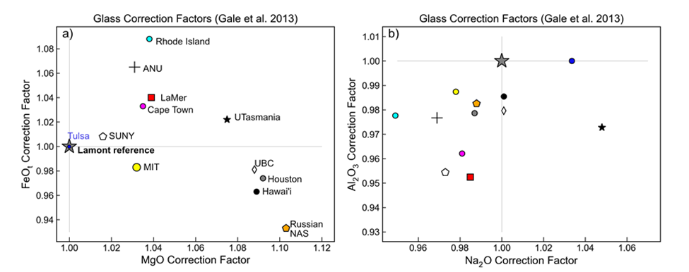

2. Checking inter laboratory reproducibility and accuracy: the immediate concern here is that we already know that there is a problem as demonstrated in the "Barometers Behaving Badly" paper by Wieser et al.:
Wieser, Penny E., et al. "Barometers behaving badly I: Assessing the influence of analytical and experimental uncertainty on clinopyroxene thermobarometry calculations at crustal conditions." Journal of Petrology 64.2 (2023): egac126.
as shown in this figure from the paper:

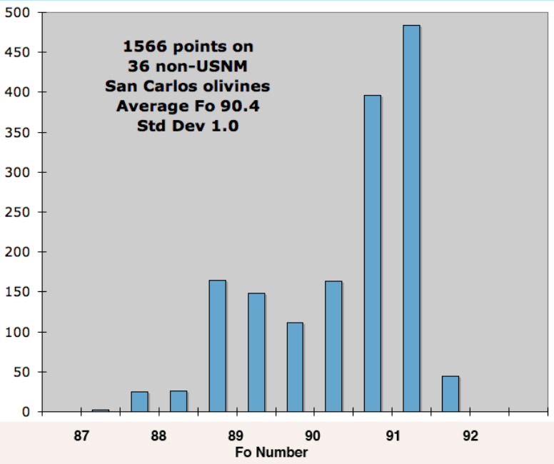

And the one thing we also know is that different labs tend to use different primary standards for their analyses. And even if these labs using natural standard materials (e.g., Kakanui augite, etc.) are ostensibly using the same primary standard material, we know that these labs are definitely not using the same grain, and we also know that many of these natural standard materials are not homogeneous, as shown in this figure by Will Nachlas and John Fournelle:
So, the first problem (in addition to the spectrometer alignment (effective takeoff angle) and dead time accuracy problems described in the previous post), are our choices of primary (and secondary) standards. Standard choice is critically important is obtaining agreement with other EPMA (and SEM) laboratories and we will discuss this first:

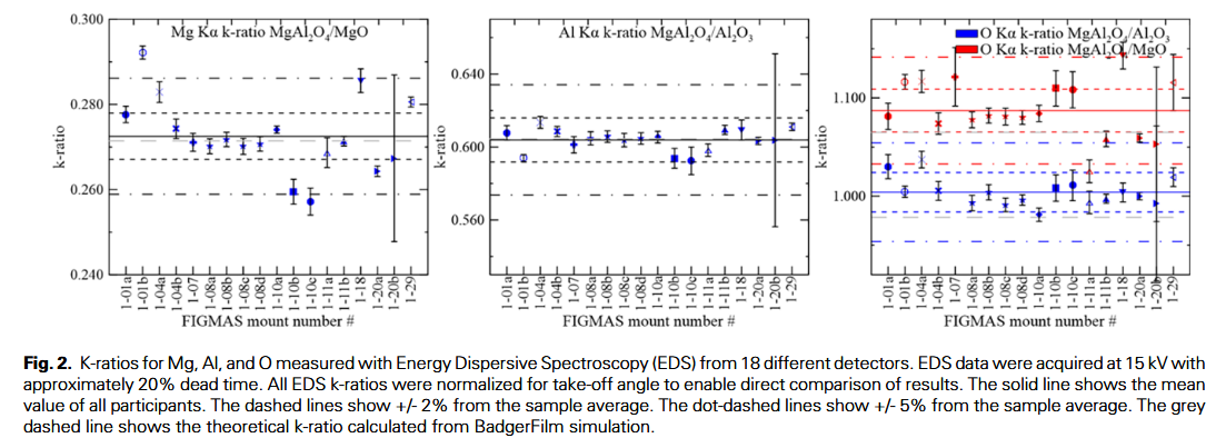

Would you be willing to lead a study on this?  It seems to me that it should be pretty straight forward to get EMSA spectra from every vendor and process with both DTSA2 and the OEM software.  The problem being once again, global standards.
But we do already have a number of mounts already distributed by Will Nachlas with high purity synthetic Al2O3, MgO and MgAl2O4. Here are the EDS results from various labs that Will obtained:
See here for the full paper:
https://academic.oup.com/mam/article/29/Supplement_1/225/7228643
Would you be willing to contact Will and see what raw data he has for these EDS measurements?
