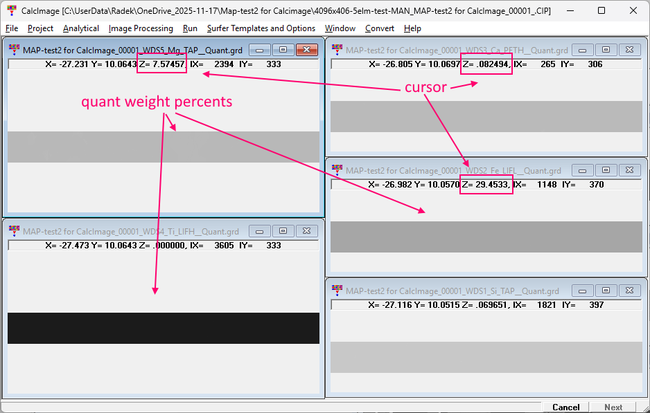

Now here after the x-ray map quantification is completed (which takes a while with 1.6 million pixels!):

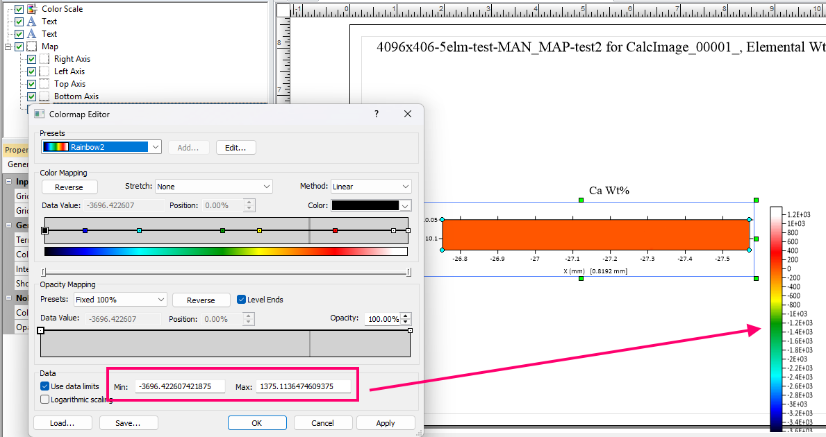

So where is the concentration data?  It's there as one can see from the cursor tracking Z values, but something is wrong. Let's open these maps in the Surfer (or Classify Image Exporter) application:

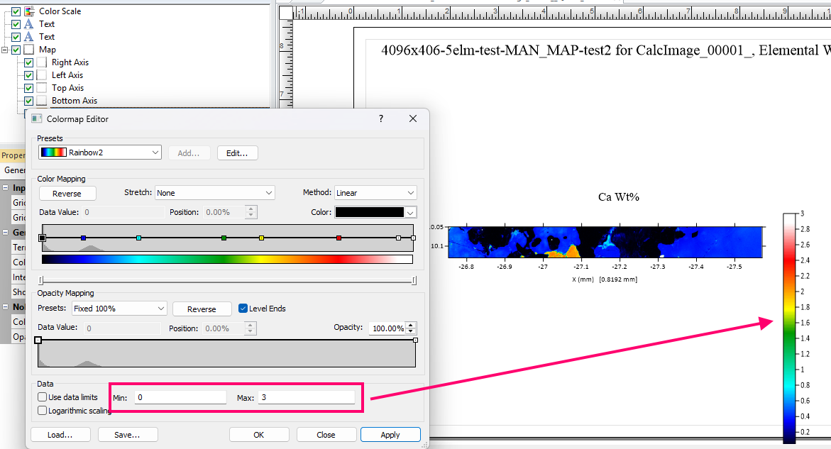

What we see is that the min and max Z data range is way too large. This is caused by these few "crazy" pixels with very poor counting statistics. But by editing the min and max we quickly discover the actual Z range, in this case from around 0 to 3 wt%:

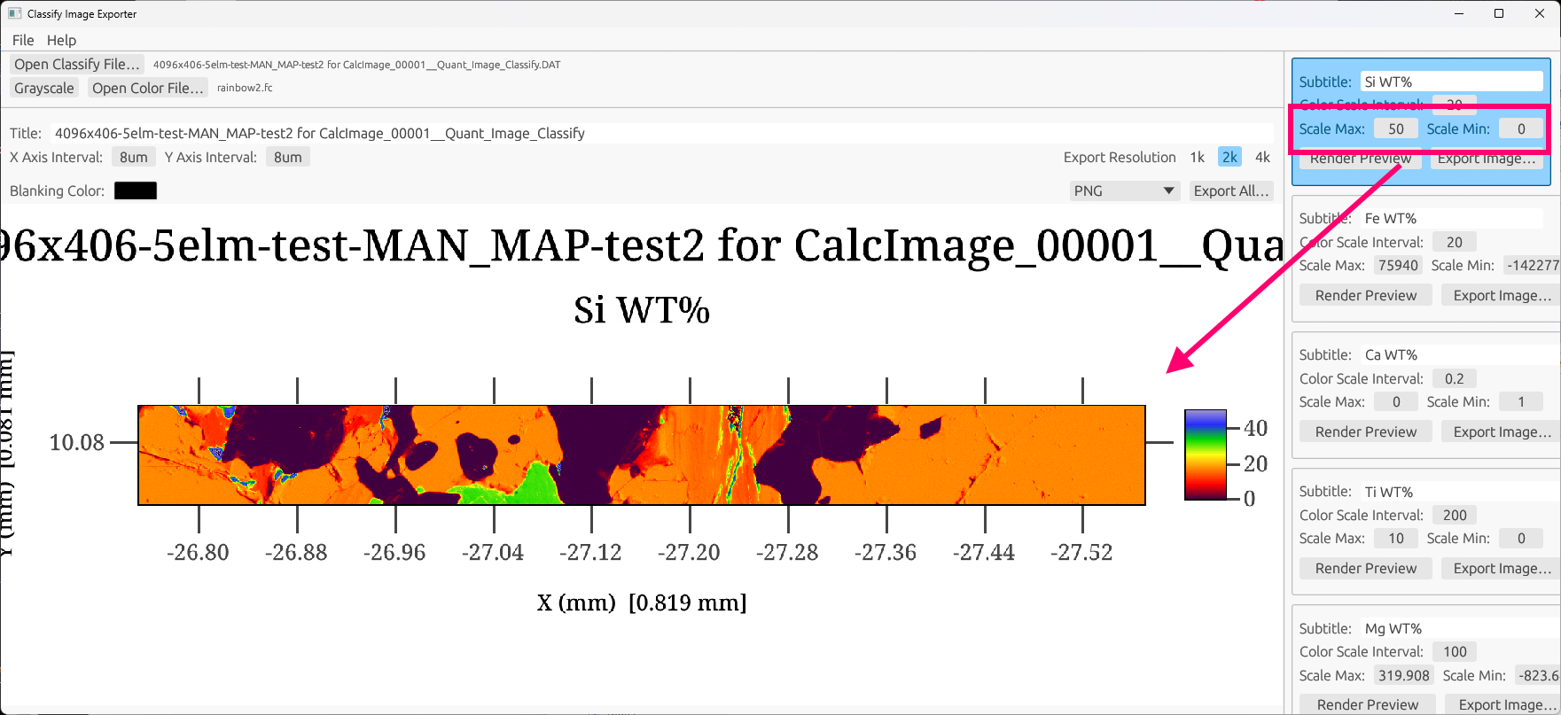

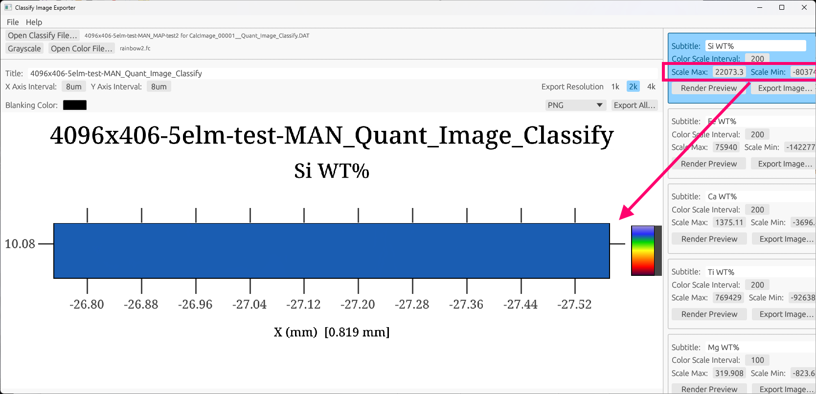

The very same applies to using the Classify Image Exporter app, here the raw quantified maps:
and here after the Z scale is adjusted:

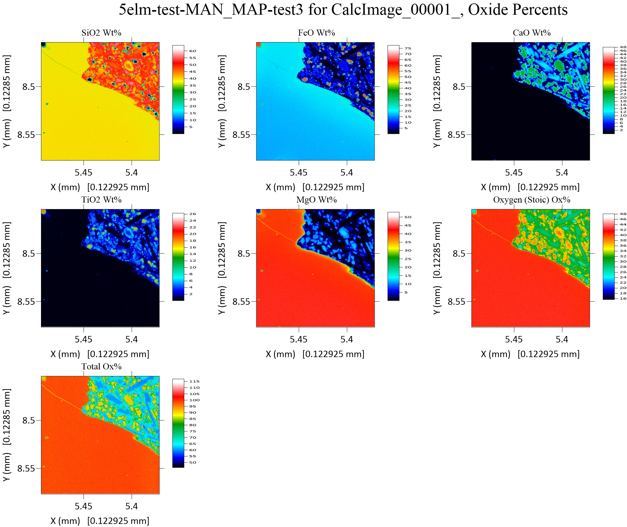

So then we decided to cut these maps down a little smaller using the Surfer Grid Extract menu to 3072 x 3072 pixels, so 9 million pixels each, using MAN backgrounds, and that worked:
Note that the pixel totals of the large (olivine) phase are very close to 100%, (the multiphase material has some elements missing apparently).
This was using 15 keV, 100nA and 15 millisec per pixel. These 4096 x 4096 maps took about 75 hours to acquire, while the 3072 x 3072 maps took about 17 hours to quant using MAN backgrounds.
But nice that 15 millisec at 100 nA (or no serious cracks or voids?) was enough to eliminate any "crazy pixels"!
