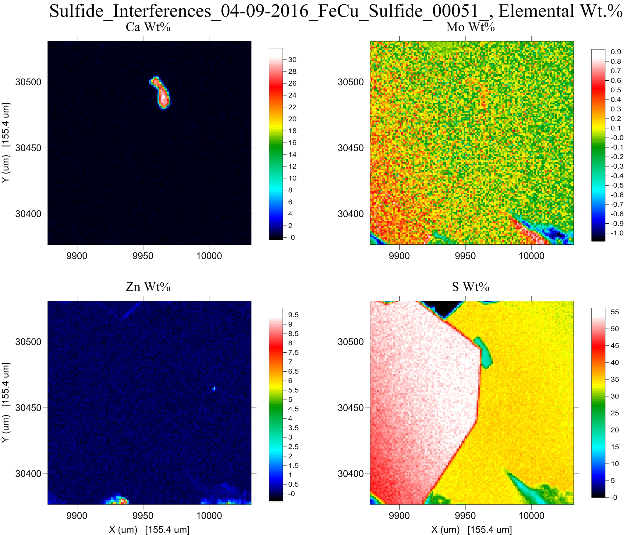

And here are the two minerals again, but this time *with* the interference correction of S on Mo (and also Cu on Zn though it is very small):

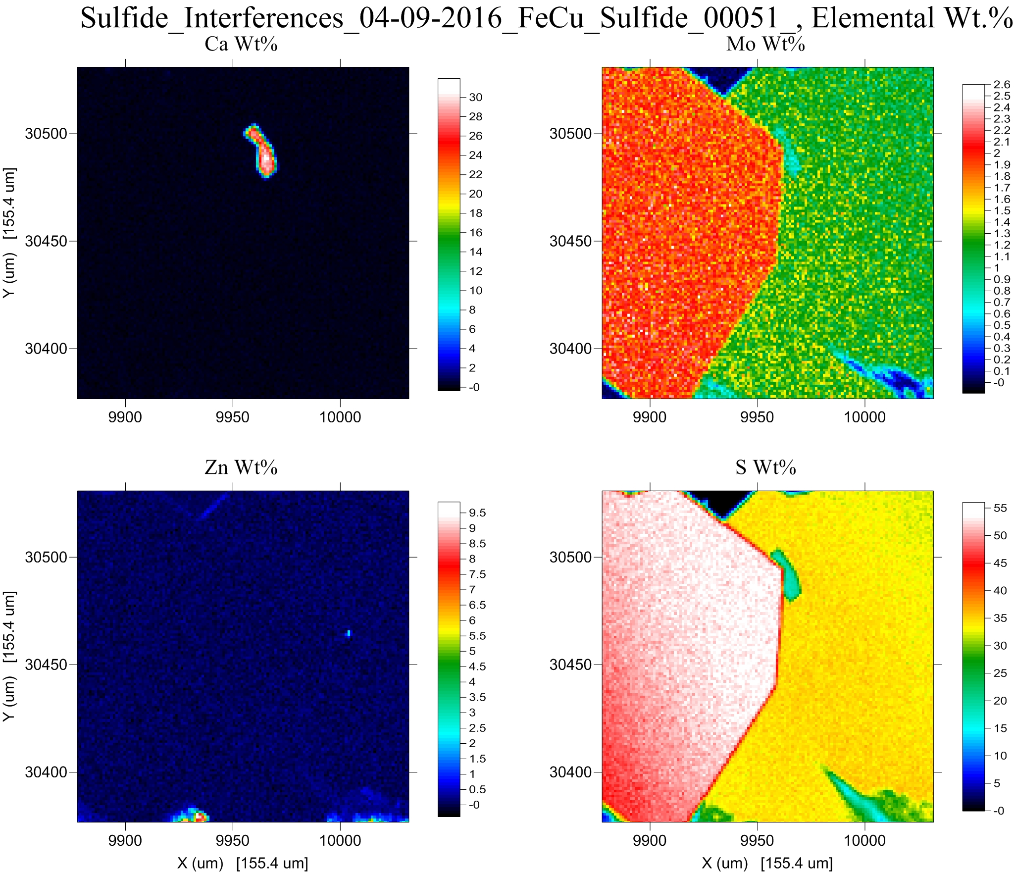

In the meantime here are the Mo and S maps *without* an interference correction:
Note the large Bragg defocussing on the sulfur map.  This causes a problem with the quantitative interference correction for Mo, though it does try hard as seen here in the interference corrected maps:
The interference corrected Mo concentrations are quite close to zero (yellow-green) for much of the pyrite and Cu-Pyrite grains, except in the lower left corner where most of the Bragg defocusing occurs.  I'll try again with a stage scan next weekend at 100nA.    :D

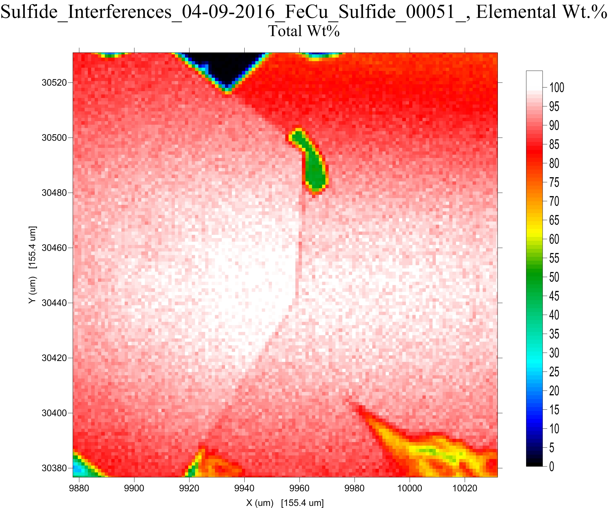

Here's an interesting aspect to the quantification of maps with Bragg defocussing.
In the *total* map, the Bragg defocussing from the various spectrometers almost, kinda averages out and forms a high spot of 100% or so, in the middle of the map.
Exactly as one might expect!

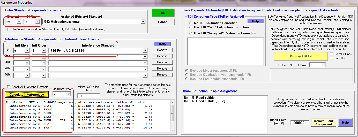

In the meantime, please note that this quantitative spectral interference correction is a quick and easy, two or three mouse click operation, once the data is acquired as seen here:
Simply click the interfering element (S), the standard used for the S Ka interference correction (pyrite) and OK.  The Calculate Interferences button is an optional mouse click, which is used only to see if the suspected interference is nominally possible.

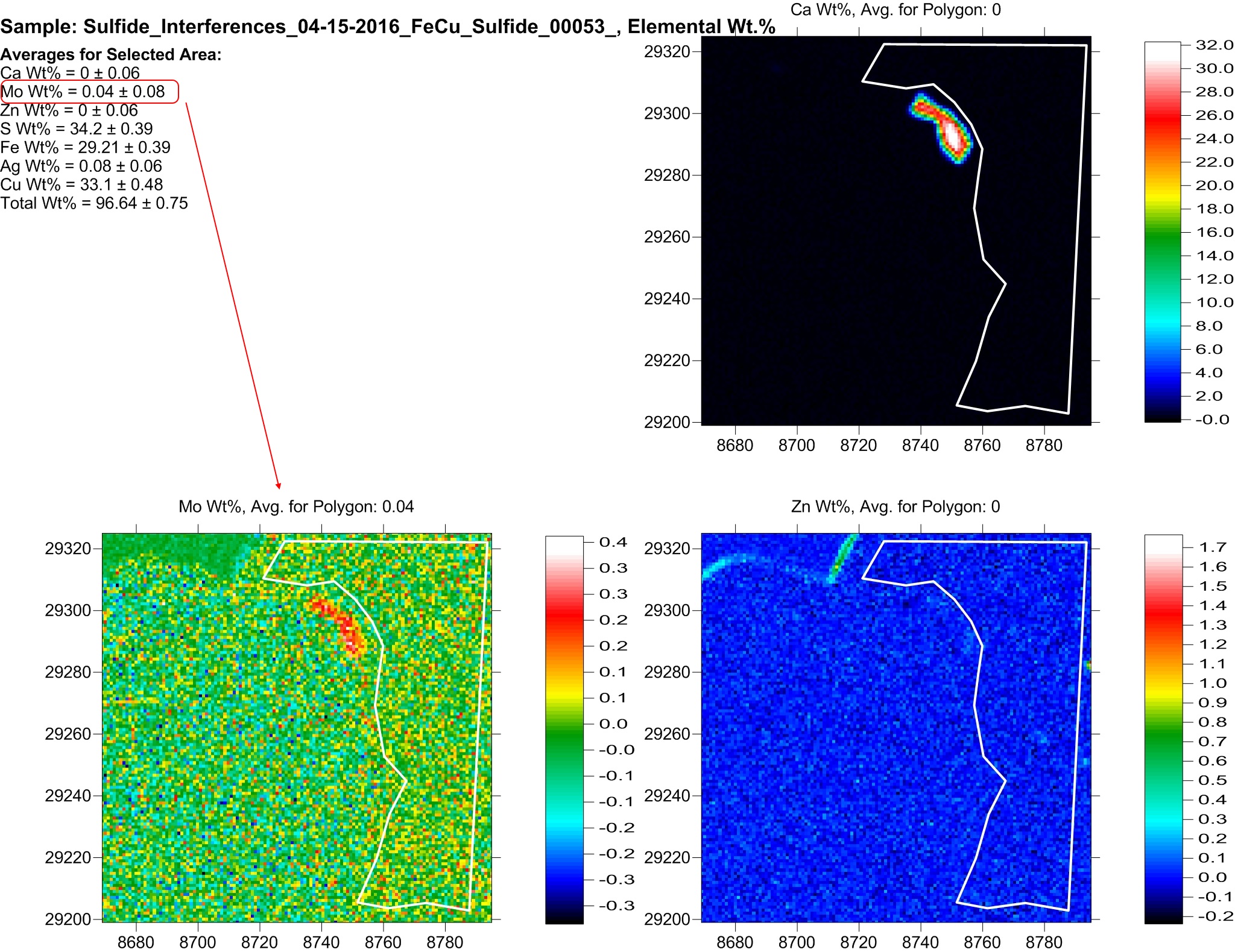

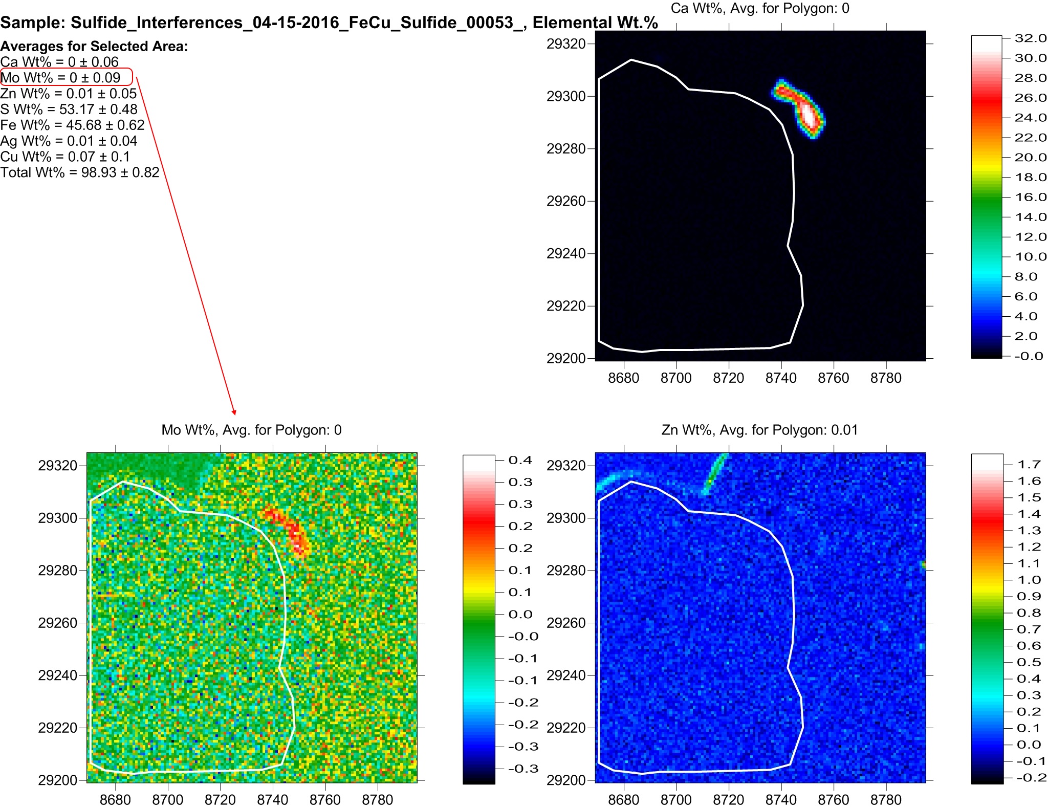

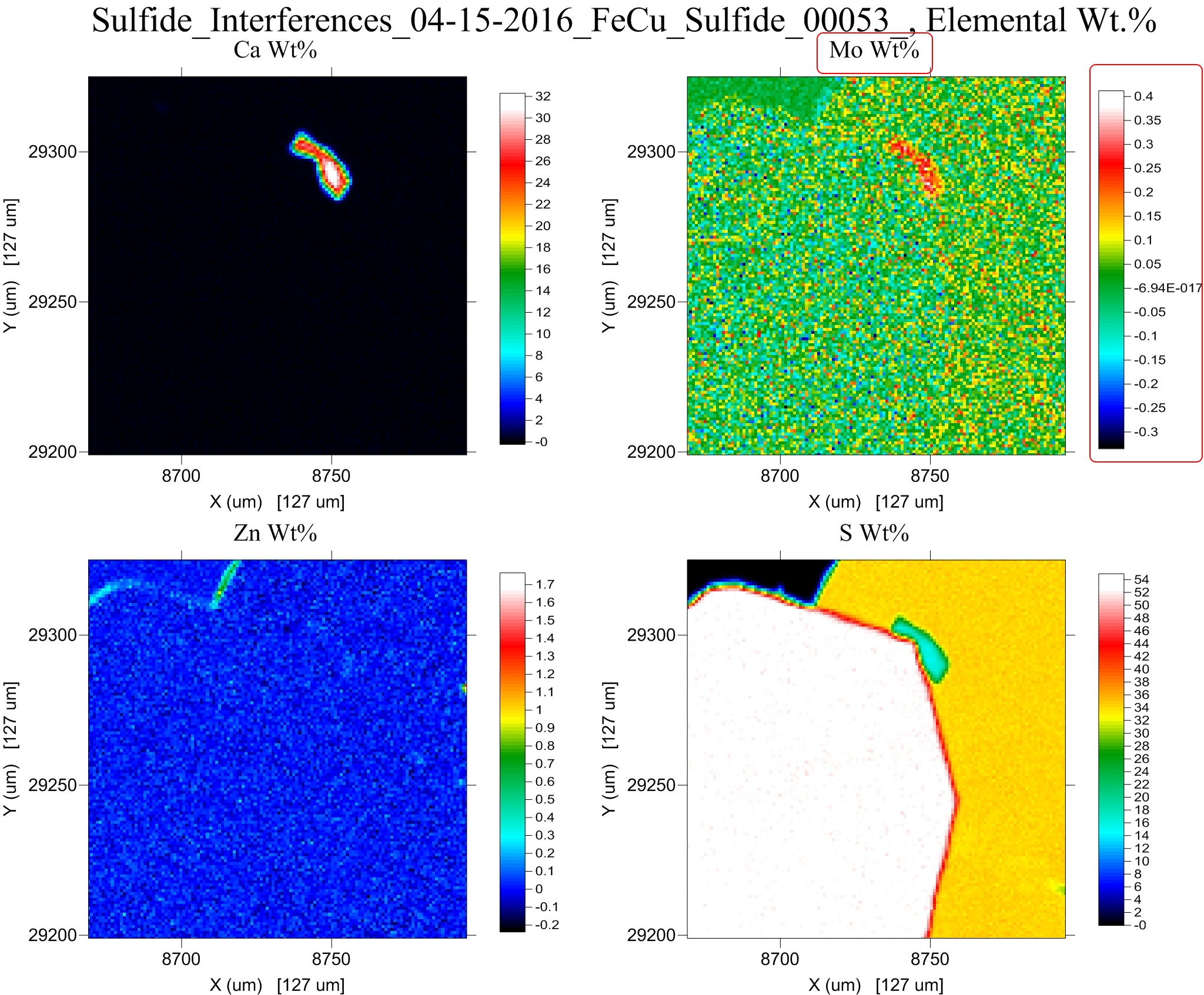

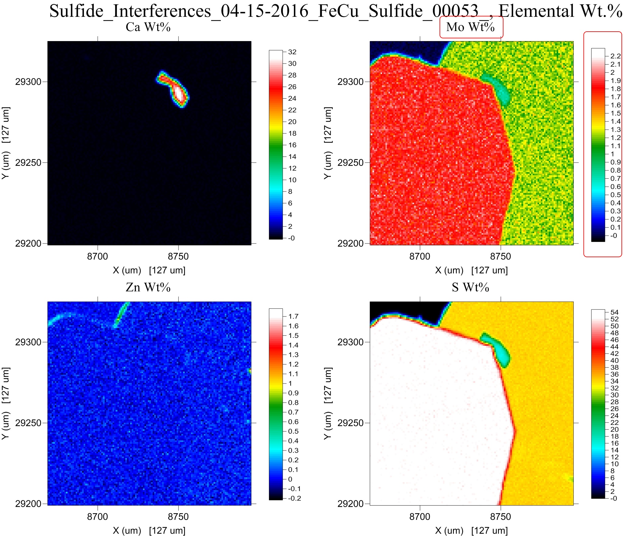

OK, the stage scan finished and here are the results. Again standards (FeS2 for sulfur, diopside for Ca, pure metals for the other elements), were run at 15 keV, 30 nA and the stage scan at 15 keV, 100nA, 1 um pixels. All data was automatically corrected for deadtime, beam drift, standard drift, background, and matrix corrected.
First without any interference correction:
Without an interference correction the pyrite shows roughly 1.8 wt% Mo and the Cu-pyrite shows roughly 1.2 wt% Mo. Now with the quant interference correction as described in the above post:
We are now seeing almost no Mo in either phase, however, to the eye, there does appear to be some small non-zero amount of Mo in the Cu pyrite phase on the right.  Let's do a polygon extraction using CalcImage, first the Fe pyrite phase:
We get 0 +/- 0.09 wt.% Mo. Can't do much better than that if the concentration is zero! In the Cu pyrite we get this:
The Cu pyrite phase shows 0.04 +/- 0.08 which is statistically zero, but the eye confirms that there does appear to be some very small concentration of Mo- which is confirmed by the point analyses in the above posts which gave ~200 PPM Mo in the Cu pyrite phase.
Attached below (you'll need to log in to see them) are the quant and detection limit maps for Mo.
Note that although the 0.04 +/- 0.08 Mo wt. % in the polygon extraction of the Cu pyrite phase is below the Mo 3 sigma detection limit of 700 to 800 PPM, the eye picks up the subtle difference in the Mo quant map attached below:

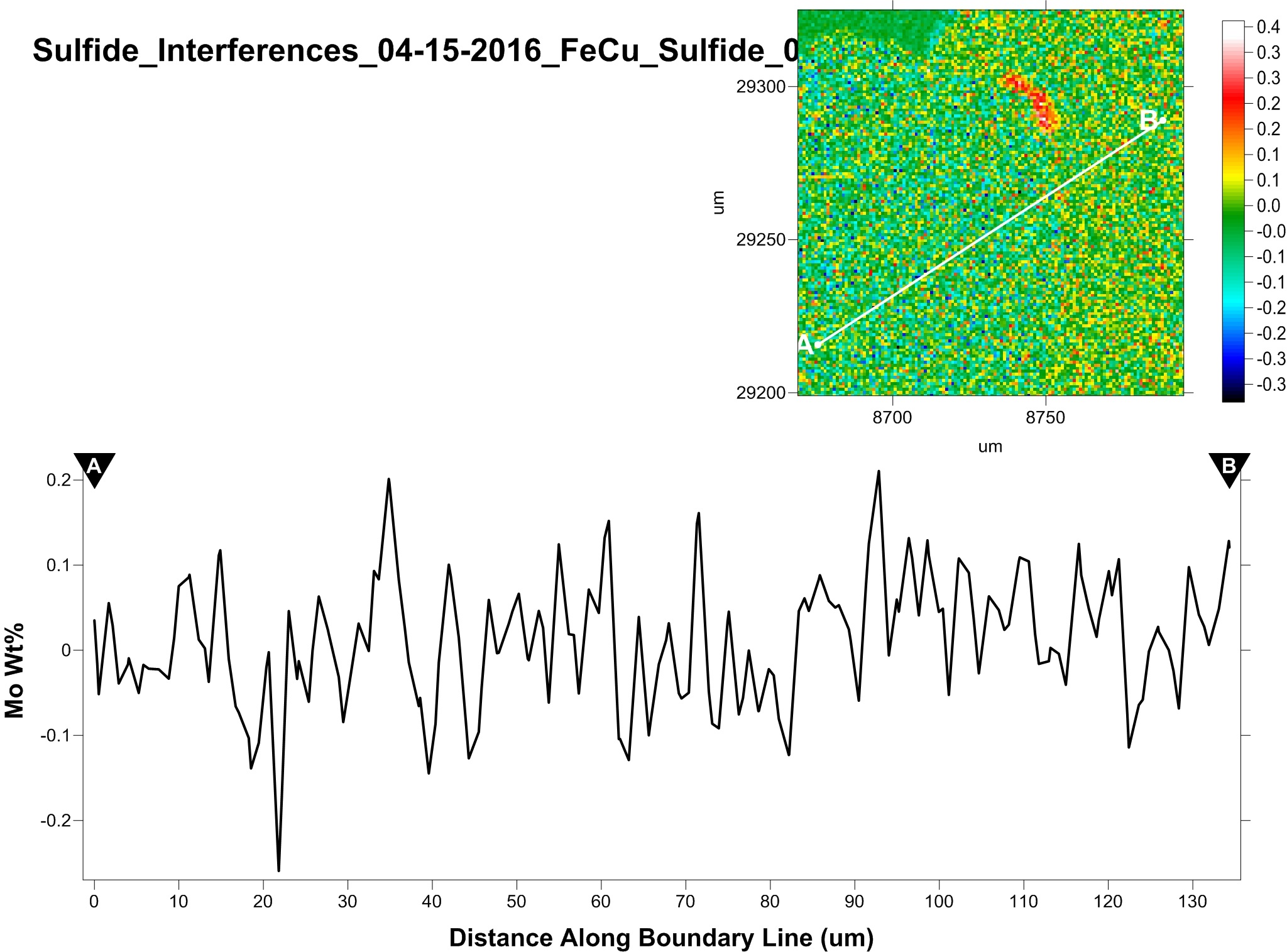

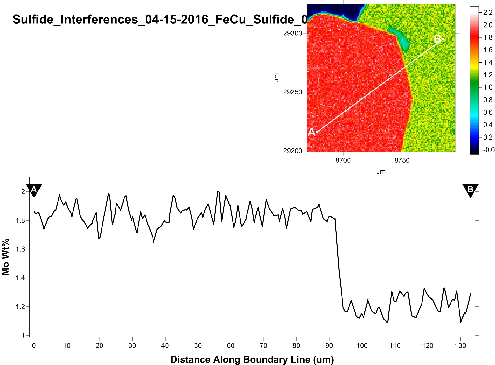

To see fine details in the quantitative x-ray map interference correction I performed a cross section on the Mo quant pixel data using the CalcImage slice menu as seen here:
http://smf.probesoftware.com/index.php?topic=41.msg541#msg541
and I obtained this output *without* an interference correction of sulfur on Mo La:
and this output *with* an interference correction for sulfur on Mo La:
The pyrite (high sulfur) phase is on the left, the CuFe (lower sulfur) is on the right. The neat thing is, as described by Ben Buse here:
http://smf.probesoftware.com/index.php?topic=777.msg4823#msg4823
Is that the eye can (sort of) detect a (statistically insignificant) difference in the Mo content in the interference corrected map for the two phases even though the cross section plot does not (seemingly) show it!
How cool is that?    8)
