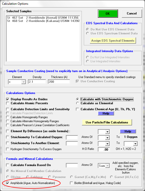

In case anyone is interested in amphibole calculations there is an option for site occupancy in amphiboles and biotites in PFE in the Calculation Options dialog as seen here:
These calculations are from Jay Ague and George Brimhall when Jay was a grad student at UC Berkeley. When this output option is run on say Kakanui Hornblende, one gets the following output:

The output is also saved to a text file in your user data folder (containing your MDB probe database), called AMPHI.OUT in a "machine readable" format as seen here:
