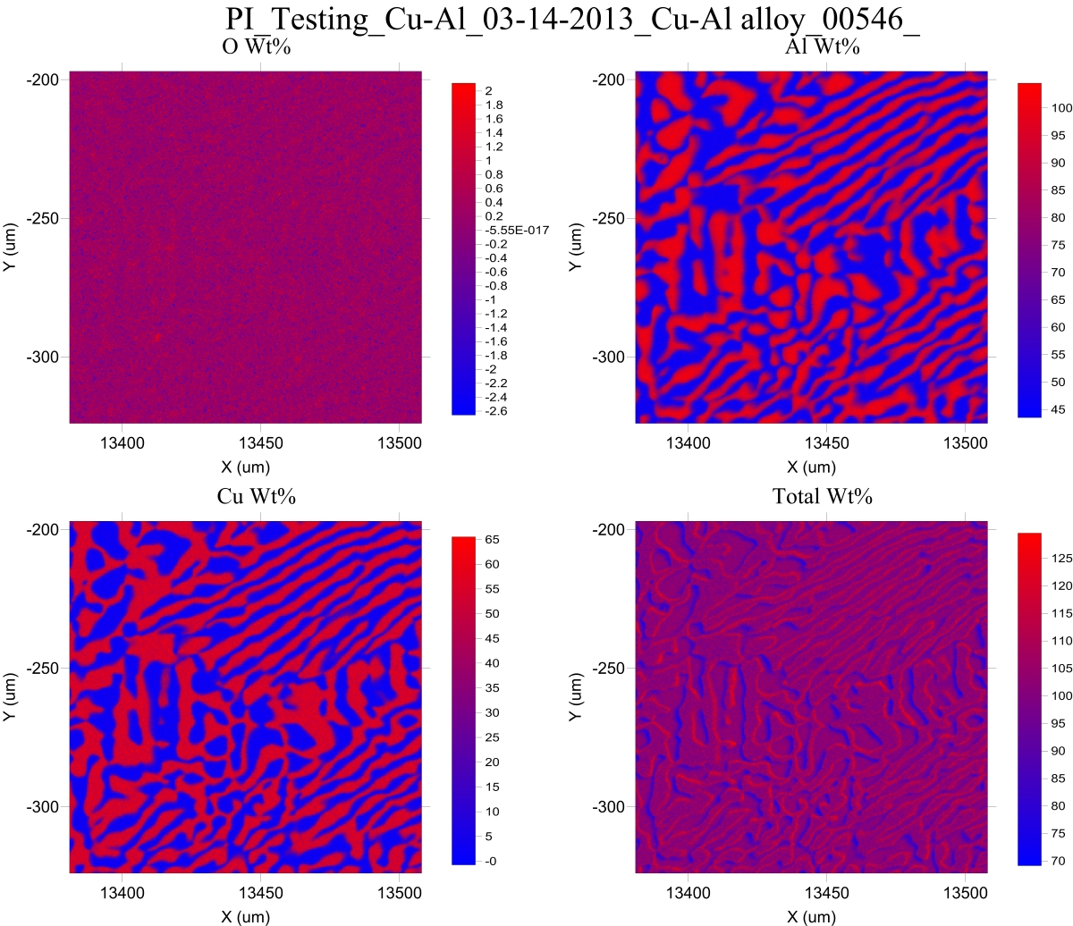

On the other hand, in a conductive porous material, if the internal surfaces are conductive, the incident electrons should not produce excess sub surface charging, but if they are filled with water or another gas, the fact that the interaction volume is not homogeneous can change the matrix effects significantly. We've all seen how our analytical totals can become anomalously high as the beam traverses a material boundary, even when secondary fluorescence is not an issue. For example a Cu-Al boundary:
https://smf.probesoftware.com/index.php?topic=1064.msg7040#msg7040
Think of it this way: at the boundary between pure Cu and pure Al, the instrument is seeing the x-rays from both copper and aluminum, but almost all the Cu Ka x-rays are being emitted from pure copper, and almost all the Al Ka x-rays are being emitted from pure aluminum. So instead of applying a matrix correction of around 1 to most of the emitted x-rays, because our bulk matrix model assumes the sample is roughly a 50:50 composition, we get an severe over-correction for Al Ka because the physics model says that the matrix correction for Cu and Al in an alloy is around 1 for Cu Ka, but around 1.5 for Al Ka! This may be part of the reason why we get this odd looking *totals* map in a Cu-Al eutectic map:
Now of course these effects are very sensitive to detector orientation but I suspect that at least part of what we are seeing above is due to an inhomogeneous interaction volume.
