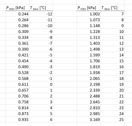

Over the relevant range of temperatures, PH2O is given well enough by the following relation:
PH2O [kPa] = 0.611 kPa * 10^((7.5 * Tdew [°C]) / (237.3°C + Tdew [°C]))
