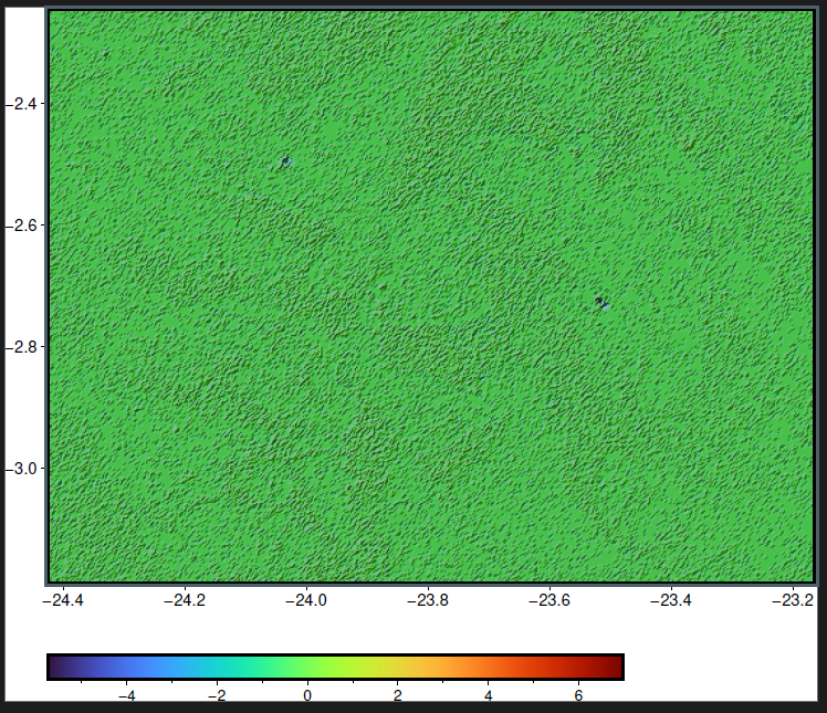

I've slightly progressed this. This time running on windows. A cmd batch which pass files to in command prompt window

The result isn't perfect as hard to set set of colorbar relative to the map. Here just batch script so can't adjust colours.
Outputs to pdf
