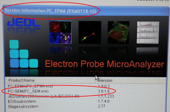

Can someone please explain how one determines which version of Jeol PC-SEM one has, as here at ASU, where the Jeol engineer reinstalled the system software after there was a major software crash. So I look at the engineer's record of the software and see the following
PC-EPMA Software Ver. 1.9.0.3
PC-SEM Software Ver. 3. 0.1.6 (so is this version 3? or version 16? or v 6? I don't see any way to think is is at least version 8)
EOS-Firm Software  (JXA-8530F) Ver. 1.7.4.0
Stage Software Ver. 2. 85
EDS Software Ver.1.11

Remember, to utilize the latest EIKS column functions implemented by JEOL, your JEOL software on the JEOL PC should be version 10 (the PC-SEM, PC_SEM.exe, version will be 3.0.1.6 as seen from the JEOL help menu).
