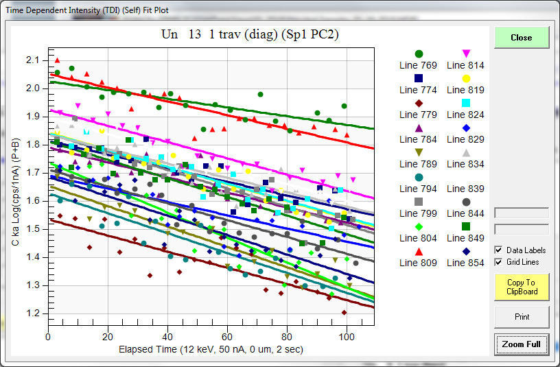

and recent point analyses performed this month, I instead see a downward trend over time as seen here:
These are from a traverse of a heat treated sample displaying every 5th point. Each point is several microns apart so they should not be intersecting any carbon from a previous analysis position. Why would the carbon levels decrease over time?  The system is quite clean (we use a 100K cryo trapped system) and the sample was carefully cleaned in ethanol and dried in a 60C oven just prior to being placed in the instrument.
Anyway, if this is of any interest to anyone, I thought I would step through the process of analyzing these samples for trace carbon and share what I have learned about characterizing trace carbon in steel.  First off, here are the results for the first 12 data points, without any specialized corrections.  That is, merely off-peak and matrix corrected results:

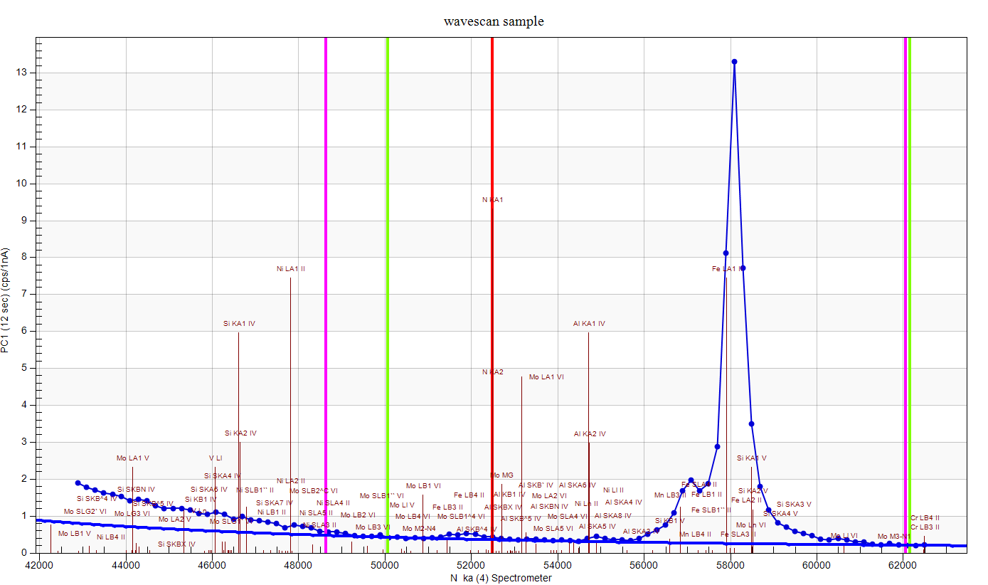

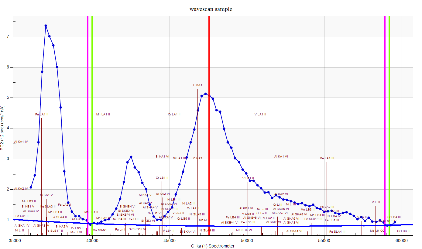

Pretty awful as one can see.  Oh, I guess I should show the background fits for carbon (and nitrogen), so here they are, first for carbon:
Now we can assume that are not seeing the actual carbon background here.  The tails in this region extend a long way, especially when using LDE/PC multi-layer Bragg crystals for these emission lines.  But measuring too high a background, would give us *lower* carbon results than we expect, not higher.  Either way, the blank correction should take care of it. And here are the results for the nitrogen scan:

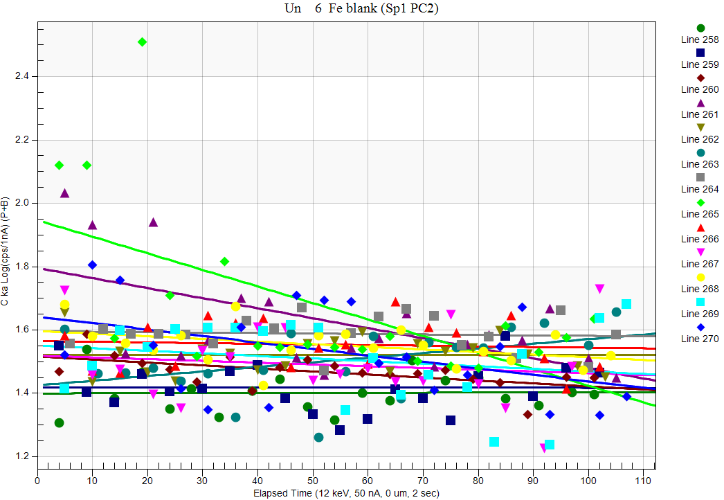

So a 15% increase in carbon at the ~1.5% wt.% level.  But why are our totals so darn high?  Well first of all, we appear to have some "native" carbon on our sample, as a "blank" measurement on pure Fe gives us about 1 wt.% carbon. Interestingly, if we look at the carbon TDI on our blank we see almost no TDI effect:
How weird is that?  Same instrument, different sample...
Now after the blank correction is applied we now obtain these quant results:

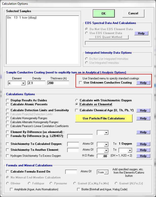

Well I didn't mention this yet, but most of you probably guessed that the standards are carbon coated, but the unknown sample is *not* carbon coated- because, you know, we're trying to analyze for carbon here!   :)
And at 12 keV, the low overvoltage affects the Fe Ka emissions pretty strongly.  And I should also mention that this is why we should always utilize standards- because if we normalize to 100% every analysis looks perfectly fine...  So let's specify a carbon coat for the standards by checking these boxes in the Analysis Options dialog:
The standards are by default specified as 20 nm of carbon, now how do we specify no coating for our unknown sample?  We use the calculation Options dialog as seen here and simply uncheck the Use Unknown Conductive Coating correction for the sample as seen here:
And now we obtain these results, with the TDI, blank and coating corrections:

For me this primarily an exercise in trying to understand how carbon and nitrogen might be quantified in these matrices.  Got to love a challenge!   :)
Quote from: Les Moore on February 20, 2018, 09:57:04 PM
Lastly a minor quibble... a carbon content of 0.4 and above would put the steel into a "high carbon content" range and calling this a trace level analysis may raise a few Metallurgists' eyebrows.
For steels, low carbon steels are desired to have ~20ppm C and even these few and far carbon atoms are tied up in Ti(CN).
I think there is little if any carbon in the matrix of this sample (except maybe for the first few points on the edge and some random others).  The variation may represent sub micron inclusions which are beyond my tungsten gun's resolving capabilities.
Someday maybe I will have access to a FEG instrument!

Un   13 1 trav (diag), Results Based on 1 Atoms of n
ELEM:        C       N      Al      Mo      Cr      Fe      Mn      Ni      Si       V   SUM
   769    .068   1.000    .001    .016    .126   2.044    .008    .003    .041    .035   3.342
   770    .087   1.000    .001    .015    .129   2.108    .009    .005    .045    .016   3.414
   771    .023   1.000    .001    .033    .277   4.467    .017    .007    .097    .062   5.984
   772   -.001   1.000    .002    .031    .276   4.487    .018    .008    .097    .059   5.978
