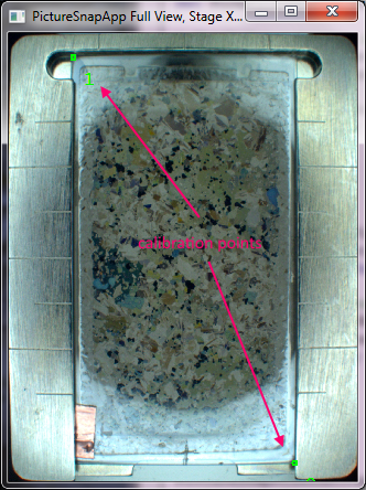

We tried using this upstairs with one of the laser ablation stages. It almost worked in text mode buuuuuuuuut (and, I stress, this is really dumb) it's half anti-cartesian.
As in, the X-axis runs in the normal cartesian plane, but the Y axis runs anti-cartesian. (+/+ in the lower right, -/- in the top left).

This "half anti-cartesian" stage orientation was also the case for the first microprobe I ever used, an ARL SEMQ.  On that instrument, the explanation for the reversed Y axis was simple: they used an inverting microscope optics (as in a petrographic optical microscope), so it sorta-kinda made a little sense.
But then just to be different, they used stage units of 0.1 mm!    :o   What the heck is a hundredth of a meter?  I called them humimeters. As in hundred micron units. So now you know!   And you'll never be able to forget either.   :P
Just so you know, I do have the X and Y polarities specified separately in the code, so in theory it's possible that PictureSnapApp could handle this "half-anti-cartesian" (or is it half cartesian?) situation.  In practice?  Maybe someday.  Also, if you look at the .ACQ file in a text editor, you'll notice that the X and Y stage "polarities" are specified separately, so we've left this option open for future development.

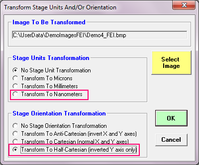

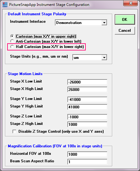

Well I woke up this morning thinking of an easy way to do all this transformation stuff "on the fly"!
So now PictureSnapApp supports cartesian, anti-cartesian and now "half-cartesian" stages!    8)
I also modified the transformation menu dialog to support transforming images from and to different units and stage orientations (I've been a busy bee) as seen here:

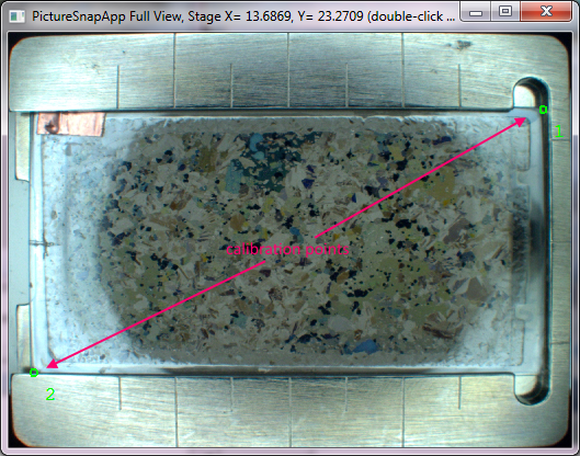

But the best part is that I modified the open image file code so that PictureSnapApp now *automatically* detects the stage units and orientation of the image being loaded, and then converts it to the current PictureSnapApp stage units and orientation.  So the above transform dialog isn't really necessary any longer, but I left it there just in case someone can find a use for it.  This new auto-detect code should make it essentially effortless to move your images and annotations from one instrument to another.
And of course PictureSnapApp also converts all the point and FOV annotations to the new stage units and orientations, but remember you'll still need to re-calibrate the image to the new stage coordinates, even if no unit or orientation conversions were necessary. That is to say, just because two instrument stages have the same units and orientation, that doesn't mean that the sample was mounted exactly the same in both instruments.
Of course, re-calibrating the image is also required if you remove the sample from the sample holder, and then remount it in the same instrument. Although in this case the image calibration will probably be very close to the saved calibration making it really easy to do (unless you mounted the sample in a different place in your sample holder).  But this is all normal and expected.
This new version also supports nm (nanometer) units (I'm thinking of TEMs, but maybe they all use mm and um units?).   Anyway, nm are now supported.
When you install this new version, it might force you to re-specify the stage parameters.  I don't think it will but I had to modify the installer slightly so it's possible.  Anyway, I will be very interested to see what you think of the recent changes... just update from the Help menu and all should be good to go.
Oh, I should also mention that if the software detects that it needs to transform the stage units and/or orientation, it automatically appends some text on the image name to make it clear what things were modified.  For example if the image was converted to um, it appends a "_to_um" to the original image file name.  In a similar manner, if the stage orientation was converted from cartesian orientation to anti-cartesian orientation, it would also append a "_to_anti-cartesian" string to the original image file name.  That way the original image is not modified.
neko
It works! I'm pleased to report it even handles 0 correctly for stage limits. This stage is weird, it's 0-50mm in both directions. But as you said, the image opened up, converted itself properly, and after we figured out what we were looking at, calibrate correctly and even in text mode with not so great scans, is within 50-100um of where it should be. We didn't calibrate that carefully, and we're also using a second computer and typing the coordinates in by hand. but hey, it works as advertised!

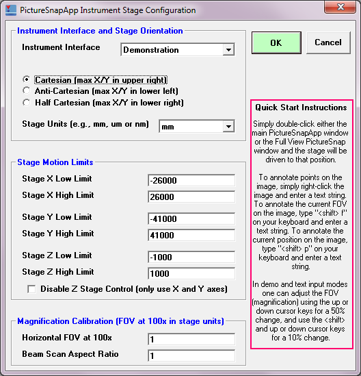

We added the keyboard and mouse annotation documentation to the Stage Config dialog, and also it will pop up after you click the Calibrate button in the Window | Calibrate Image To Stage Coordinates menu window (the first time only!).
Here is what it looks like in the Stage Config dialog (which pops up the first time you run PictureSnapApp!).

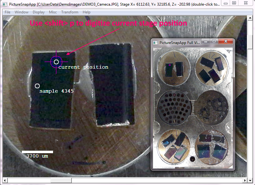

We also added a feature that allows the user to capture the exact current position by typing <shift> p as seen here:
Of course one can right click anywhere on the image to add a random annotation, but this allows one to capture the current position precisely.

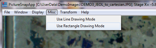

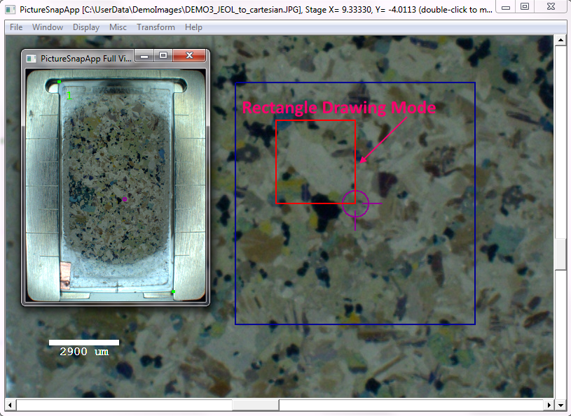

We just added a feature tonight that does at least the first half of your request!  It was already in the PictureSnap feature in PFE, so we "just" moved the code over.   :D
You turn it on/off using a new Misc menu, and here we choose the draw rectangle mode:
Basically it just draws a (red) rectangle between the current position and the last position double-clicked to as seen here:
The blue square is of course the current field of view.

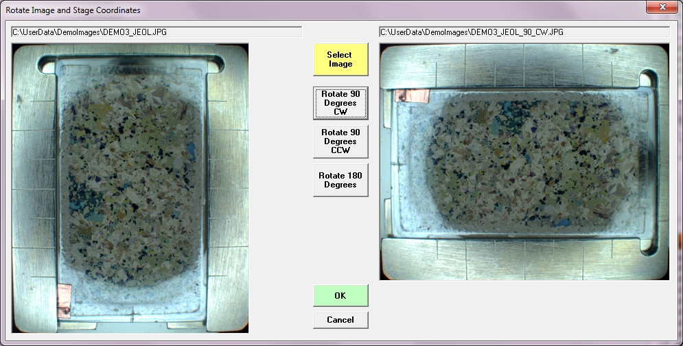

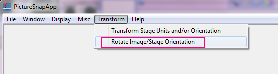

Dang, this was harder than I thought it would be but we added the ability to rotate an image +/- 90 or 180 degrees to deal with samples mounted in different orientations in different instruments.  Or perhaps you loaded the sample in the same instrument, but upside down, as is sometimes the case!
To utilize this feature please update to the latest PictureSnapApp from the Help menu, then click on the Transform | Rotate Image/Stage Orientation menu as seen here:
Then use the Select button to load an image, and then click one of the Rotate buttons to rotate the image appropriately.
When you click the OK button the app will save the rotated image and also rotate the screen calibration coordinates. Here is an example of the original thin section and the two screen calibration points:
And here is the image rotated 90 degrees clockwise:
Please note that the stage calibration coordinates will not be modified, but since you'll have to re-calibrate the image to the new stage, that really doesn't matter.  But at least the location of the original calibration points will be preserved, though of course one can choose different calibration points if they prefer.
