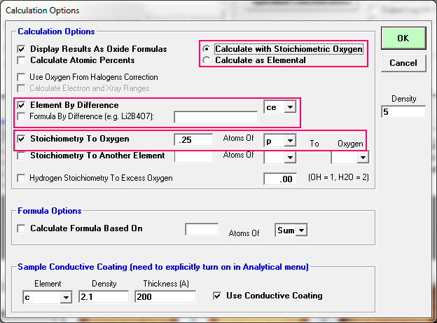

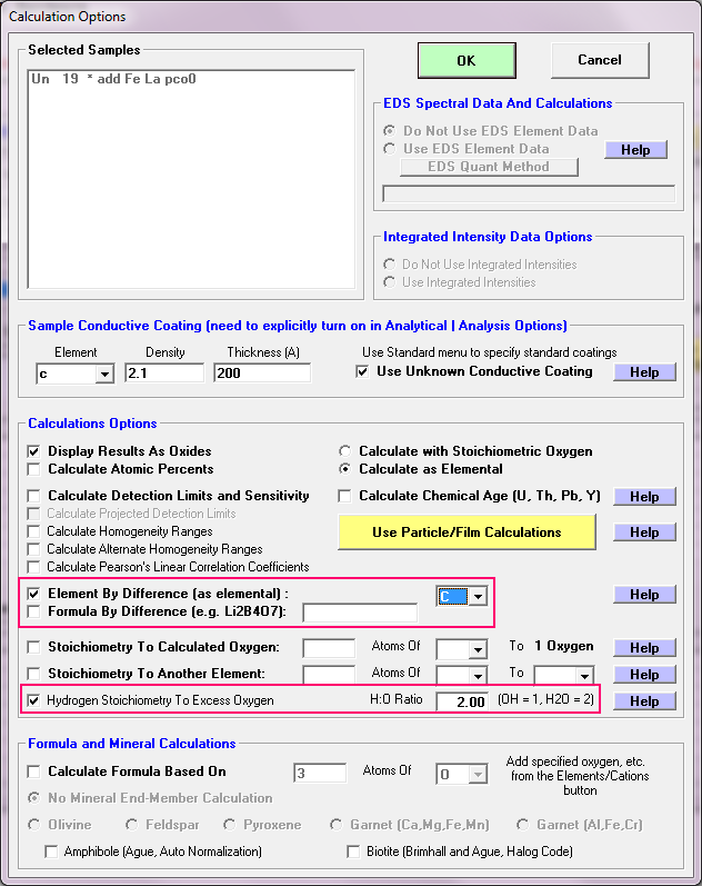

I went back to a monazite mapping run I did some time ago just to see what I did and here is the quant setup:
Note that I added La as an analyzed elements, but I suspect just because I had an extra spectrometer free.  I also specified CePO4 by difference, but because this run was from before I had implemented the "formula by difference" method, I used this slightly complicated method in the Calculation Options dialog:
I hope this helps.

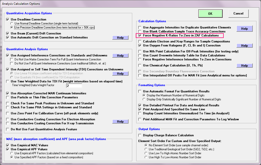

Slightly embarassing...I can't find an option/checkbox anywhere to get it to calculate a grd file of chemical ages. I am looking in Calcimage -> Specify Quantitative Parameters -> Calculation Options and cant see anything? In normal PfE its under the calculation options window but is it different in Calcimage?
EDIT: Ignore that...found it...
Quote from: BenjaminWade on February 22, 2018, 06:28:32 PM
There definitely are a lot of menus in CalcImage,  but that's only because there are so many data types one can output!   :P

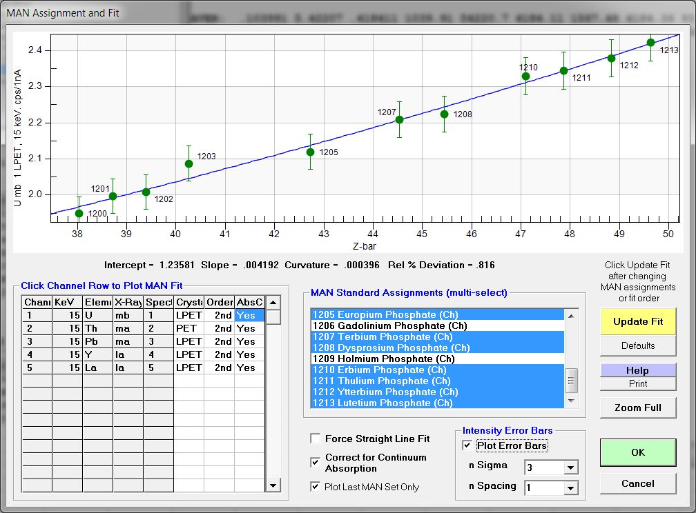

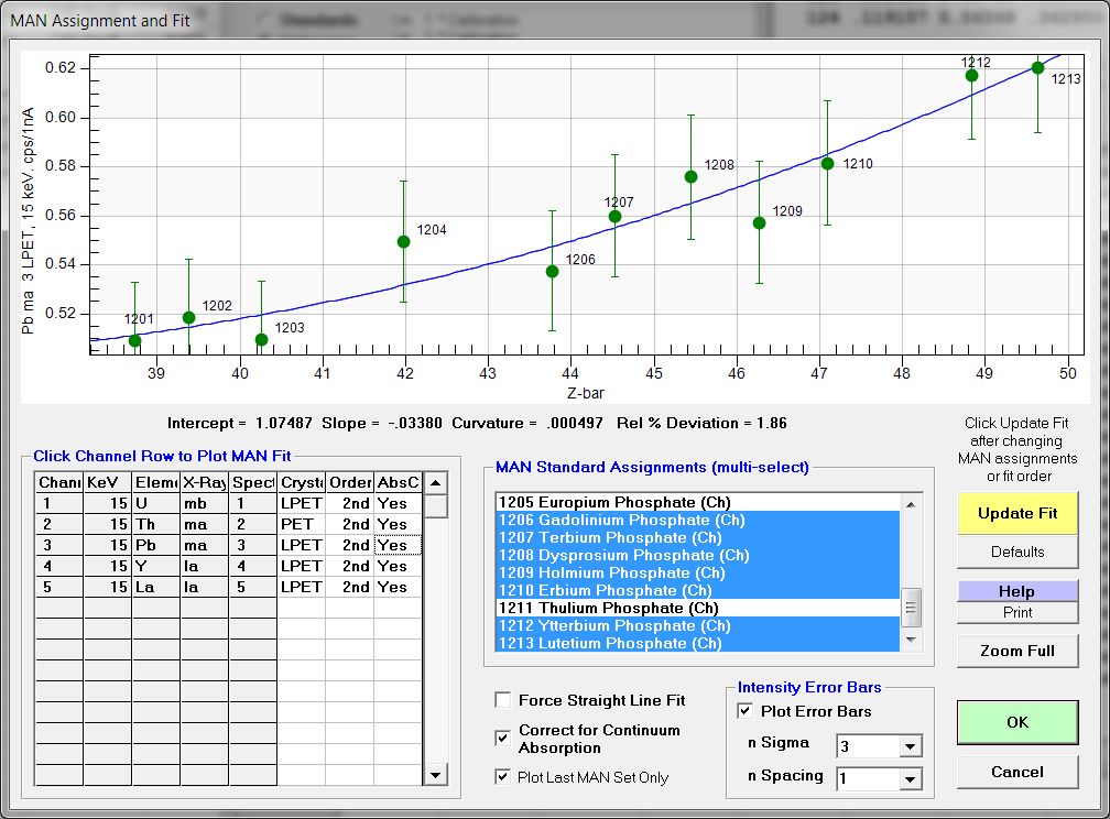

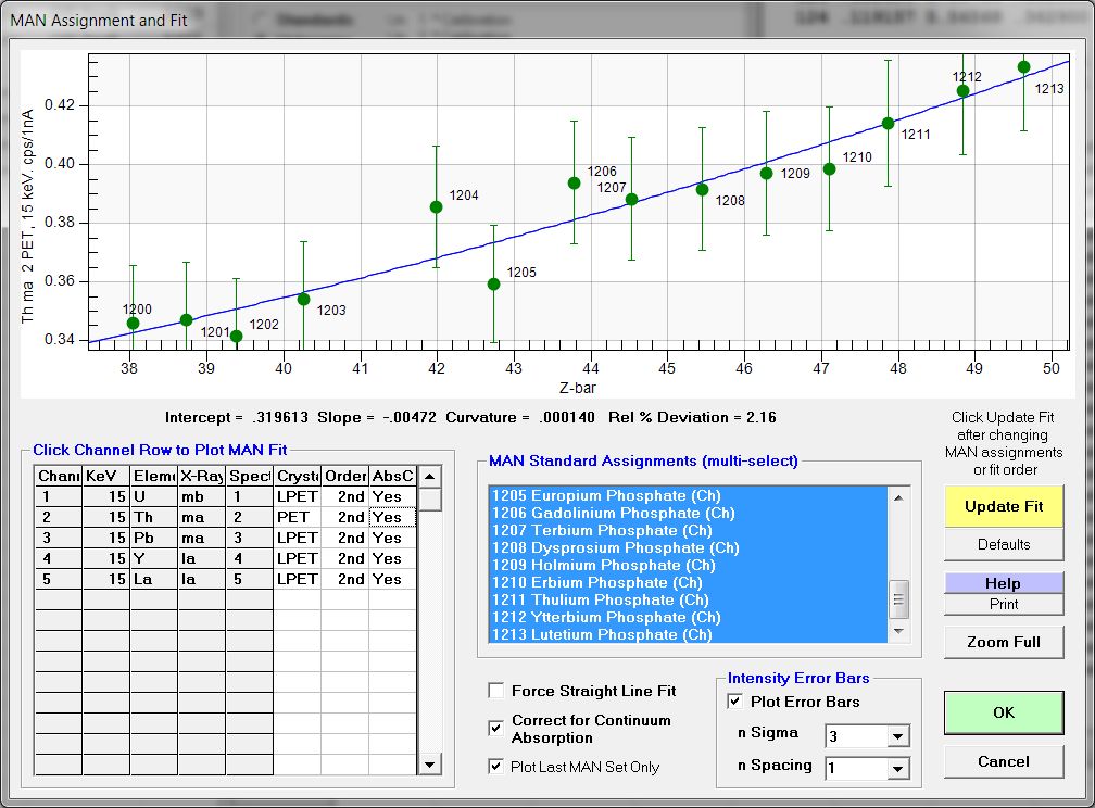

For those interested, here are some very rough preliminary results comparing traditional OFFpeak/MP background data with MAN fit for chemical age dating.

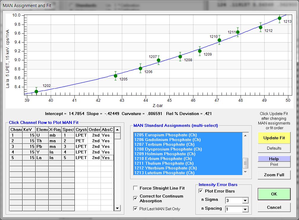

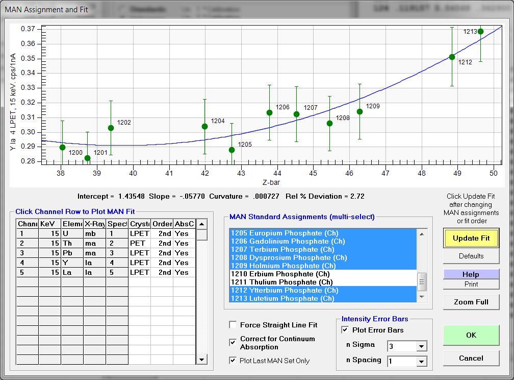

Here are the MAN fits for U/Pb/Th/Y/La using Jared's RPI phosphate standards:
Below is an excel spreadsheet of some example spot data processed using traditional offpeak and with MAN. Pretty close really for a first pass.

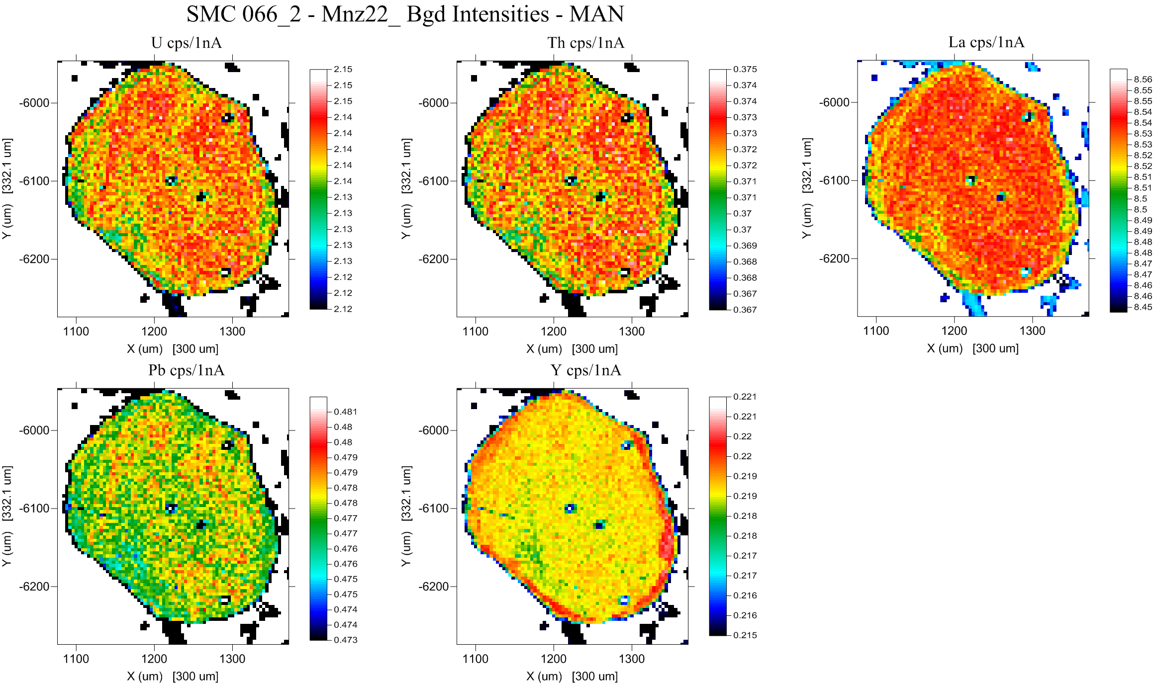

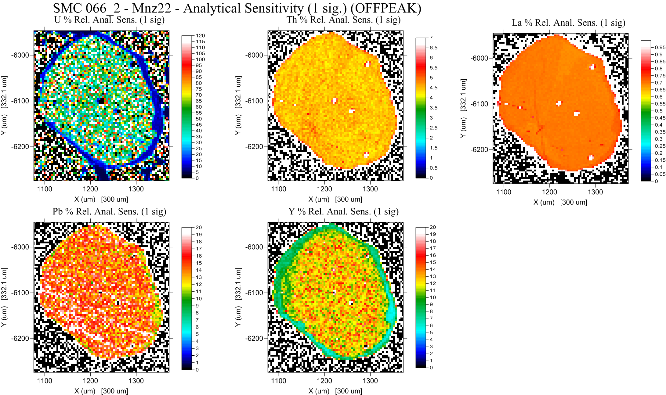

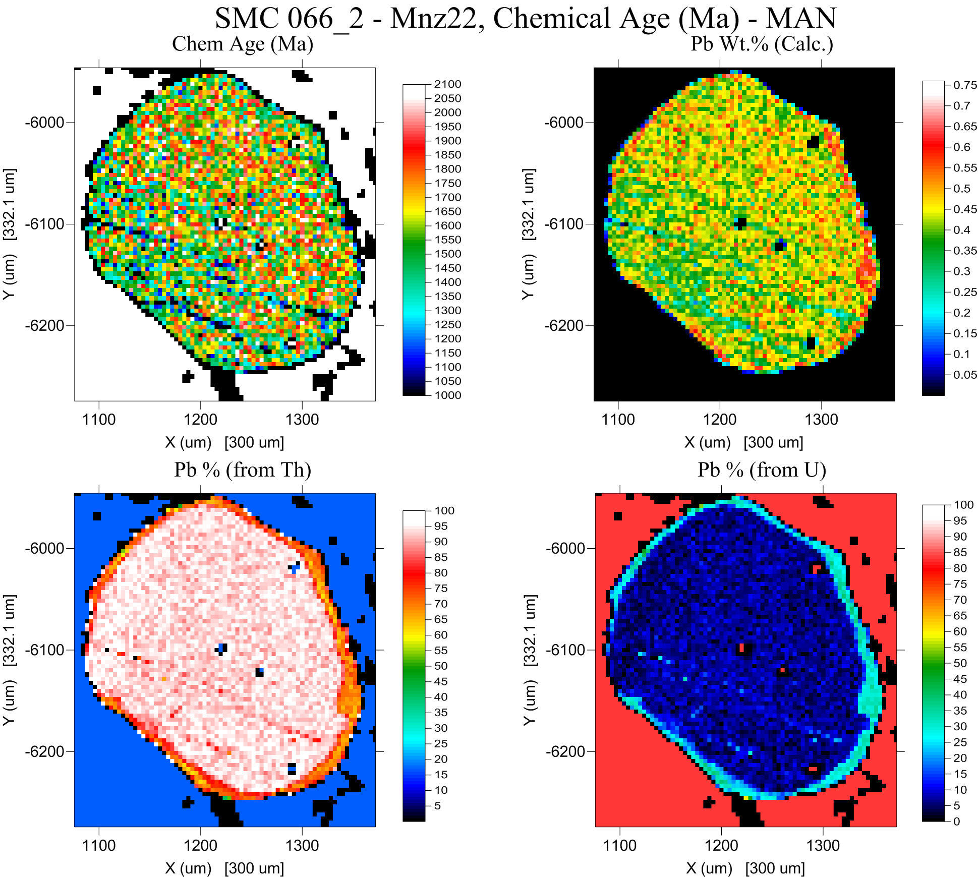

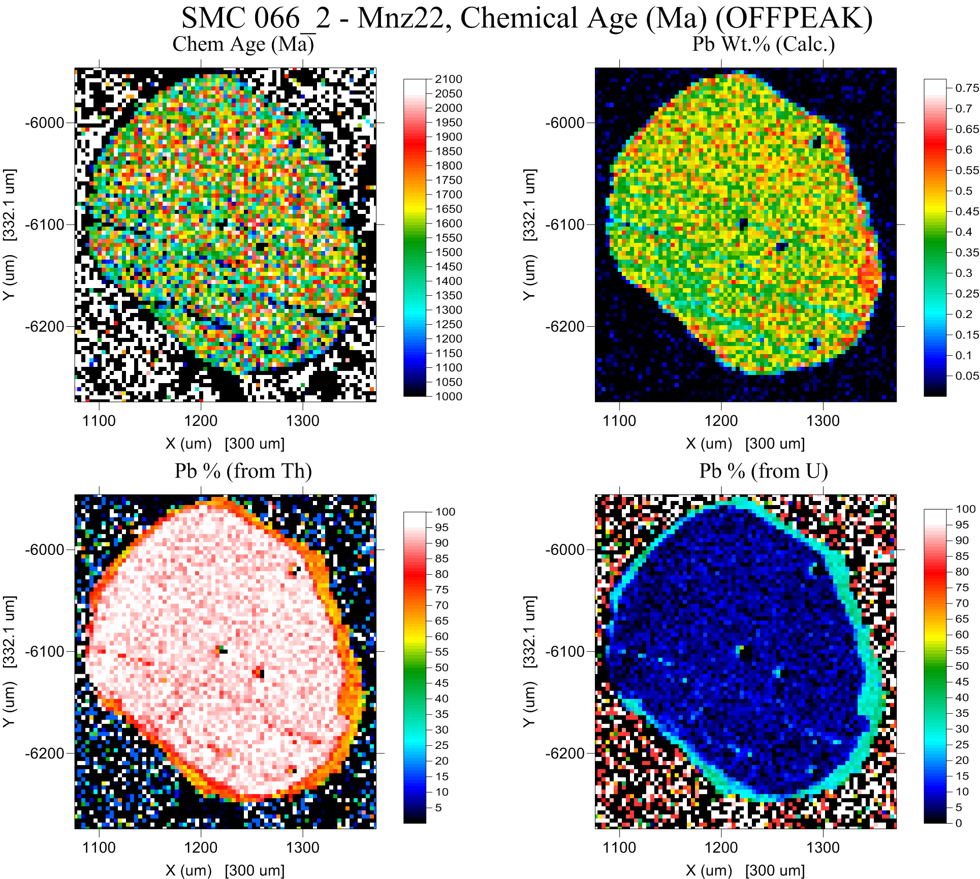

I am in the process of comparing the ChemAge maps using off peak acquired maps vs MAN fit maps, and as one might expect PPM maps are much less noisy using the MAN method, and seems to give a less "noisier" map.
And here is the comparison of the Calcimage maps using OFFPeak background maps, and those using MAN. Caveat is I had limited time to conduct this test...so my on peak count time was 1s, and my background maps were acquired at 0.5s each. Even so I think it illustrates what we see from the OFFPEAK vs MAN spot data.
OFFPEAK
MAN
Very impressive. Especially for only 1 sec dwell time per pixel.  What was the mapping beam current?
I used 2.2 sec per pixel (and 0.6 sec per off-peak) and 100 nA for my monazite test here (I should probably merge these topics...):

Finally I'm glad you showed the background intensity maps for off-peak vs. MAN.  It's quite striking how much better the MAN method is compared to off-peak.  Of course that is most because the off-peak background statistics are limited by the continuum intensities, while with the MAN method statistics the background intensity is based on the concentrations of the major elements, which have much better statistics of course.  See fig 14  in my MAN paper here:
http://epmalab.uoregon.edu/publ/A%20new%20EPMA%20method%20for%20fast%20trace%20element%20analysis%20in%20simple%20matrices.pdf
The variation in the Hf really shows up in the MAN bgd intensities.
Of course the best thing about MAN is that is takes half the acquisition time compared to off-peak acquisition (and with better precision)!   :)
Yes I was a bit rushed for time so I only did 1sOn/0.5sOff...but cranked it to 200nA. Next time to do the Offpeak maps justice I will count for longer on the background maps (and peak) and see how it compares with the MAN.
Yes I have read your MAN paper many times. You are correct in that at the moment my comparison is a bit circular. My spot measurement OFFPEAK data was measuring La and using Ce for difference, which of course wouldnt be reality. And I am comparing my MAN data to it which is assuming the same Ce by difference, so the potential inaccuracy of the MAN wt% numbers due to z estimation is a bit negated by this. This is probably a topic for the standard material thread but given that single element phosphate xtals can be hydrothermally grown, is there anything stopping a mixed REE phosphate being grown Th/Pb/U free with an "average" monazite composition to use as a blank standard?
A test I guess would be to measure one of my monazite standards with a full element package (of which I have U/Th/Pb/REE quantified via other analytical techniques), then analyse the same monazite standard using MAN and measuring just U/Th/Pb/La and doing Ce by difference and see how close the numbers are then. If I was a smart man I would have done this first, but I'm not. I just jumped into and unknown as it was a bit of a play around with it.
Also the other thing worth mentioning is that the unknown monazite I have used is by no means a "low Pb" monazite, so would be interesting to see how well the MAN works for monazite with lower Pb. When I have some more free time on the instrument I will repeat the experiment on some monazite standards

But I'm a little skeptical that MAN will be accurate enough for monazite dating (though I would be pleased to be proven wrong!), unless one has a matrix matched blank, but I just don't think that will be easy to produce.  I once asked John Hanchar about it and he thought originally it might be possible but he later told me that due to zoning during crystal growth it didn't work out very well.
That said, there are monazite age standards, such as the Moacyr material from Brazil which has an age around 500 mya.  I think Mike Jercinovic might be able to provide you with some material.
Back to the MAN correction and the effect of the average Z for the MAN background for a measured matrix versus an assumed matrix of say CePO4, I note that the Moacyr monazite average Z is ~41.6, while CePO4 average Z is 39.18.  How much of a difference that makes in the MAN intensity calculation for different elements will depend on the slope of the MAN curve, and it would be very interesting to hear from you exactly what you find.

You should try the multi-point bgd next.  The advantage being that one can see if some off-peak backgrounds are inconsistent with the others.  In fact, why don't you take the off-peak data you already have and turn on the "shared bgd" feature?   Then show us some MPB plots.
http://smf.probesoftware.com/index.php?topic=9.msg6709#msg6709
The difference in calculated background cps/nA I posted were just to illustrate the minimum/maximum calculated background values from my current MAN fit going from Z 38 to 43, which I have taken as a "typical" range in monazite composition.
I usually do MPB for U and Pb, and carefully selected two point offpeak for Th/+all REE in my current monazite package. This lets me turn on the shared for Th and all the REE, and pick and choose. For this ChemAge package though I just used my most consistent two point OFFPEAK backgrounds ascertained from past monazite work, as I knew I was going to do offpeak background maps and could just read them in in ProbeImage. I wasn't planning on doing any point analyses but I did in the end. The shared backgrounds method is defintely an awesome feature and I have used it a lot for weird and wonderful REE minerals in the past.
Unfortunately the shared wont work in this instance as I only measured one element per spectrometer! I will do a proper calibration measuring everything with MBP/Shared then compare it to MAN fit data. When the instrument is free next...
