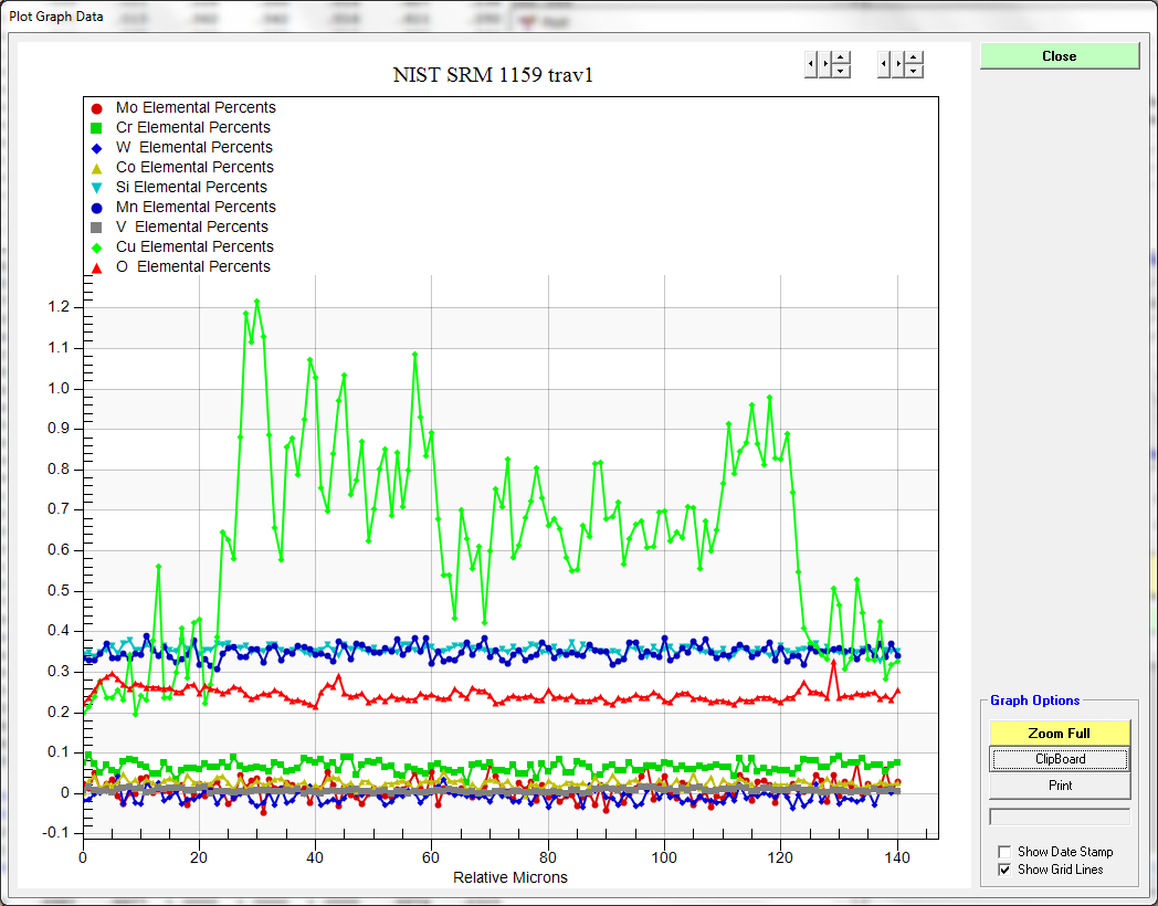

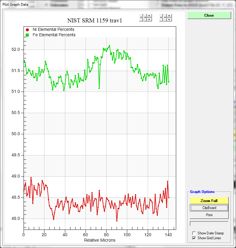

There is nothing systematic about the data below, but I threw a couple of NIST alloy SRMs that I had already mounted into the instrument over the weekend and run a bunch of elements on both. The data looks pretty good but I wasn't able to run a second set of standards for a drift correction as the filament blew during the last traverse.
I suspect the answer to your question is going to be "it depends". That is it depends on which SRM standards we are talking about.  Here is the the first one I ran which is a NiFe alloy, SRM 1159 to be exact. First the major elements:
Note that the Fe appears to vary a little, but according to the homogeneity range calculations below, the Fe is homogeneous within the 1% precision confidence interval.  The minor and trace elements look like this:
Clearly the Cu is *not* homogeneous, but the others look pretty good.
Finally I turned on the Homogeneity Range calculations from the Calculation Options dialog in the PFE Analyze! window and we get this output:
Range of Homogeneity (t-test) in +/- Elemental Weight Percent (Average of Sample):
ELEM:       Ni      Mo      Cr      Fe       W      Co      Si      Mn       V      Cu       O
  60ci    .013    .000    .000    .017     ---    .000    .001    .001    .000    .008    .000
  80ci    .021    .000    .000    .026     ---    .000    .001    .001    .000    .012    .001
  90ci    .026    .000    .000    .034     ---    .000    .001    .001    .000    .016    .001
  95ci    .032    .000    .000    .040     ---    .000    .001    .001    .000    .019    .001
  99ci    .042    .000    .000    .053     ---    .000    .002    .002    .000    .025    .001
Test of Homogeneity (t-test) at 1.0 % Precision (Average of Sample):
  60ci     yes     yes     yes     yes     ---     yes     yes     yes     yes      no     yes
  80ci     yes     yes     yes     yes     ---     yes     yes     yes     yes      no     yes
  90ci     yes     yes     yes     yes     ---     yes     yes     yes     yes      no     yes
  95ci     yes     yes     yes     yes     ---     yes     yes     yes     yes      no     yes
  99ci     yes      no     yes     yes     ---     yes     yes     yes     yes      no     yes
Level of Homogeneity (t-test) in +/- Percent (Average of Sample):
  60ci      .0      .4      .2      .0     ---      .1      .2      .2      .1     1.3      .2
  80ci      .0      .6      .4      .1     ---      .2      .2      .2      .1     2.0      .3
  90ci      .1      .8      .5      .1     ---      .2      .3      .3      .2     2.6      .4
  95ci      .1      .9      .6      .1     ---      .3      .4      .4      .2     3.1      .4
  99ci      .1     1.2      .8      .1     ---      .4      .5      .5      .3     4.0      .6
Range of Ideal Homogeneity (t-test) in +/- Elemental Weight Percent (Average of Sample) (Meisenkothen and Donovan):
  60ci    .095    .000    .002    .050     ---    .000    .006    .006    .000    .004    .001
  80ci    .145    .001    .003    .077     ---    .000    .009    .010    .000    .007    .002
  90ci    .187    .001    .004    .099     ---    .001    .011    .012    .000    .009    .003
  95ci    .223    .001    .005    .118     ---    .001    .013    .015    .000    .010    .003
  99ci    .294    .001    .006    .155     ---    .001    .018    .020    .000    .014    .005
Range of Actual Homogeneity (t-test) in +/- Elemental Weight Percent (Average of Sample) (Meisenkothen and Donovan):
  60ci    .160    .000    .002    .205     ---    .000    .006    .007    .000    .097    .005
  80ci    .244    .001    .003    .313     ---    .001    .010    .010    .000    .148    .008
  90ci    .313    .001    .004    .402     ---    .001    .012    .013    .000    .190    .010
  95ci    .374    .001    .004    .480     ---    .001    .015    .016    .000    .227    .012
  99ci    .494    .002    .006    .635     ---    .001    .020    .021    .000    .300    .016

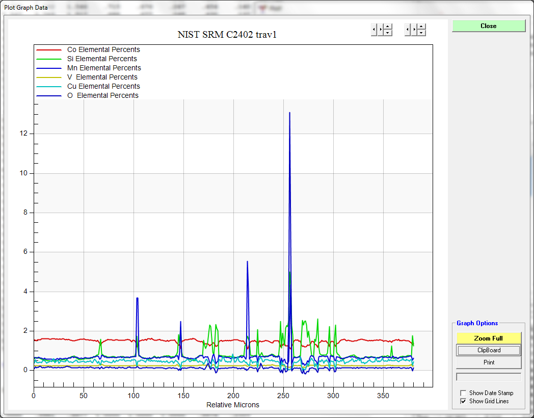

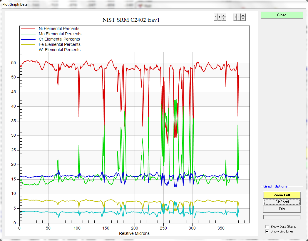

Next I will look at SRM C2402, which is a very different story!
Now for SRM C2402 which is a Hastelloy material. First the major elements:
I think we can all agree that this would not be suitable as a microanalytical standard!  Next, a similar story, for the trace elements:
And again, the homogeneity range calculations from the Calculation Options dialog:
  60ci    .235    .273    .037    .035    .037    .003    .024    .014    .000    .002    .007
  80ci    .358    .416    .056    .054    .056    .005    .036    .021    .001    .003    .011
  90ci    .460    .534    .072    .069    .072    .006    .047    .028    .001    .003    .014
  95ci    .548    .637    .086    .082    .085    .007    .056    .033    .001    .004    .016
  99ci    .722    .839    .114    .108    .112    .010    .073    .043    .001    .005    .021
  60ci     yes      no     yes     yes     yes     yes      no      no     yes     yes      no
  80ci     yes      no     yes     yes      no     yes      no      no     yes     yes      no
  90ci     yes      no     yes     yes      no     yes      no      no     yes     yes      no
  95ci      no      no     yes      no      no     yes      no      no     yes     yes      no
  99ci      no      no     yes      no      no     yes      no      no     yes      no      no
  60ci      .5     1.6      .2      .5     1.0      .2     2.7     2.0      .1      .4     3.8
  80ci      .7     2.4      .4      .7     1.5      .3     4.1     3.0      .2      .6     5.8
  90ci      .9     3.1      .5     1.0     1.9      .4     5.3     3.9      .3      .8     7.4
  95ci     1.1     3.7      .5     1.1     2.2      .5     6.3     4.7      .3      .9     8.9
  99ci     1.4     4.8      .7     1.5     3.0      .7     8.3     6.1      .4     1.2    11.7
  60ci    .095    .093    .061    .019    .030    .008    .009    .010    .001    .003    .001
  80ci    .145    .141    .092    .028    .046    .012    .013    .015    .002    .005    .002
  90ci    .186    .181    .119    .037    .059    .016    .017    .019    .002    .006    .003
  95ci    .222    .216    .141    .044    .071    .019    .021    .023    .003    .008    .003
  99ci    .292    .285    .186    .057    .093    .024    .027    .030    .004    .010    .004
  60ci   4.588   5.329    .722    .689    .714    .062    .465    .275    .007    .034    .135
  80ci   6.990   8.119   1.099   1.050   1.087    .095    .708    .420    .011    .052    .205
  90ci   8.978  10.429   1.412   1.348   1.397    .122    .909    .539    .014    .067    .264
  95ci  10.705  12.434   1.684   1.608   1.665    .146   1.084    .643    .016    .080    .315
  99ci  14.094  16.372   2.217   2.117   2.192    .192   1.427    .846    .022    .105    .414
