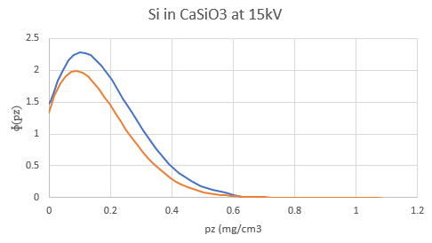

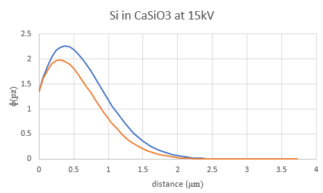

This might be an off-the-wall idea, but would it be possible to extract the phi-rho-z curves and plot them from the calculations in calc-zaf. I think it might offer an alternative to monte-carlo when considering interaction volume (ok its only z, and you'd have to factor in density), it might also be useful for teaching matrix corrections? It would also allow direct comparison with phi-rho-z curves produced from monte carlo simulations aiding R&D.

As I see it it could either be a separate menu like x-ray range - where you ask for (1) material [composition as string]. (2) voltage, (3) density optional for distance, (4) element. Or what might be better is when you "calculate" in calczaf, there is an option to display phi-rho-curve for current sample for all elements or select element
The output could be a graph and a text file containing raw data.
Graph is no density supplied [graphs below are calculated using Armstrong 1990] Orange line after x-ray absorption
Graph if density supplied.
You could also if you like return depth at X% percentile

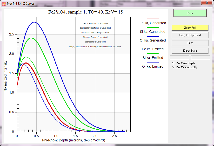

Easier said than done, but with a lot of help from Paul Carpenter and Brian Joy we managed to implement something that hopefully will be useful.  Here's an example of Fe2SiO4 (D=3) at 15 keV:

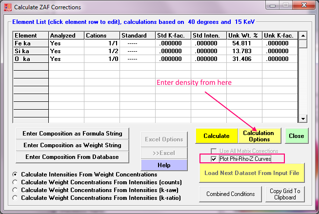

Right now we only calculate these curves for the phi-rho-z methods *other* than PAP and XPP.  Brian Joy is working on the PAP and XPP curves and as soon as he finishes, we will implement that next.  Basically one simply checks the Plot Phi-Rho-Z Curves checkbox here and then runs a calculation in CalcZAF to obtain the plot output:
But you can also plot microns depth if you have properly specified the density from the Calculation Options dialog:

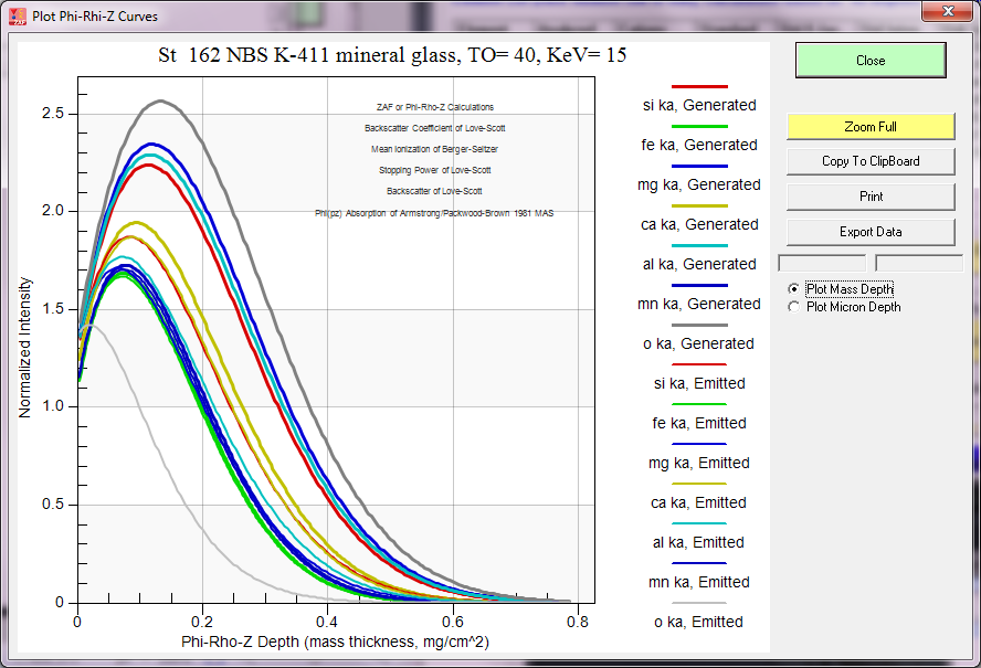

Note that the generated intensity curve is a thick line and the emitted intensity is a thin line. Finally here is a more complicated sample (NIST K-411 glass):

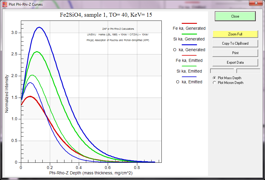

With Brian Joy's help we implemented prz plots for the PAP and XPP methods in CalcZAF v. 12.3.3.  Here is a plot of the PAP curves for Fe2SiO4:
And here is the XPP plot:
As many of you know, the PAP prz method is interesting because it attempts to be physically accurate with regard to depth as opposed to other analytical models that focused primarily on the area under the curve (the genesis of PAP was thin film modeling by Pouchou). However, the validity of area under the curve analytical models is demonstrated by the surprising accuracy of the Love/Scott quadrilateral "prz" method which assumes the x-ray production distribution curve with depth is a rectangle!  But since we're essentially comparing the ratio of the calculated intensity in a pure element with that of the compound, shape really doesn't matter.

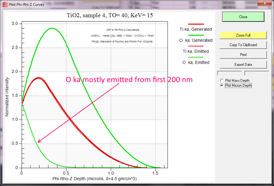

Also, just as a reminder, the intensities plotted here are normalized intensities and only reflect the elements present, regardless of their concentrations.  The only effect concentration has on the plotted intensities are seen in the emitted intensity curves due to the average mass absorption coefficients.
To demonstrate, here is a PAP model of TiO2 at 15 keV:
Here we can see that although oxygen x-rays are generated at a considerable depth, the O Ka x-ray emission volume is mostly within the top 200 nm of the sample.  Download the latest CalcZAF 12.3.3 and try the same calculation but with the formula Ti99O or TiO99.
