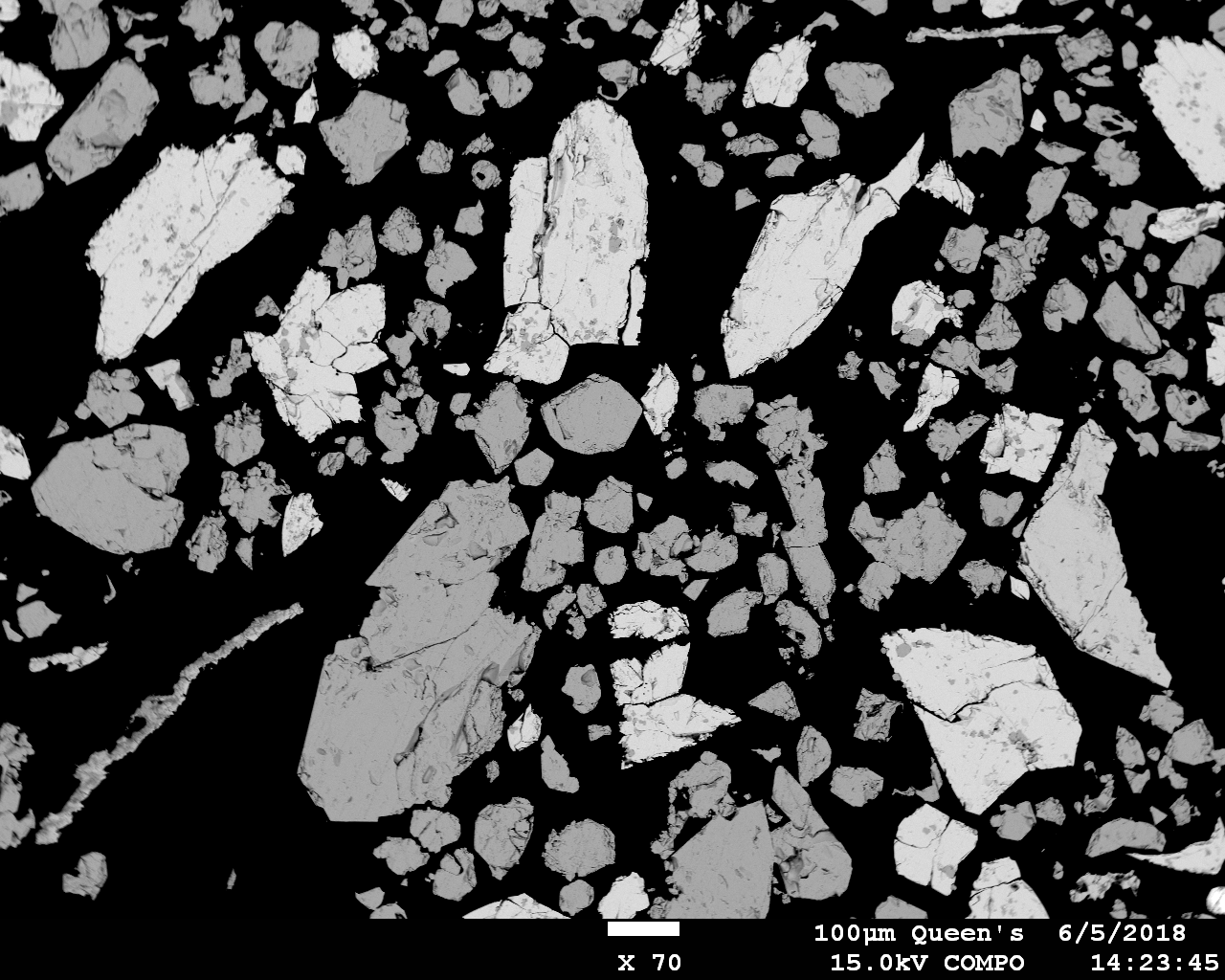

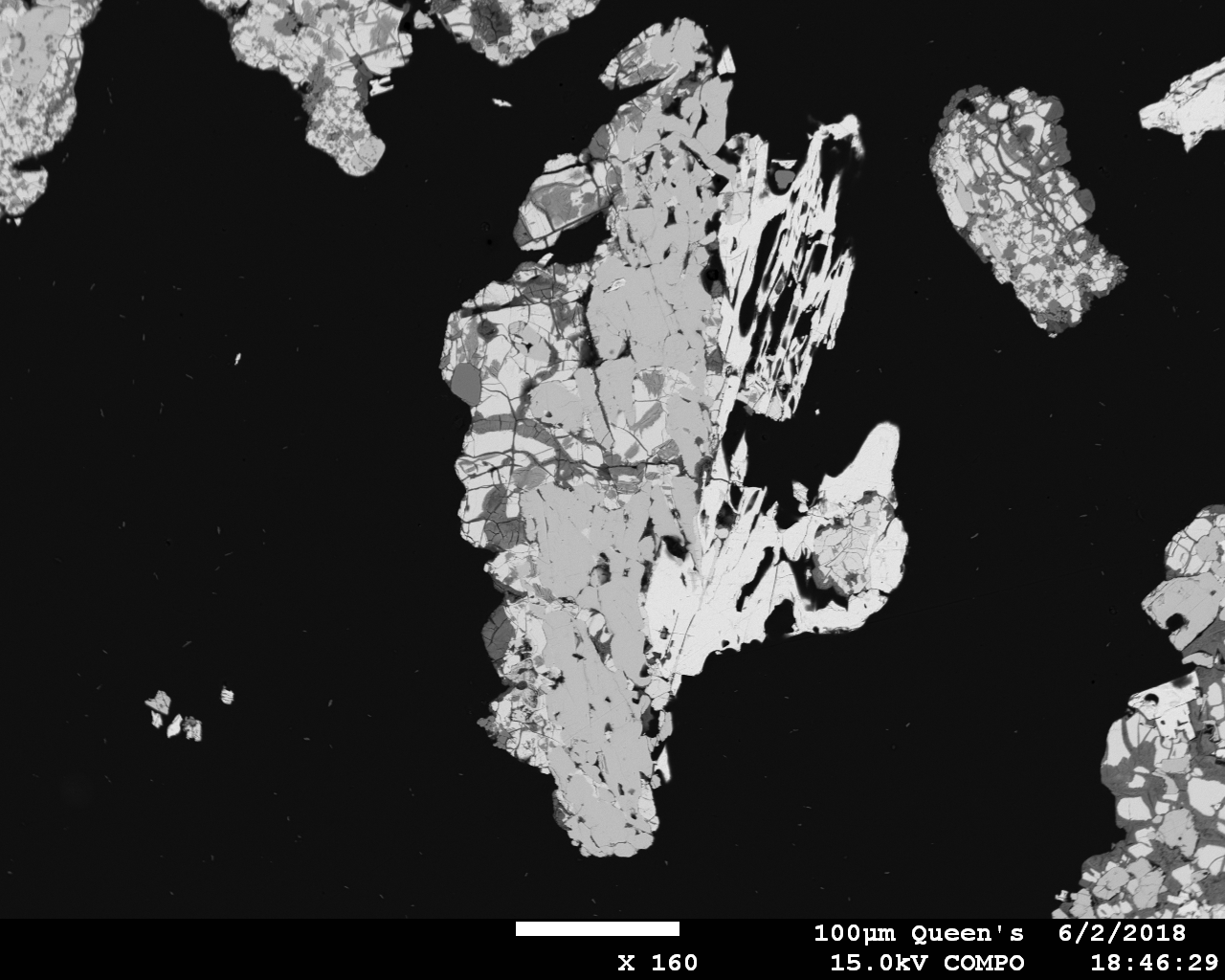

Here is a BSE image showing the likely CsCoPO4 (brightest) intergrown with another Cs-Co phosphate and a few other compounds:

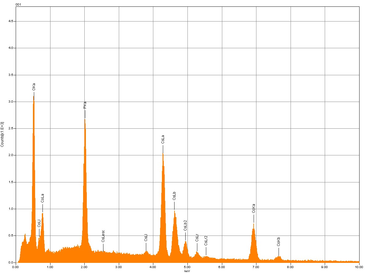

And here is a quickly-collected ED spectrum (beam energy = 15 keV) of the bright phase:
No obvious overlaps there!  If it can be produced as a pure phase, and is beam stable, it could be a good candidate standard for Cs.

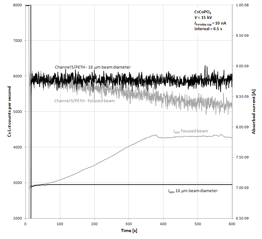

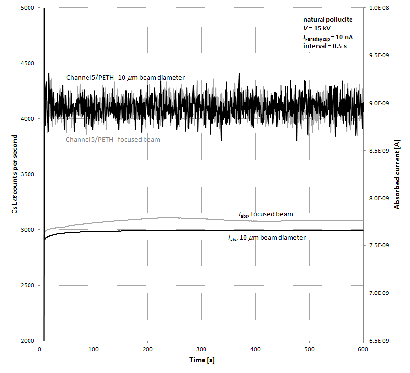

I've done some testing of the stability of CsCoPO4 under the beam.  The results aren't exactly fantastic.  I'll let the plots below do most of the talking.  With accelerating potential = 15 kV and Faraday cup current = 10 nA, I used the JEOL chart recorder to record count rates over periods of ten minutes with the beam fully focused and then with the beam defocused to 10 microns.  The sampling interval was 0.5 s.  Below the plot for CsCoPO4, I show a corresponding plot for natural pollucite.
The CsCoPO4 could certainly be very useful, but the beam absolutely must be defocused to prevent migration of Cs.

I've managed to dig up 20 or 30 grams of CsCl; I still need to look for a source of Mn.  But how do I prevent the alumina crucible from participating in the reaction at 750°C?  When I ran a second CsCoPO4 synthesis at about 850°C for 35 hours, I mostly got Cs2Co2Al(PO4)3, which is the dominant phase in the BSE image below.  (It turns out to be more beam-sensitive than CsCoPO4.)  Even the CsCoPO4, which is the brightest phase in the image, contains about 0.5 wt% Al2O3.  Like I noted in another post, I've also had problems with Pt reacting with Cs phosphate.

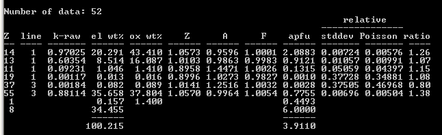

Using natural sanbornite (BaSi2O5, Si), natural celsian (Al), natural albite (Na), natural adularia (K), RbTiOPO4 (Rb), and Cs2Co2Al(PO4)3 as standards and assuming 1.4 wt% H2O, I get the following results:
PAP/MAC30:
The usual constraints on the pollucite-analcime solid solution for the six-oxygen formula unit (excluding H2O) are as follows (see Beger, Z. Kristallogr. 129:280-302; Černý, Can. Min. 12:334-341):
nSi + nAl = 3
nCs + nH2O = 1
sum large cations = nAl
For this case (average of 52 analyses),
nSi + nAl = 3.000
nCs + nH2O = 1.000 (obviously I had to choose a value of H2O)
sum large cations = 0.911, nAl = 0.912

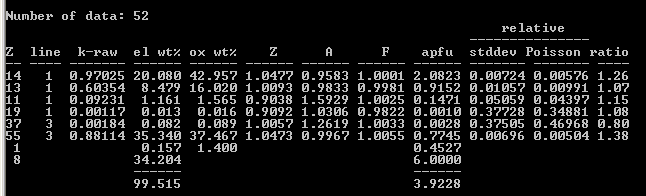

Of course I can't prove that the result is accurate, but it sure looks pretty reasonable.  Also, note that the matrix correction factors for Cs Lα are close to unity, and so the choice of matrix correction model doesn't have much effect on wt% Cs2O.  The Armstrong model gives slightly lower wt% Cs2O due to the smaller atomic number correction.
Armstrong/FFAST:
