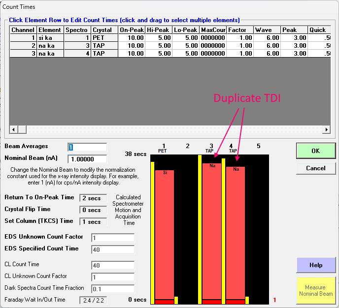

I had to check the code and make a simulated test run to see what the case is and I don't think you are quite correct about the TDI display. For example, I made this sample:
Then when I acquired the data, I got these net intensities:

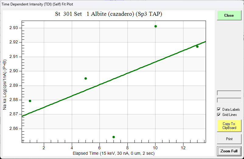

So 18 cps/nA for each Na spectrometer. Next I plotted the TDI intensities for spec3:
and you can see the natural log of 18 is ~2.9. Same for spec4:

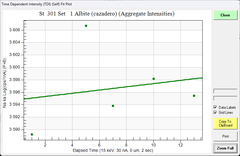

But if I turn on the "aggregate" intensity feature in the Analysis Option window:
Now the output in the log window is 36 cps/nA for the first Na spectrometer since it is aggregated:

And the TDI plot shows this:

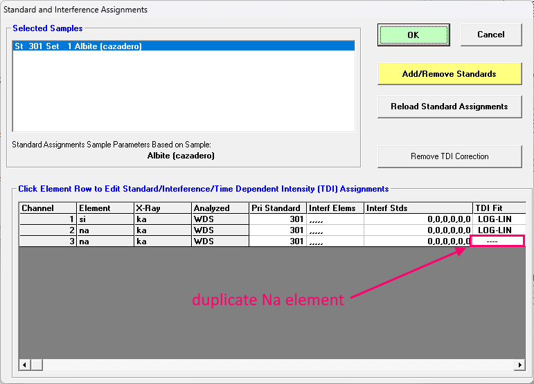

Note that the plot title no longer states the spectrometer number, but says "Aggregate Intensities". And the natural log of 36 is ~3.6.

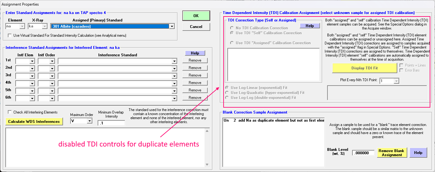

We had previously tried to alert the user to this by not displaying the TDI fit type in the Standard Assignments dialog as seen here:
but it's a little confusing because in the past one could click on the duplicate element (to assign standards and interferences, etc.), but one could still display the TDI intensities.  However, because the code aggregates only from the current element to subsequent duplicate elements, you would only see the intensities from the 2nd Na channel even if the aggregate option is elected.
So in the latest version of the code, we've disabled the TDI controls for duplicate elements, if the aggregate option is selected. Here's the Standard Assignments dialog for Na on spec 4 (duplicate) and aggregate mode selected in Analysis Options:

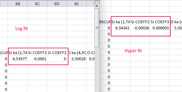

Sorry if this is a dumb question (I'm new to using this software), but I was wondering how to export data so it has a quadratic TDI?
I've been able to successfully export versions of my data with no TDI correction and linear TDI correction (on elements that can be TDI corrected) using Analyze! -> Standard Assignments -> selecting the type of fit I want for the elements I want a TDI correction for using 'Use TDI "Self" Calibration Correction', and then going to Analytical -> Analysis Options -> and using 'Use Assigned or Self Time Dependent Intensity (TDI) Corrections on Unknowns.'
However, when I go through the same process and set the TDI element fit type for F and Cl to log-quadratic (hyper-exponential) in the Analyze! -> Standard Assignments window, none of the points I've tested this on end up exporting with having a quadratic TDI correction. I've also tried doing Run -> 'Display Time Dependent (TDI) and Alternating (on/off) Intensities' and manually setting specific elements for specific data points to have a quadratic TDI (by checking 'Quadratic' and then selecting 'Assign Fit to Sample'). Neither of these methods seemed to have worked--it seems to export my data as either as having no TDI or a linear one, based off of comparisons to my other data sets.
Is there some easy way to just set everything that can have a quadratic TDI applied to it to export that way that I'm missing?

What exactly do you mean by "successfully export versions of my data"?
Do you mean exporting the TDI fits to an external file using the Output menu?   Or do you mean just specifying different fits to the TDI data within PFE?
bek425
Sorry for not specifying. I meant the first one (exporting the TDI fits to an external file using the Output menu), specifically as DAT and Excel files.
#79
Quote from: bek425 on January 02, 2026, 05:58:52 PMSorry for not specifying. I meant the first one (exporting the TDI fits to an external file using the Output menu), specifically as DAT and Excel files.
That's odd.  Are your quantitative results different as reported in the log window for the different TDI fits?
When I assign different TDI fits to the sample, either from the Standard Assignments dialog or the Run | Save Time Independent (TDI) or Alternating (on/off) Intensities menu, when exporting using the Output | Save Time Dependent Intensities menu window, it exports different fit coefficients for the different assigned fits.
