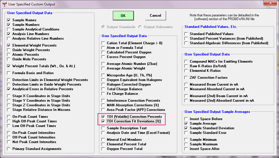

I used the user specified output and selected relative error.
Hi Ben,
I don't see relative error in that dialog.  Did you mean sample standard deviation and/or sample standard error?
BenH
"analytical errors in relative percents" in the user specified format output.

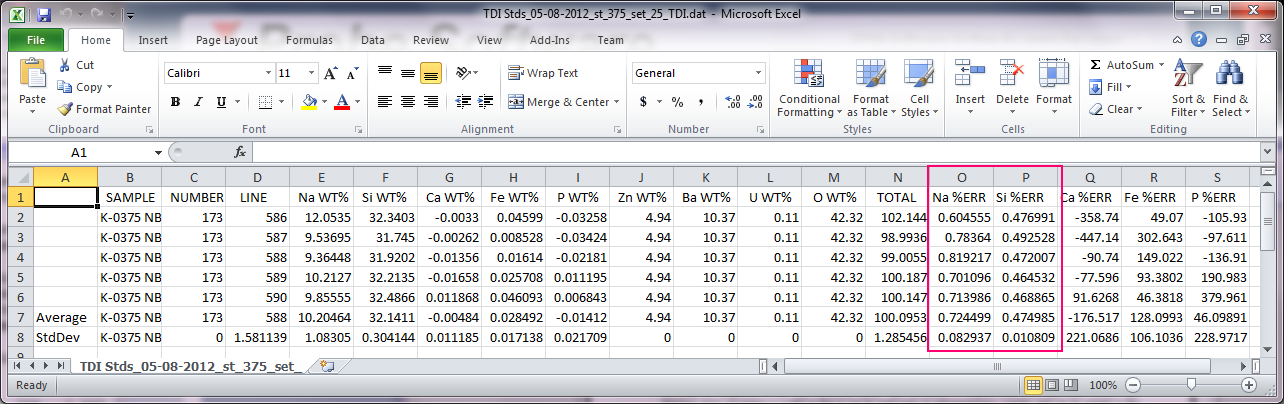

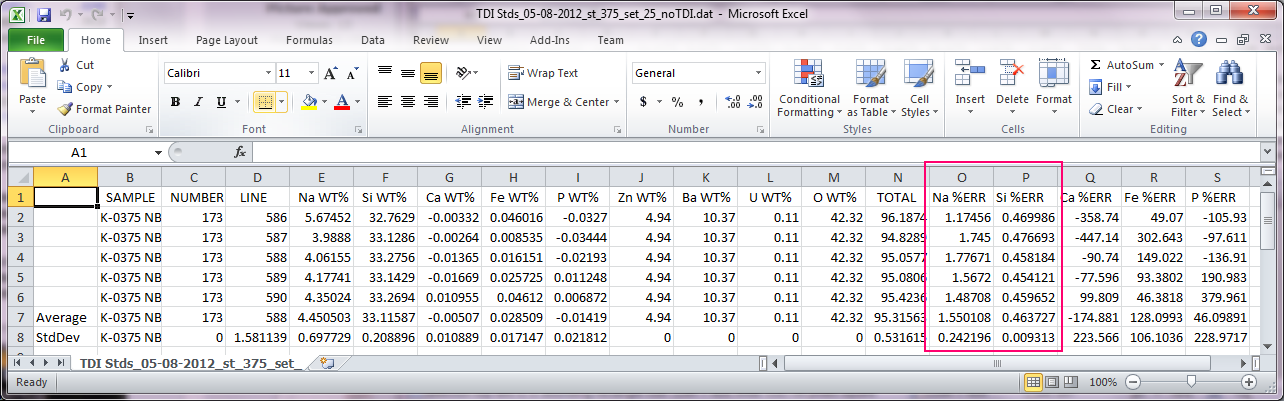

Now if I pick a (very) beam sensitive sample, specifically the NIST K-375 glass, and output the results *without* the TDI correction I get these results:
Note that the Na and Si average analytical sensitivity errors are 1.550108 and 0.463727 respectively. Now with the TDI correction turned on I get:
Now note that the average analytical sensitivity errors are now 0.724499 and 0.474985 respectively. They are smaller for Na because due to the slope of the TDI corrections, so the net intensity was increased and the analytical sensitivity improved, because the peak to bgd improved. And for Si, the net intensities were instead decreased, because of the different slope for the Si TDI corrections.  That is, due to the TDI corrections, the Na P/B increased (a lot), but the Si P/B decreased (slightly).

You asked about the TDI fit deviation and the answer is that the variance due to the regression scatter in the TDI plot is not applied in this calculation. There are however several different options for outputing the TDI correction magnitude and fit variance as seen here:
I would have to think if there is a way the TDI fit variance could be applied to the analytical sensitivity calculation, but in the meantime you might want to look at the output from the Output | Save Time Dependent Intensities menu. This output option saves a lot of parameters utilized in the TDI corrections to a tab delimited file.  I know several users have leveraged this information in their own TDI studies.

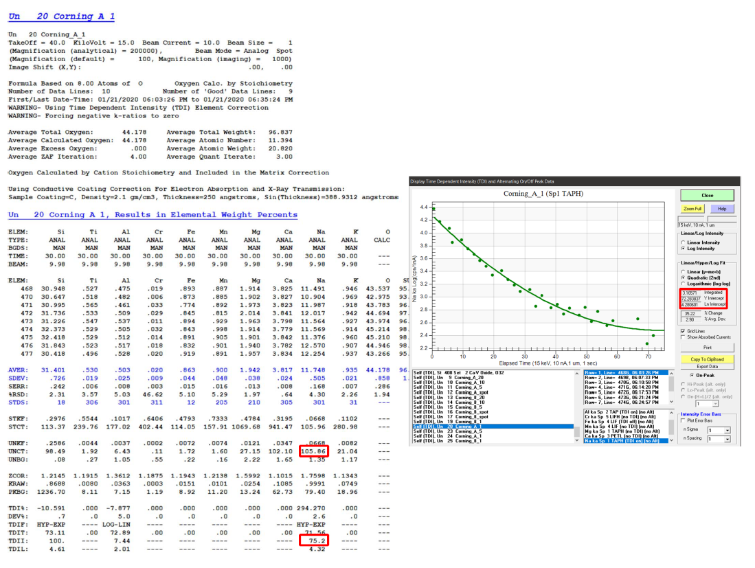

I've been measuring Na intensity loss from silicate glasses with self TDI correction. And I have one question how the final Na X-ray intensities were calculated.
"Note that the linear TDI correction utilizes only the slope of the TDI fit in log space. However the "hyperexponential" TDI correction utilizes the actual intercept of the 2nd order quadratic fit to the TDI data."
This is what I read from the User Reference Manual and I understood that extrapolated y-intercept at t=0 was finally used for matrix correction calculation when I use Quadratic (Hyper-Exponential) fitting. However, after I Analyze TDI corrected sample, I found out that X-ray counts of Na at "UNCT" row and "TDII" row are quite different.
Could you explain how the final intensity at "UNCT" row are calculated from the y-intercept intensity at "TDII" row??

Hi Hwayoung,
You are exactly correct!  I had not updated the reference manual after we modified the code a couple of years ago to handle using duplicate elements (aggregate feature) with the TDI correction.  Basically one can't average quadratic slopes!  So now the reference manual says:
Note that the linear TDI correction utilizes only the slope of the TDI fit in log space. However the "hyper-exponential" TDI correction utilizes a 2nd order quadratic fit to the TDI data. While the log-log (double exponential) fit utilizes only the slope fit term similar to the log-linear fit, but with a LOG(elapsed-time) term.

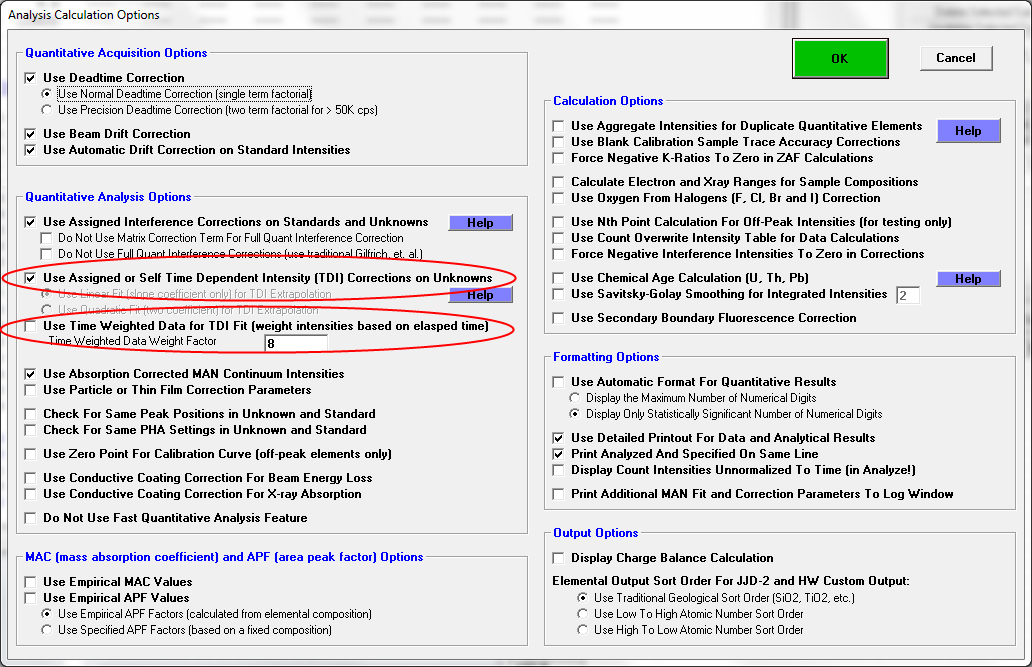

And yes you can weight the initial TDI points using the Analytical | Analysis Options menu dialog as seen here:
The full post discussing this TDI fit feature is here:
