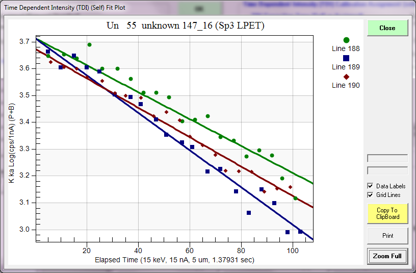

Here are the same data but with the "TDI weighting" feature applied as seen here:
So is it worth allowing more than a factor of 10 "weighting" to the initial TDI measured points?

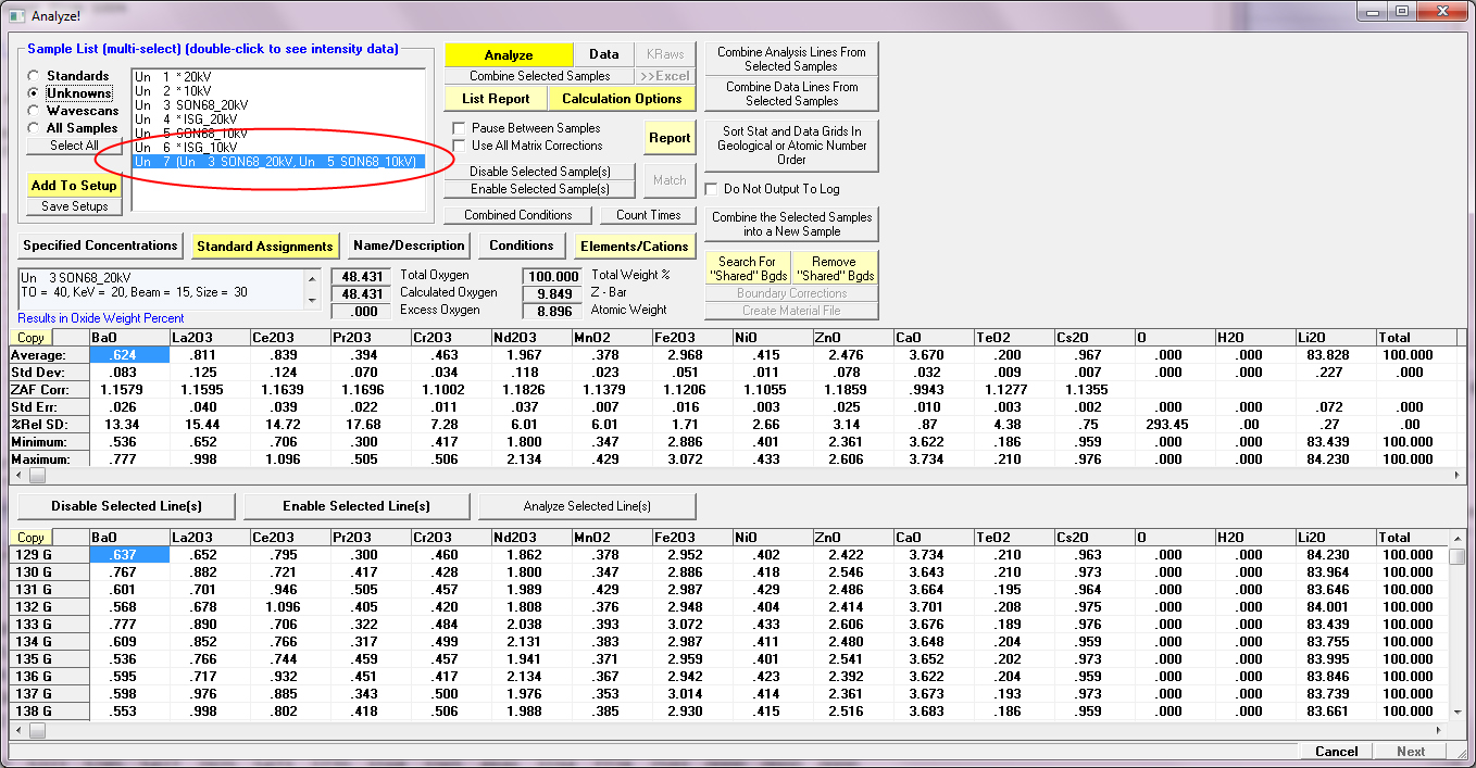

What you need to do to combine the normal intensity data and the TDI data is to select both samples and click the Combine the Selected Samples into a New Sample button as seen here:
When the samples are combined you will see a new sample which now has the TDI data from both selected samples referenced by the new sample
as seen here:
Now when you click the normal Analyze button for the newly created sample, the output will look like this:

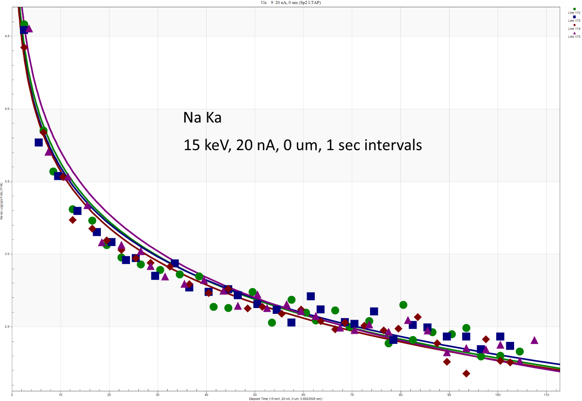

I recently discussed the new TDI scanning method on the NIST SRM K-1718 beam sensitive material here:
http://smf.probesoftware.com/index.php?topic=912.msg5904#msg5904
However, the point analyses of this material are also worth looking at. This material has the following composition as specified by NIST:
ELEM:       Na      Fe      Ca      Si       O   SUM
ELWT:   14.837  10.491   3.574  28.048  43.050 100.000
OXWT:   20.000  13.497   5.000  60.005   1.498 100.000
ATWT:   13.994   4.073   1.933  21.655  58.344 100.000

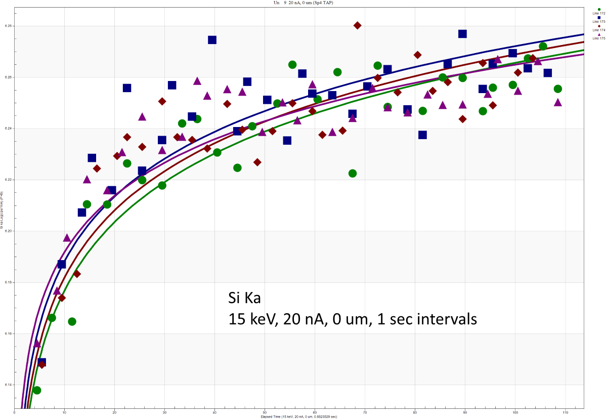

Here are TDI plots of log intensities for Na and Si, first with a 20 nA focused beam:
I had to utilize the double exponential fit to get even a halfway decent composition as seen here:
15 keV, 20 nA, 0 um, 1 sec intervals:
   172  14.331  11.200   4.035  29.551  43.476 102.593
   173  12.957  11.087   4.337  29.952  43.542 101.874
   174  12.794  11.243   3.993  29.676  43.079 100.785
   175  16.627  11.606   4.224  30.640  45.706 108.802
AVER:   14.177  11.284   4.147  29.955  43.951 103.513
SDEV:    1.773    .224    .161    .486   1.188   3.603
TDI%:  928.684  -6.004    .202 -13.391     ---
DEV%:      3.6      .6     1.0      .2     ---
The averages aren't all that bad considering the Na extrapolation is over 900% (!), and the Si extrapolation is over 13 % (negative).
And here again, but with a 20 nA, 20 um defocused beam:
Again, all plotted in log intensity space. I find it interesting that with a 20 um beam, the Na trend, instead of the normal exponential, hyper-exponential or double exponential trends, we instead see a "hypo-exponential" trend.  That is, a little less than a normal exponential... and here are the quant results:

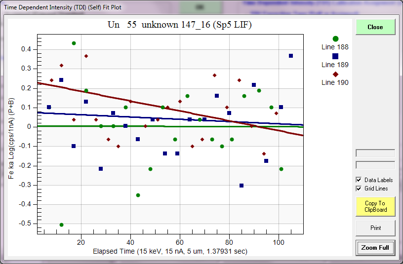

Since beam sensitive samples are being discussed in the Cs standard topic by Brian Joy and I just had a student run some very beam sensitive rhyolite glasses earlier this week, I thought we might revisit the the Time Dependent Intensity (TDI) correction feature since the student got some excellent results in a very hydrous alkali glass that entailed some very large corrections.
This was apparently a Bishop Tuff rhyolite pumice which they suspected from FTIR analysis would have around 5 wt% H2O. So we tuned up the instrument for 15 keV, 15 nA and used a 5 um beam (for the Mg, Ca, Cl, Ti and F traces we used a 50 nA beam). Normally we would use a more defocussed 10 um beam to keep the TDI correction a little more reasonable, but the glass bubble walls were very thin, and as they say "necessity is a mother".   :)
Here is the last sample she ran, and note the average correction percent and average variation percent (in red):
Un   55 unknown 147_16, Results in Elemental Weight Percents
ELEM:       Na      Si       K      Al      Fe      Mg      Ca      Cl      Ti       F       O       H       P      Mn       S
TYPE:     ANAL    ANAL    ANAL    ANAL    ANAL    ANAL    ANAL    ANAL    ANAL    ANAL    CALC    DIFF    SPEC    SPEC    SPEC
BGDS:      MAN     MAN     LIN     MAN     MAN     MAN     MAN     LIN     LIN     LIN
TIME:    40.00   40.00   40.00   40.00   40.00  165.00  150.00  120.00  120.00  120.00     ---     ---     ---     ---     ---
BEAM:    14.91   14.91   14.91   14.91   14.91   50.73   50.73   50.73   50.73   50.73     ---     ---     ---     ---     ---
ELEM:       Na      Si       K      Al      Fe      Mg      Ca      Cl      Ti       F       O       H       P      Mn       S   SUM
   188   3.108  34.107   3.788   6.193    .460    .018    .294    .096    .021    .041  51.273    .601    .000    .000    .000 100.000
   189   3.378  33.632   3.838   6.347    .486    .018    .290    .092    .026    .044  51.218    .631    .000    .000    .000 100.000
   190   3.415  33.822   3.634   6.267    .585    .017    .289    .085    .033    .061  51.185    .608    .000    .000    .000 100.000
AVER:    3.300  33.854   3.753   6.269    .510    .018    .291    .091    .027    .049  51.225    .614    .000    .000    .000 100.000
SDEV:     .168    .239    .106    .077    .066    .000    .003    .005    .006    .010    .045    .015    .000    .000    .000    .000
SERR:     .097    .138    .061    .045    .038    .000    .002    .003    .004    .006    .026    .009    .000    .000    .000
%RSD:     5.08     .71    2.83    1.23   12.94    2.16     .92    6.01   23.15   21.19     .09    2.52     .00     .00     .00
STDS:      336     162     374     336     162     162     162     285      22     835     ---     ---     ---     ---     ---
STKF:    .0735   .2018   .1132   .1332   .0950   .0568   .1027   .0602   .5547   .1715     ---     ---     ---     ---     ---
STCT:    64.51  244.54  138.78  220.67   20.49   70.15  188.59   61.70   42.06   23.55     ---     ---     ---     ---     ---
UNKF:    .0179   .2768   .0324   .0488   .0042   .0001   .0026   .0007   .0002   .0001     ---     ---     ---     ---     ---
UNCT:    15.72  335.41   39.70   80.80     .91     .15    4.75     .74     .02     .02     ---     ---     ---     ---     ---
UNBG:      .33     .31     .94     .85     .20     .48     .93     .33     .05     .05     ---     ---     ---     ---     ---
ZCOR:   1.8421  1.2230  1.1593  1.2854  1.2090  1.4697  1.1257  1.2548  1.2064  4.1458     ---     ---     ---     ---     ---
KRAW:    .2437  1.3716   .2860   .3662   .0444   .0021   .0252   .0120   .0004   .0007     ---     ---     ---     ---     ---
PKBG:    48.89 1068.36   43.46   96.38    5.47    1.31    6.13    3.26    1.38    1.35     ---     ---     ---     ---     ---
INT%:     ----    ----    ----    ----    ----    ----    ----    ----    ----    -.86     ---     ---     ---     ---     ---
TDI%:  282.195  -2.408  35.459  -2.496   5.719    ----    ----    ----    ----    ----     ---     ---     ---     ---     ---
DEV%:      5.4      .2      .9      .4  1895.2    ----    ----    ----    ----    ----     ---     ---     ---     ---     ---
TDIF:  HYP-EXP LOG-LIN LOG-LIN LOG-LIN LOG-LIN    ----    ----    ----    ----    ----     ---     ---     ---     ---     ---
TDIT:   101.33  102.00  103.67  104.67  104.33    ----    ----    ----    ----    ----     ---     ---     ---     ---     ---
TDII:     12.3    335.    40.5    81.5    1.11    ----    ----    ----    ----    ----     ---     ---     ---     ---     ---
TDIL:     2.51    5.81    3.70    4.40    .106    ----    ----    ----    ----    ----     ---     ---     ---     ---     ---
Un   55 unknown 147_16, Results in Oxide Weight Percents
ELEM:     Na2O    SiO2     K2O   Al2O3     FeO     MgO     CaO      Cl    TiO2       F       O     H2O    P2O5     MnO     SO3   SUM
   188   4.189  72.966   4.563  11.702    .592    .030    .412    .096    .035    .041    .000   5.375    .000    .000    .000 100.000
   189   4.554  71.952   4.623  11.993    .625    .029    .406    .092    .043    .044    .000   5.639    .000    .000    .000 100.000
   190   4.603  72.357   4.377  11.841    .752    .029    .404    .085    .056    .061    .000   5.436    .000    .000    .000 100.000
AVER:    4.449  72.425   4.521  11.845    .656    .029    .407    .091    .044    .049    .000   5.483    .000    .000    .000 100.000
SDEV:     .226    .511    .128    .146    .085    .001    .004    .005    .010    .010    .000    .138    .000    .000    .000    .000
SERR:     .131    .295    .074    .084    .049    .000    .002    .003    .006    .006    .000    .080    .000    .000    .000
%RSD:     5.08     .71    2.83    1.23   12.94    2.16     .92    6.01   23.15   21.19     .00    2.52     .00     .00     .00
Note that the H2O by difference is close to 5% which was very nice to see. However, that is in spite of the Na TDI correction is almost 300%, which means that we lost 2/3 of our intensity during the count integration!  The TDI plot for Na looks like this:

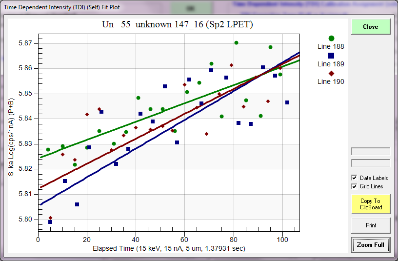

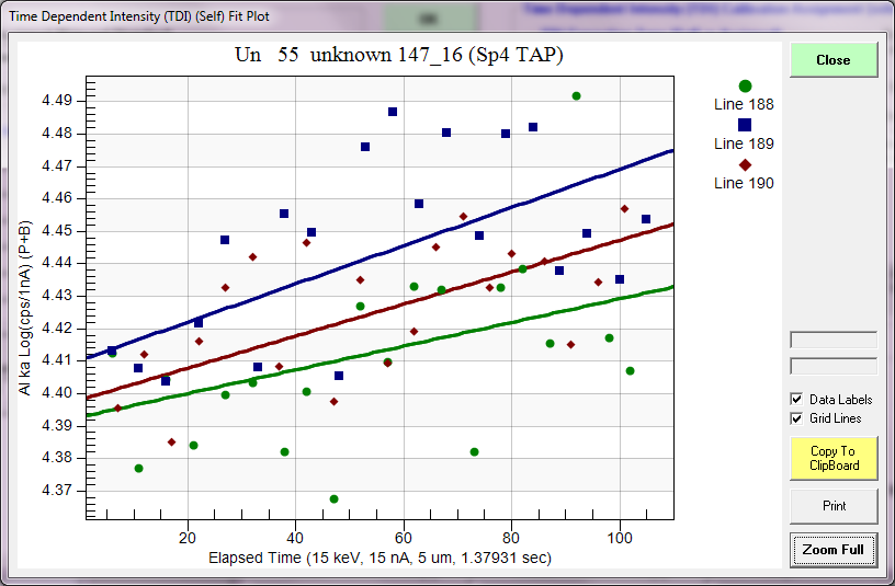

and this for Si and Al:
and both are statistically significant corrections if you will compare the TDI%: and DEV%: values for Si and Al.  However, for an element such as Fe, there is no TDI effect, as seen in both the TDI%: and DEV%: values and also from the plot here:
So if you are analyzing hydrous alkali glasses (even with a defocused beam) I hope you are turning on the TDI correction feature!
AndrewLocock
Hello,
We run a lot of hydrous rhyolitic glass, and this has encouraged me to look at zeolites in more detail.
However, I noticed that the time-scale for the self-TDI is a bit funny.
Our initial setup is 20 s on peak, with 5 TDI intervals, so the spacing should be every 4 seconds (right?).
A JPG of the screen capture of the TDI data is attached.
The text from the associated DAT file follows:
"Elapsed Time (10 keV, 10 nA,5 um, 4 sec)"   "Na ka Intensity (cps/1nA)"
3.00000    118.593
10.0000    113.562
16.0000    114.460
23.0000    107.661
30.0000    102.197
It is not clear to me why the intervals are not an even 4 seconds apart....
Thanks,
