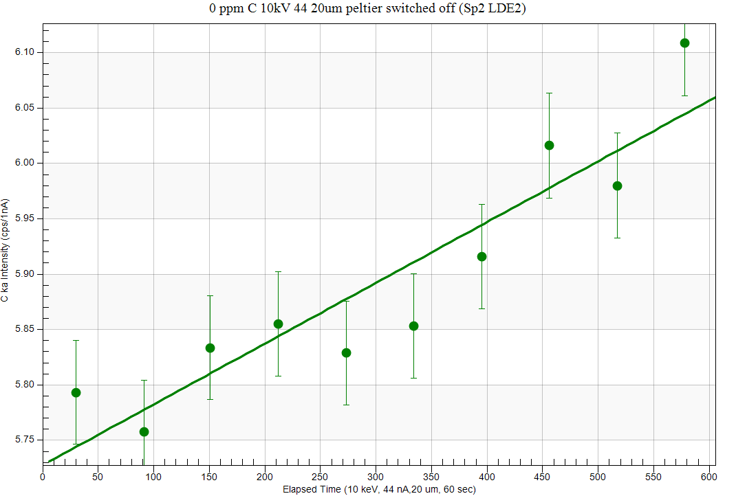

Sorry I should have made myself clear, I mean the error bars as shown on the figure below
#36
Oh right.  Doing that will disturb the format for those already depending on the existing output, so I can do that but I hope no one minds...

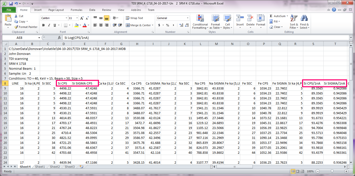

I was able to add output of the TDI intensity one sigma error values from the Output menu as seen here:
Let me know if this works for you.
